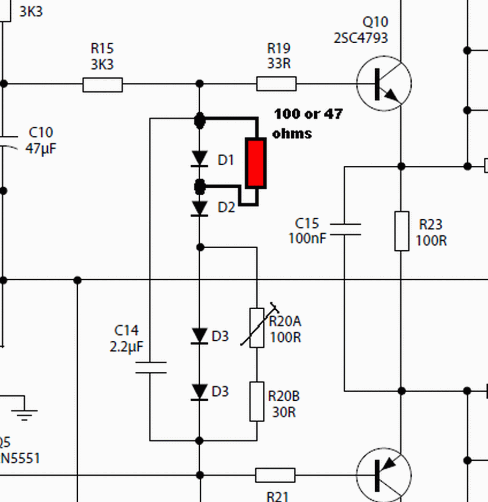

how are you uncle carlos
i check again the circuit and i found that its my protective resistance as the culprit of droping the voltage in negative rail. it change value from 10 ohms to 150k. i use only 1 watt resistor so that it will easily become hot when some abnormal in the circuit happens.
i power up the circuit without its output transistors because my objective is only to find the cause of dropping the negative rail.
i measure about 400 mv in positive rail and 350mv in negative rail. i measure about 600mv in every transistors(Base to emitter), 2.4v from point A to Point B in bootstrap. But the NPN driver transistor is warm while the PNP is cold(no change in temperature).
No more time in installing the output transistors(time to go home). i will try it tommorrow.
Before if i assemble an amplifier circuit my technique in checking if the circuit is ok is to measure the Collector to Base and Collector to Emitter of the output transistors, they must have a .6 volts defference. Then i will measure if there is dc voltage in output and last i will measure the ac in output while touching the input with my finger. if everything is ok thats the time i connect the speaker.
But now i learned a lot with your techinique(protective resistnce), its more safe for the output transistor. Thank you.

uncle carlos i install the output transistors today, my dc offset is adjusted to 1mv, no ac voltage measured at output. my analog multi meter(setted at ac voltage 10 volts) will move as i touch my finger at input. voltage from point A to point B in four diodes is 2.3 volts. I connected the speaker and the audio source but the audio is so low, the output transistors will become hot until you cant touch it, i must off the power for surely they will be damaged very soon.
i have four pairs in output transistors with emmiter resistor of .33 ohms each( thats what i have in my shop). my driver transistors are A1941 and C5198( i think they are not complimentary), the transistors that needs separate heatsink is TIP41.
My input transistors are A992 and C9014( they are not complimentary)
my input transistor(A992) base to emmiter voltage is 500mv , is this ok?
all voltages seems to be normal but audio is low, seems like only 30 watts.
what could be the problem?

I was thinking about you Masterinvi
2.3 volts measured using analog multimeter can have enormous errors, you can have, for instance 2.5 volts, and this means more than 8 watts of power wasted in each one of your power resistances, excess of current is possible there, and having many transistors you will have something alike an enormous soldering iron overheating your heatsinks, off course they will not survive for too long.
First you have to find a digital multimeter and abandon your analogic one to produce these adjustments, with a digital multimeter, 200 milivolts DC scale, check voltage directly over each one of your emitter resistance, and adjust in a such way you will have less than 1 milivolts into each one of them, yes, they can be sligthly different, as each transistor can have different gain.
just be sure your multimeter is reading something, not overflow, you need just to be sure each transistor is conducting, and when they conduct you will have milivolts developed above the power emitter resistances (power equalizing resistances).
500 milivolts using analogic multimeter says nothing for us, this can be 520 milivolts, and this is good, but can be 480 milivolts and this is bad... you should, immediatelly, buy or borrow a digital multimeter or measure these DC points using a calibrated Oscilloscope.
These first transistors, normal voltage i have measured today is 575 milivolts each one of them.
I think you have removed the protective resistances, they are there only to adjustments, you must remove them to use your amplifier, they must be substituted by fuses, also use a fuse in the output line too.
Speaker must be strong, if you have one fuse burned, then you gonna have rail voltage at your output, rail voltage over a speaker may burn it...sometimes fuses fails, so, the speaker must be strong to face high power for some seconds (50 seconds) to give the operator time to flip the power switch off.
If you have an electronic protection, relay protection, then use it, this range of power is very dangerous, as you are using high voltage supply, this means troubles if something wrong happens with your amplifier.
Give a kiss in your beloved analogic multimeter, but please, keep it out of this adjustment, they are not something we can trust, have no precision in the reading.
Correctly adjusted, the stand by current, the bias trimpot, them your power transistors, without signal will face less than 100 miliwatts each one of them, this means amplifier dead cold...
Remove speaker and measure resistance from the power amplifier output to the ground, you may have some ohms there and this is not correct, this would be another explanation about the low power or the overheating, as another load in parallel will suck enormous energy from the power amplifier.
Your Zobel filter resistance is 4.7 ohms, but if correctly assembled it is in series with a capacitor...well, if this capacitor is shorted because have faced excess of voltage swing, then you will have 4.7 ohms load to ground.... check this.

I see you cannot reduce the bias 2.3V with your trimpot in the minimum resistance
position, them try to install 100 ohms resistance in parallel with one of your diodes, only one of them, if not good enougth to reduce a little this 2.3 to 2.15, them decrease this resistance to 47 ohms, or install another in parallel with the previous one.
Reduce the gain resistance, as you want more gain, try 470 ohms or even lower resistance, then you sensitivity problem will be solved.

i can reduce but only to 2 volts, if i will increase it will be only up to 2.3 volts can not reach 3 volts
