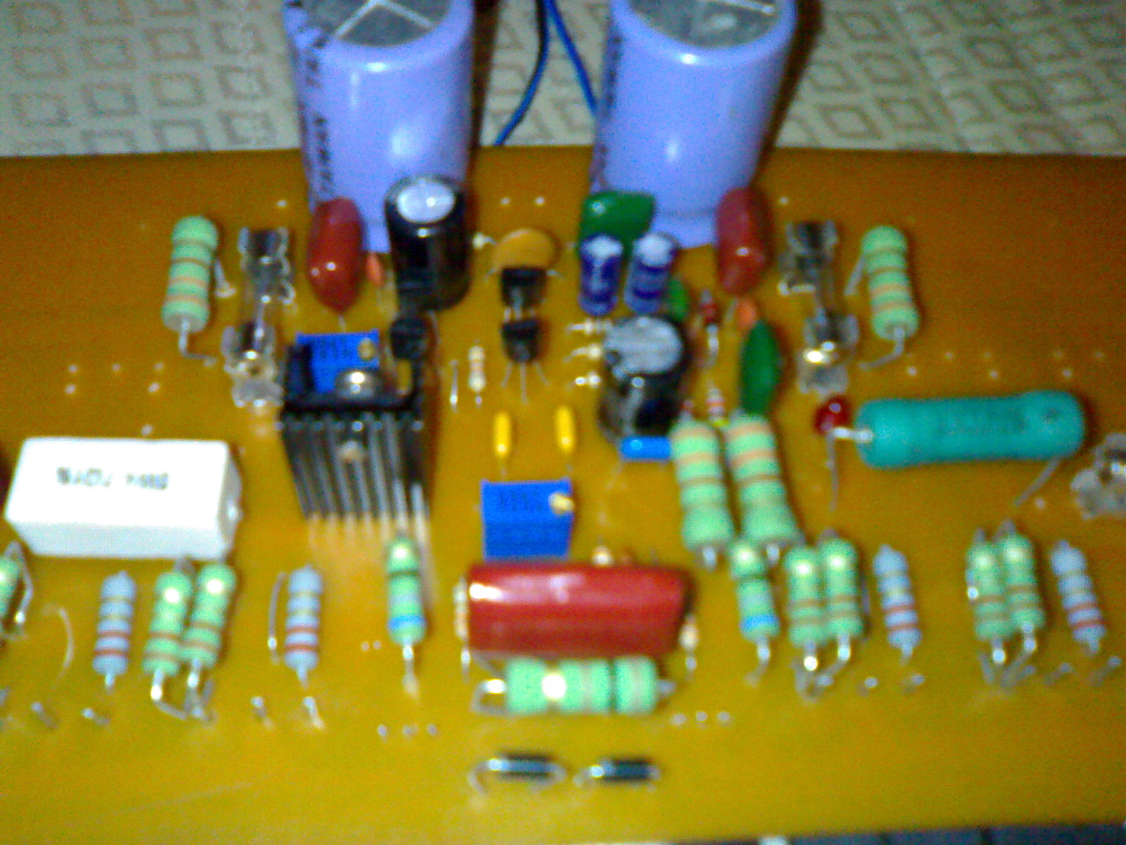

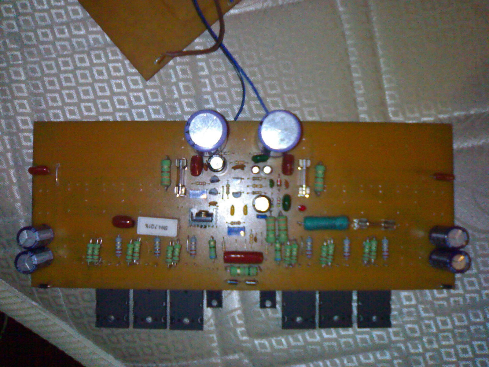

This is my Amp

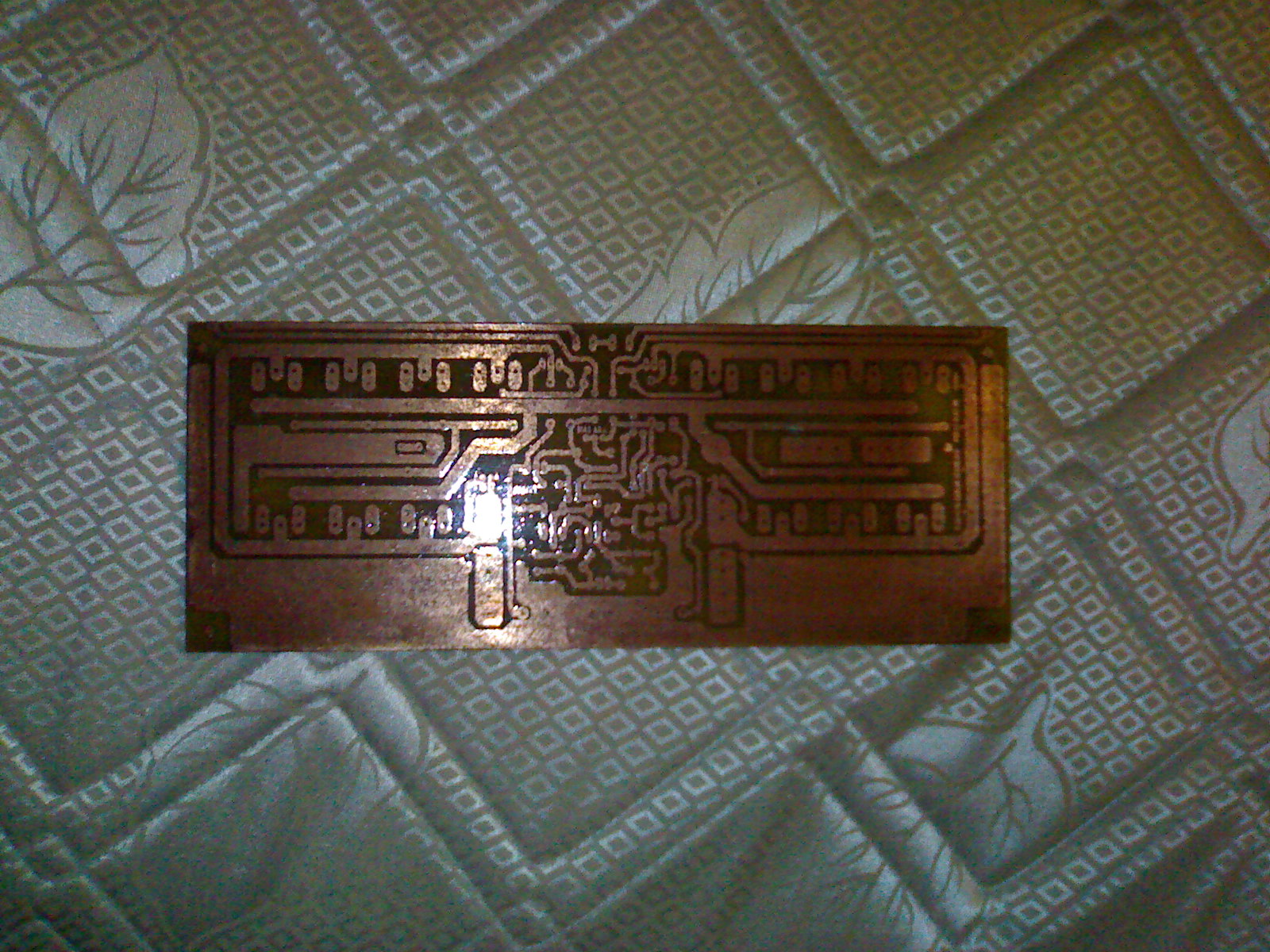

I checked many times with this board... I couldnt find any any faults in placing components. But im not satisfied with the board which i created myself.
When I give +30/-30 supply it will drive woofer very slowly and can here sound inside my room. drivers are getting hot slowly (without heat sink) but not power transistors.
planning to my a new transformer to supply required voltage and check.. at this moment im broke 😀

we can exclude output offset as the problem.
Similarly LF output is also low.
we need to look at Vbe across all the output devices right back to VAS stage.
Take care, shorting any two pins of a transistor is very likely to blow up many/some of the active devices.
hooooooooreeeeeeeeeeey...
Thanks for the guide Andrew.. finally I found the fault it was the output resister ..LOL
It works fine now and i cant increase the volume now caz its midnight.. I think my neighbor has a gun 😀 wish looks like this amp is a power hunger.. i feel sorry about my speakers.. we'll see tomorrow..

I fixed that too.. It sounds so loud now but im not satisfied with the bass level.. which i normally hear more bass 😉 i believe its because of my input signal.. anyways I can hear a clear punch.. no distortions.. I love that..
Apart from that.. one side of the amp is getting hotter than the other side.. I think its because I didnt adjust the bias.. isnt it?
It drives my woofer fully with +/-30. and I can imagine what if I give +/- 85 or more 😀 and It divers only with 3 pairs of transistors still 😎 A very good design.. highly customizable .. hehehehe..

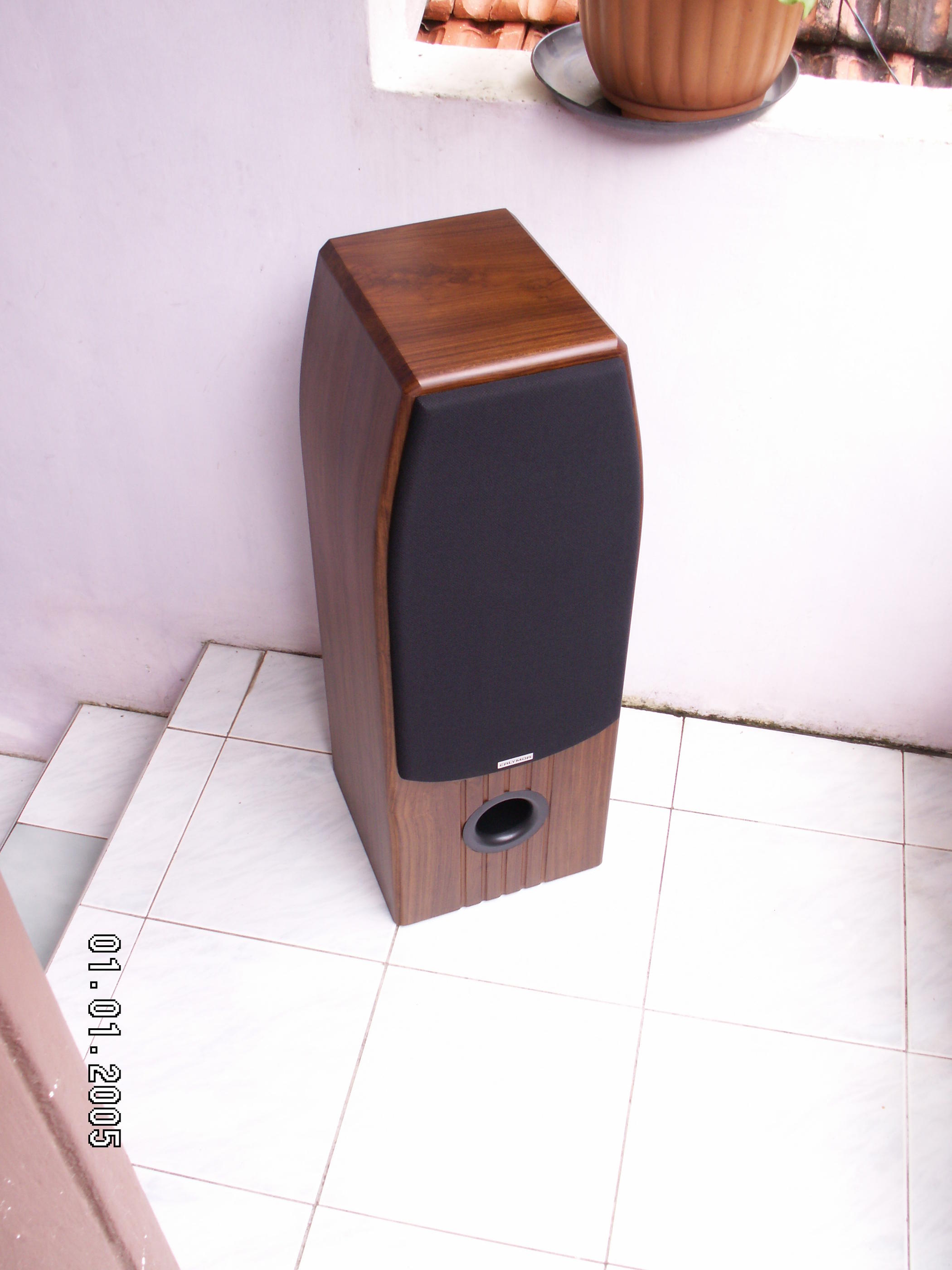

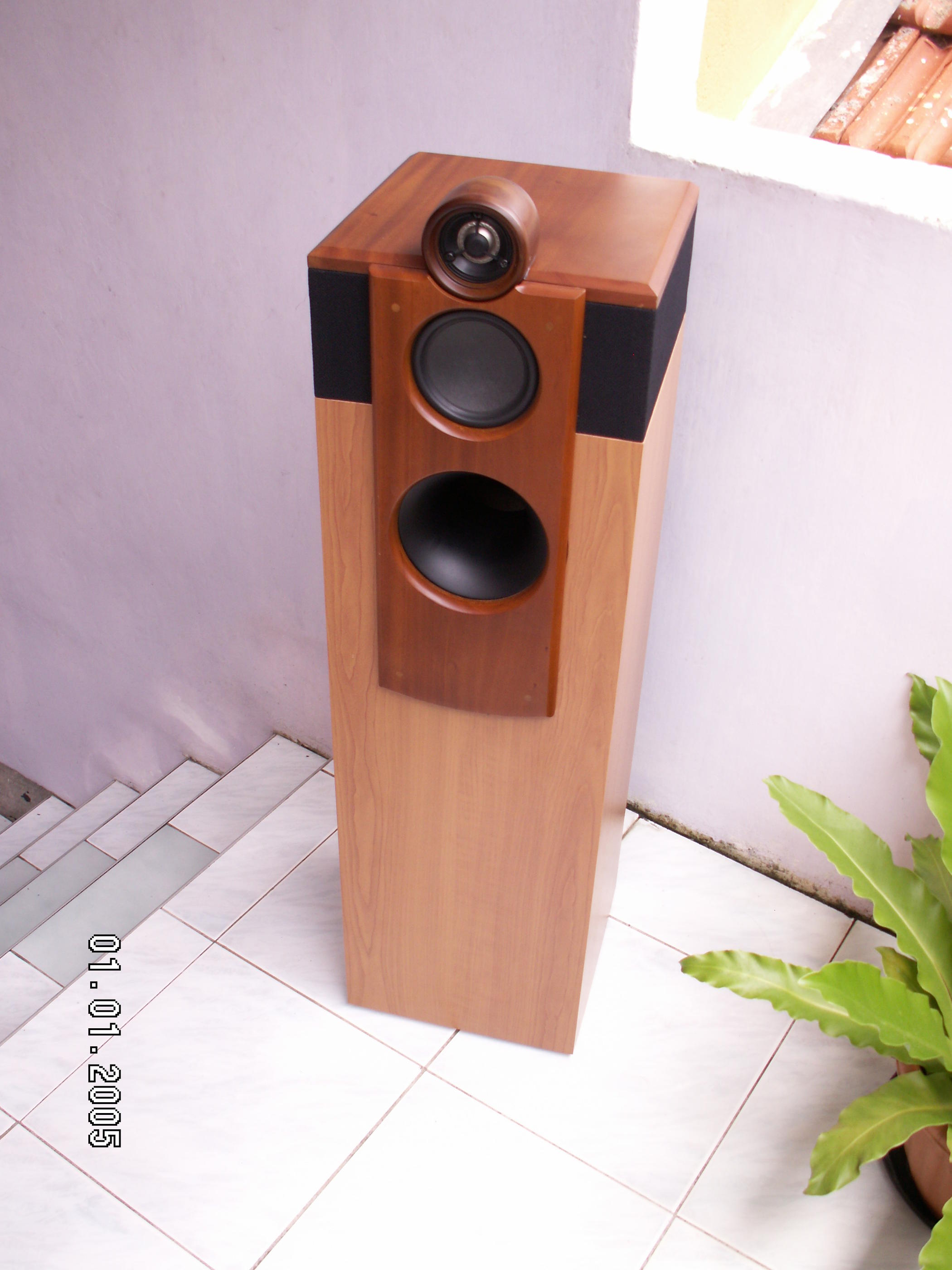

Here some pics of what we make here.. all are handcrafted products...

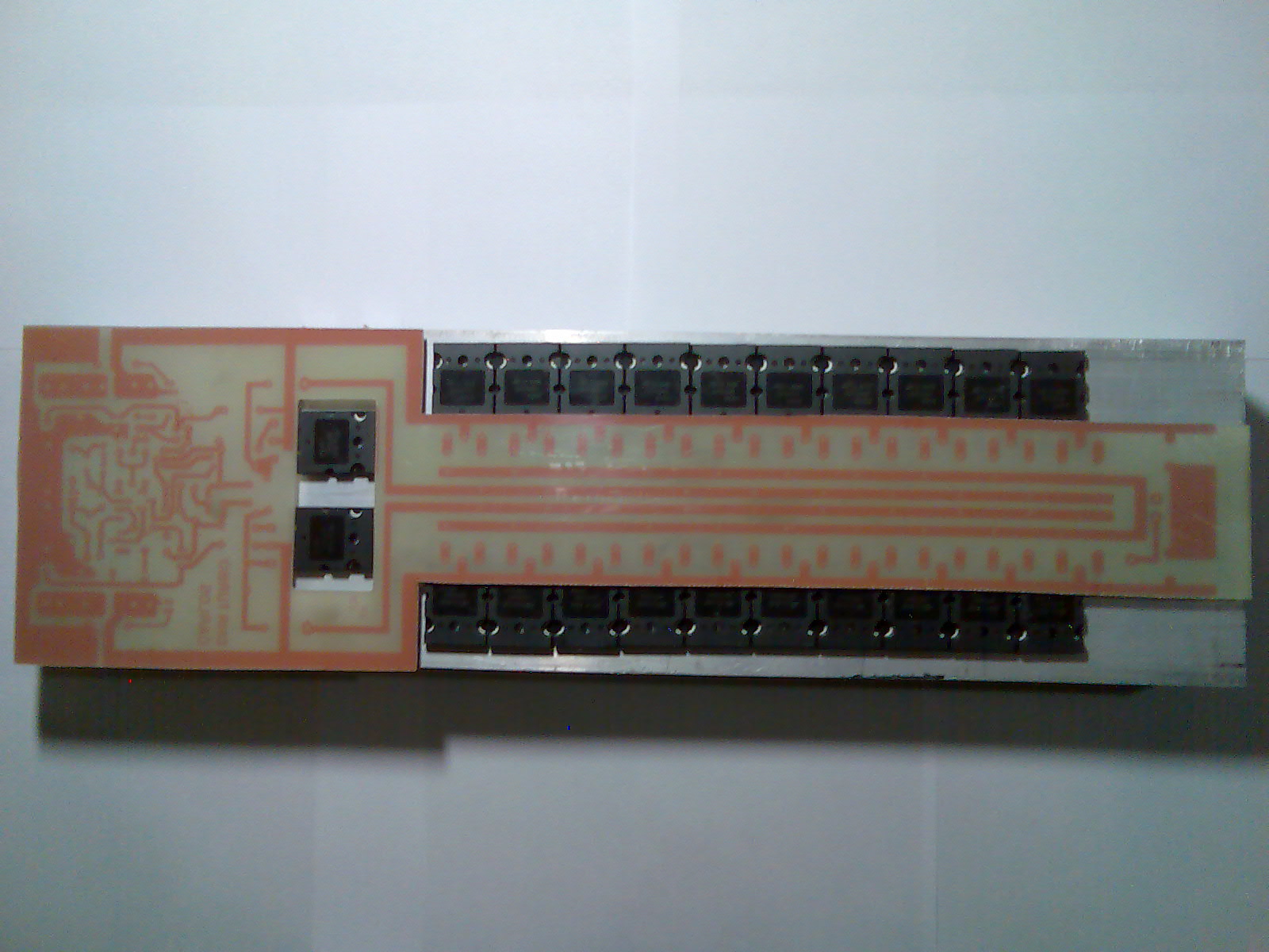

dhr turbo 10 pairs in output
dear sir
greetings what is the best method to bias dhr turbo .Trying to make
one stereo.for the choir some pics included will keep you posted.
thanking you
andrew lebon
The best method is to adjust the bias trimpot to read 1 milivolt DC
into all emitter resistances.... read over the resistance....say..the DC milivoltimeter goes touching each resistance extreme leads, one resistance each time..be sure all them are conducting a very small current.
The current to each transistor will be the reading expressed in volts, or 0.001V divided by the resistance value...let's say you use 1 ohm.
The the result is 1 miliampere to each transistor.
This may be different from transistor to transistor..one can have more or less, and this is normal, but be sure all them will have reading, this ensure that all transistors are conducting.
Nice and by power amplifier you are building.... inform your supply voltage and current...also your speaker impedance.
regards,
Carlos

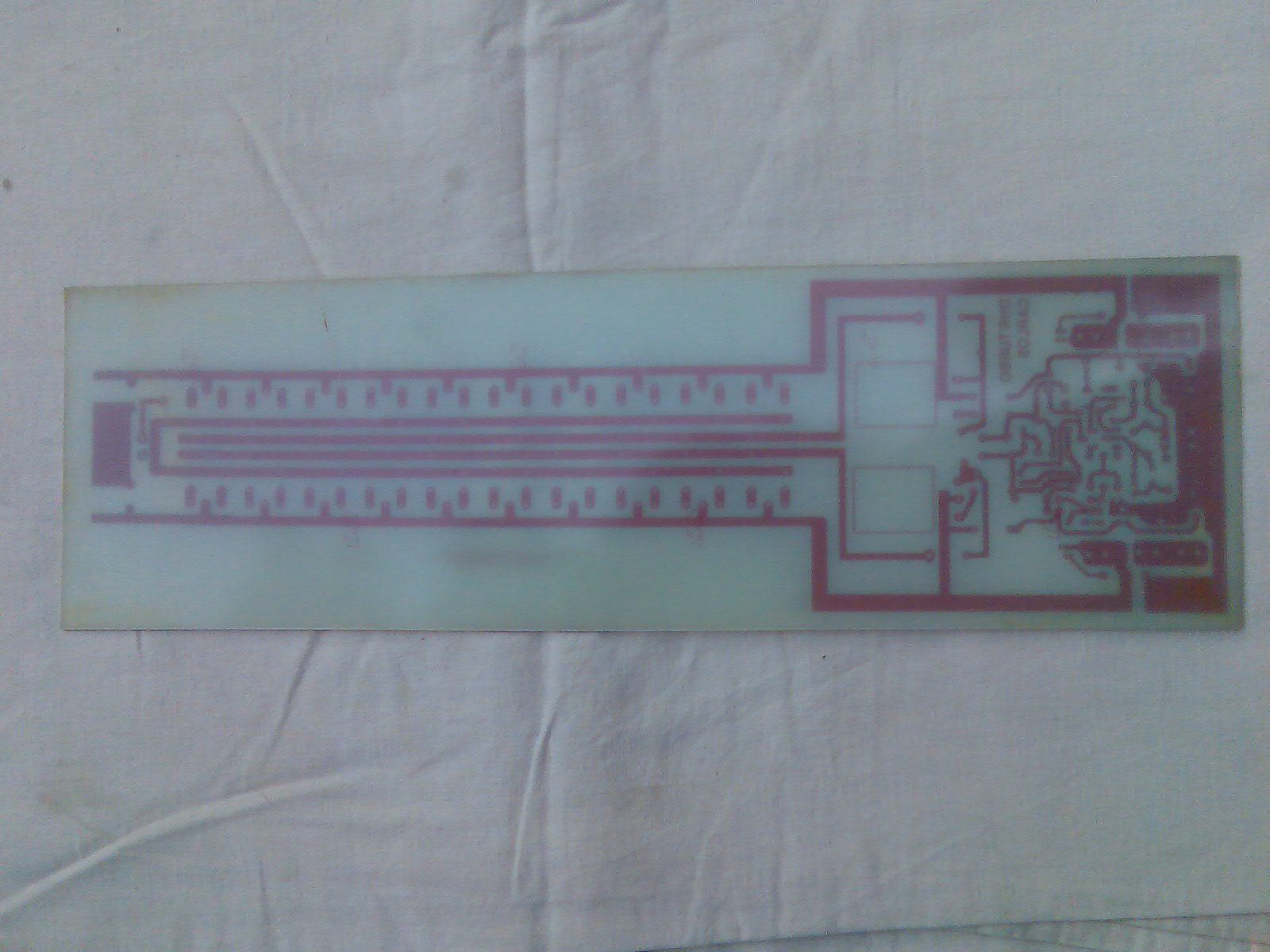

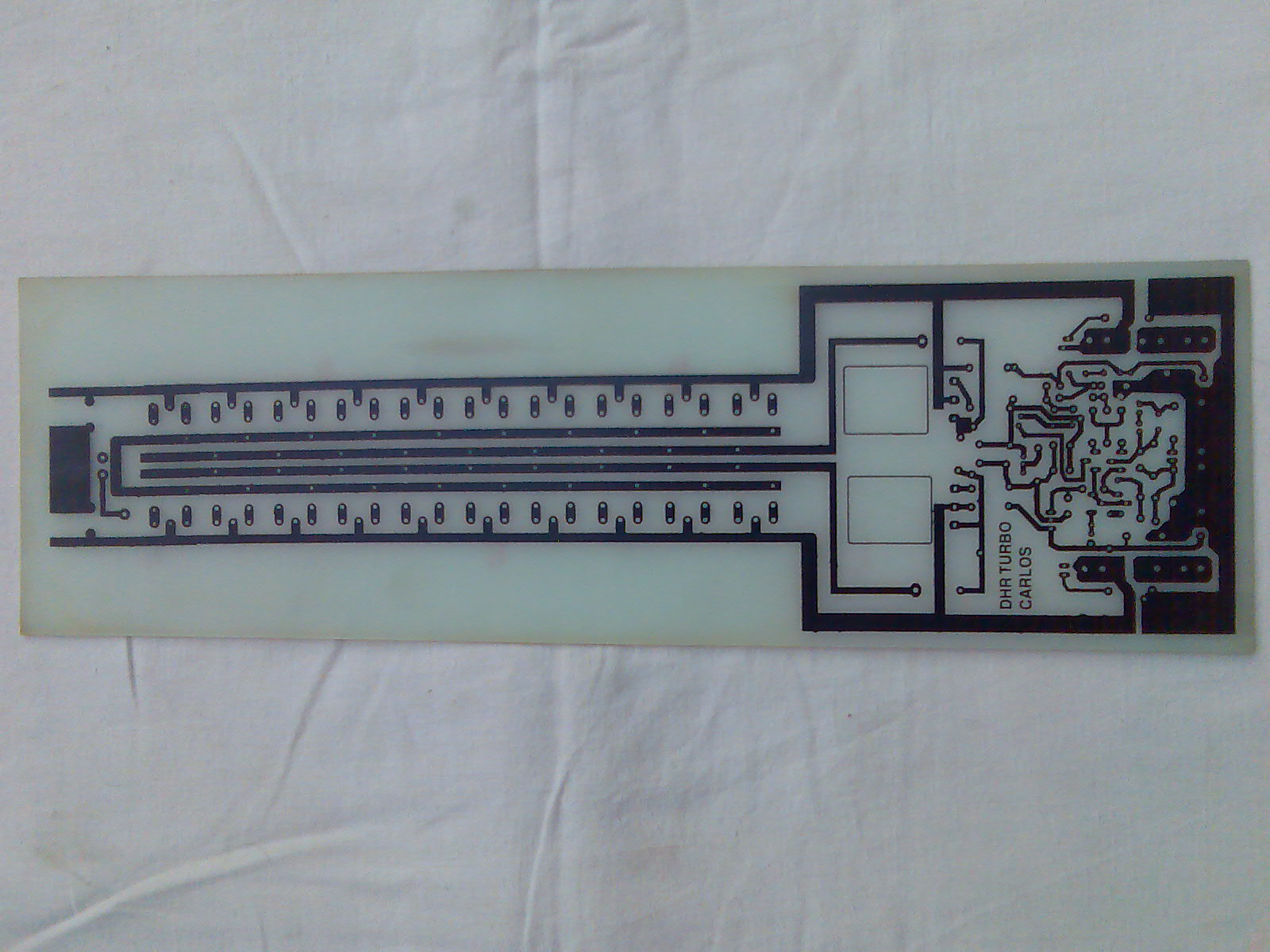

pcb pattern under development
i am very sorry to place my opinion but i think that your pcb is very poor ...
at this rail voltage and with so many transitors there is going to be way too much power and your pcb traces are too small ....
----the rail trace is very very small ( thin )
---- there is too many corners in the pcb ( it is supposed to be rounded )
---- in designs like that power is feed in the midle so power and amp drawing will equalize from side to side to the transistors
---- there is too many parallel lines in your pcb and this can cause complications and or oscilations
He cannot do much better dear Sakis.... too many transistors
You will always have the length or the width to run wires..unless you build a sandwich style..... alike a building..many stores, many stages...many floors... one transistor over the other..above the other..heatsink blades down the transistors...all then packed alike a indian toten pole..... other ways...we gonna have long parallel run of copper lines.... big distance between copper lines can be helpfull reducing capacitances from line to line..and some small capacitors (10pf) from colector to base may stop oscilations that can be generated there... the source of possible oscilations can be the combination of copper line length (inductance) with the parallel line creating capacitance...acting, behaving, alike 2 blades into a capacitor......then....installing the capacitor to "tune" that thing into frequencies higher than the maximum oscilating frequency the transistor can operate you will fix the hole thing..interesting...trying to force oscilation to avoid oscilation..this way you will force oscilations to happens ABOVE the maximum frequency the transistor can operate considering the voltage and current it will hold.
You know, alike a Radio Frequency "tank" circuit..a tuned circuit..the long copper line as inductor and the capacitor working together tuning certain frequency that is above the maximum oscilating capacity you have into your transistor..if he cannot oscilate into so high frequency, then you will be rid of oscilations...the capacitor can be 3pf, 5pf, 6.8pf, 8.2pf, 10pf...well...just tune the whole thing to oscilate into a "non possible oscilating frequency"
