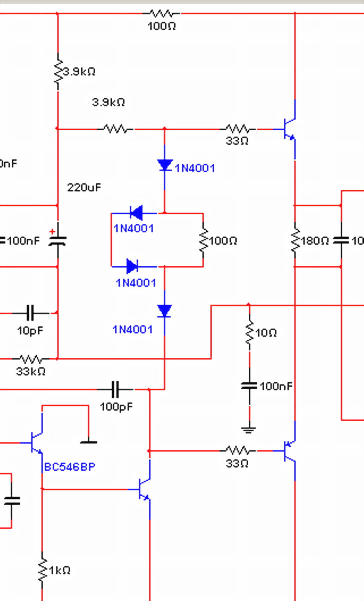

uncle carlos,
500mv across 1ohm emmiter resistance at output transistor if dxturbo is playing, is it okey?
Also 1.5 volts at Point A to Point B while playing, Is it okey ? when amp is in idle its 2 volts.
Output seems to be hotter compared to my Dx Amp. Only 8 Ohms load i tried today.
Regards
Regards
No!, 500 milivolts means 500 miliamperes, it is 5 hundred times bigger than the
correct current.
You have errors, 1.5 volts of bias measure from colector to emitter VBE multiplier cannot result all that enormous current to each power transistor, this is an assassination, the power transistors will but and very soon.
Are you kidding Masterinvi?, i said 1 milivolt, not 500 milivolts!
The current is the voltage reading over the emitter resistance, expressed in Volts (0.5V) divided by the resistance value (1 ohm), so you're having 500 miliamperes.
Measurements are made with the amplifier in iddle mode, without audio entering, in stand by mode.
Man!, you're not prepared to build power amplifiers, maybe you are good for television.
regards,
Carlos
correct current.

Sorry, i have lost patience with you, i was shocked and deeply scandalized with these
500 milivolts.
Well, 50 milivolts is still a very high current. as this means 0.050V divided by 1 ohms, this is 50 miliamperes crossing each power transistor..it is too much, fifty times what i have suggested, and 5 times the highest value you usually find in amplifiers.
Power is the current multiplied by the voltage, you see, each transistor will have around 80 volts from your supply, this will be the voltage you can measure from colector to emitter, say, one probe tip at the colector and the other one at the emitter, and 50 miliamperes will be crossing (80 X 0.05 = 4 watts)
This is too much, try to reduce and continue to check your amplifier, voltage measured from the NPN driver base to the PNP driver base must be 2.1 volts or higher, or your emitter floating resistance is wrong or you have other mistake, this 2.1 volts should be distributed to drivers and output transistors base to emitter junctions, and these voltages, around 520 milivolts should appear at the drivers base to emitter and also at the output base to emitter junctions, if you have, for instance, 400 milivolts at your driver, and 650 milivolts at your output base to emitter junctions, then you have wrong floating emitter resistance value.... voltage must be divided by driver and power transistors in a fair way, not too much for one and small voltage for other... check that.
Reduce your current to read 1 to 5 milivolts to each one of your power emitter resistances, no audio entering..... no possible?, then check your circuit and transistors because you have errors, mistakes, human failures, wrong parts ro damaged parts.
regards,
Carlos
500 milivolts.
regards,
Carlos

No, i just keep it playing in my shop with only 1 pair of output (2SA1106 and 2SC5198), using 50 vdc supply, 8 ohms load and volume control at 30% only. Seems fine. Cant turn full the volume, my 80 watts speaker seems to explode.
I have to test it with high wattage speakers tommorrow. and 70 vdc supply.
all voltages in all test points are in normal.
I install 681 mylar capacitor between base and collector of input transistor(2N5401) because there is pot! pot! pot! sounds in speaker even no audio, seems like oscillation. Lot of mistakes in my construction, My fault. after installing the caps pot pot pot gone.
Amp plays fine and clear, bass cant be feel because the speaker is not in the enclosure(just a test)
To test tommorow at full power with huge speakers.....

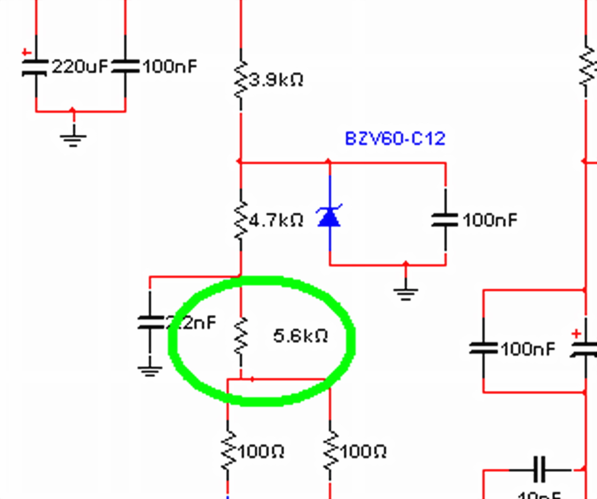

Ahahahahah!, motor boating... there's a very long time i do not listen this
Some rail condensers are missed, defective or inverted, motor boating is always because of condensers.
enjoy your amplifier that came together with a boat and a motor!

I do not believe too, but motor boating is always a result of electrolitic condenser
with defect, wrong capacitance, leakage, defective, misplaced, forgot, absent, inverted or soldered wrong place... of course associated resistances produces the "time constant" of charge discharge, and this charge and discharge is the motor boat, or produces the motor boat sound when transistors sense this.
Also capacitors do that, but usually happens a time constant of charge and discharge of capacitors that produces the popping sound, sometimes transistors goes on and off producing the noise, but ALWAYS the cause is absence of capacitor, or condenser, or electrolitic condensers, or they are missed, or damaged, or inverted,misplaced, forgotten or something connected to capacitance.
If you show me another part doing that, bring to me and i will eat the part and will produce a picture doing that to publish my shame.
Of course, a wrong rail resistance, in the place to be 100 ohms and people installed 10K, may produce something strange because will charge CAPACITORS in a very slow way that will produce some noises from time to time..... time constant is capacitor associated with resistance, one of them is wrong.
Now you "just don't believe", so, you are becoming better, as you have some beliefs.
Yeah, dear brother, i do use junk too..i love junk, they are tested parts, senior parts, guaranteed components.
Not the PSU condensers, search for the rail condensers, the ones after the rail series resistances, and check if other capacitors or condensers are misplaced, or if they have wrong value of resistances associated with them.
