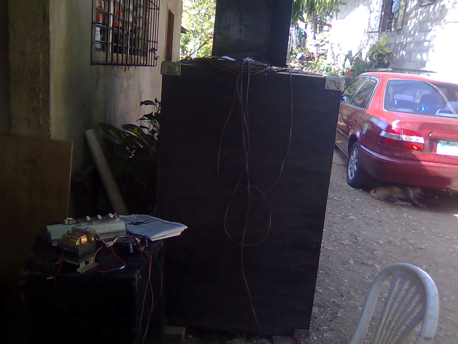

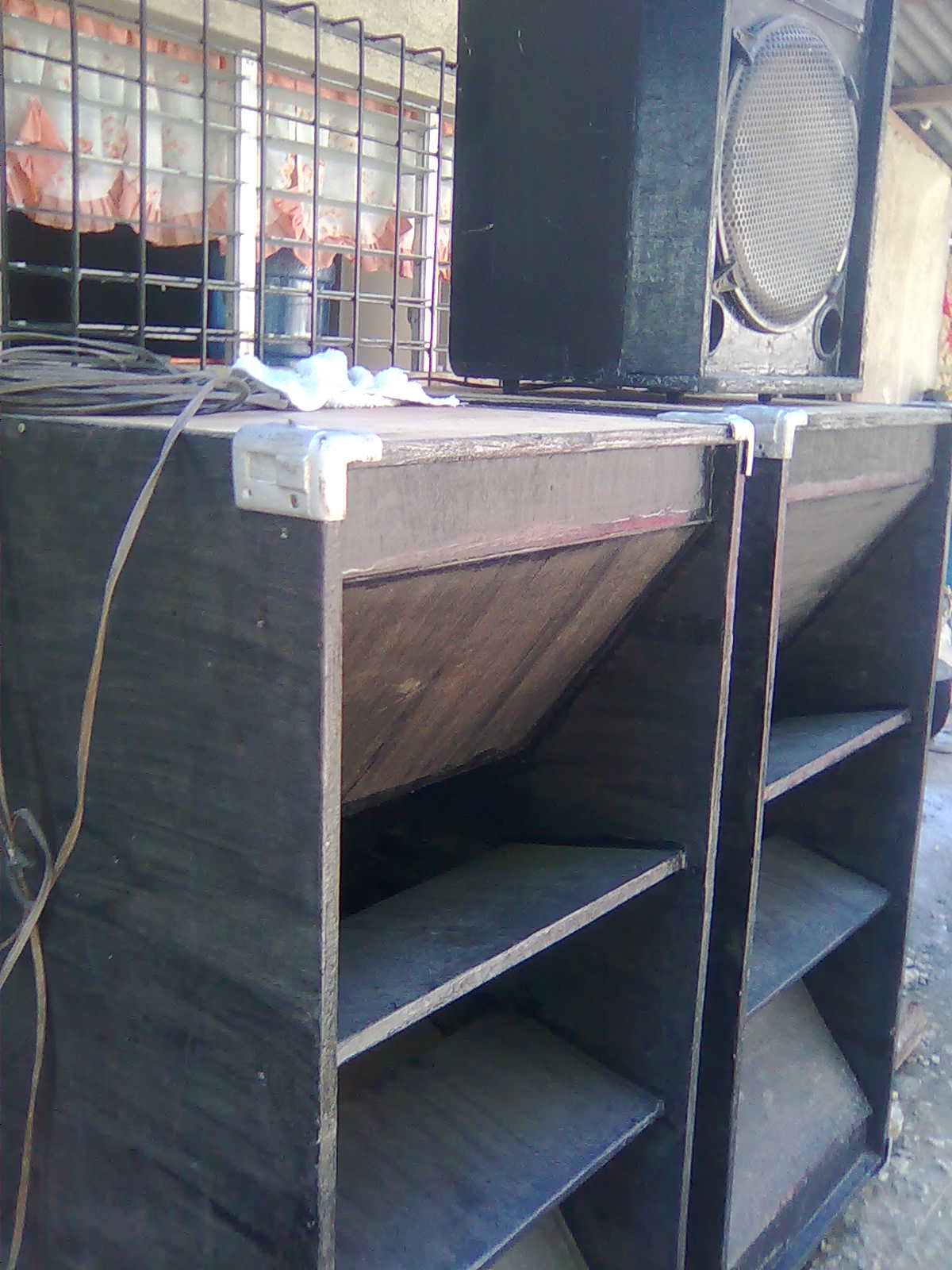

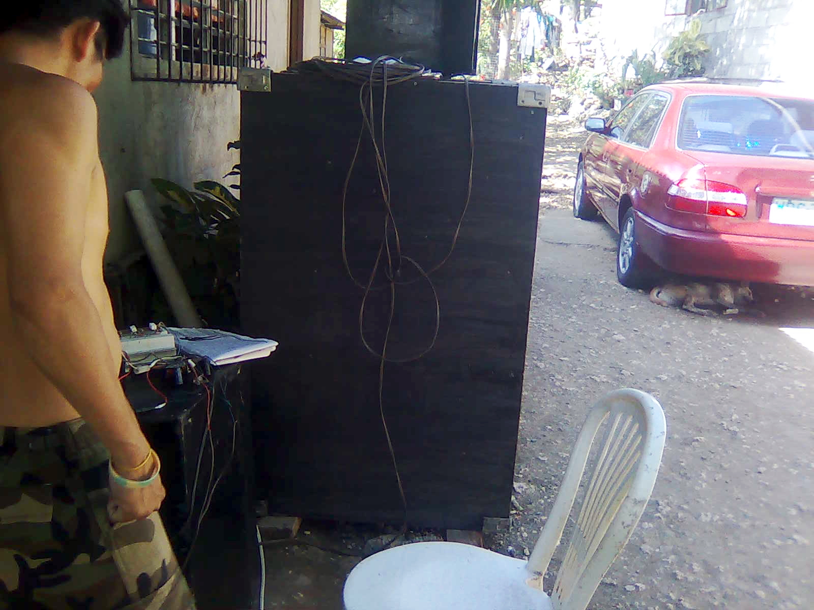

DXturbo is playing beautifully from 1 pm to 5 pm with 4 pairs of output driving 4 speakers(at 8 ohms) rated at 300 watts 15 inches diameter and it survive(total is 2 ohms). No blower or fan.
Pictures and video sent to uncle carlos in pm.
The video recorded in nokia celfone so only the instrument and voice is present but the super bass cant be hear. No distortion just clear voice and super bass(for shaking the house)
By the way, the supply voltage is 65 volts DC
Thanks uncle carlos.

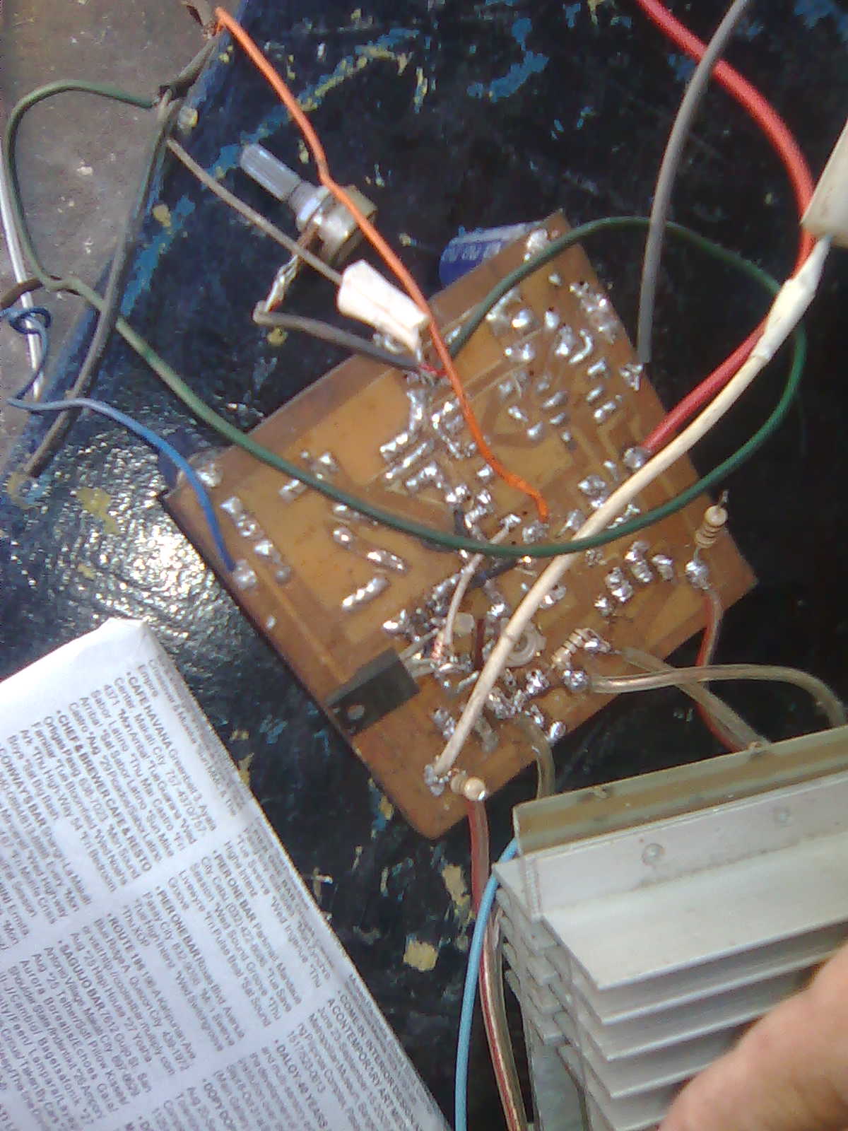

i assembled today the dx standard using 20 volts dc rail voltage, i use it to drive my tweeter. Of course my turbo is used for bass( in quasi, 65 volts rail ,3 pairs 2sc5200). A biamp as being called. Assembled in an old sansui case.
Unbeatable sound for me. Nothing i could ask for....
Better to post a pic...
You see, dear Masterinvi, using 20 volts you could have much better sound adjusting
Bootstrapp resistances and zener resistance...your sound could be much better..even misadjusted to work with 20 volts you felt satisfied.
Really the Dx amplifier sounds very good.... shock proof amplifier, very resistant to errors, mistakes and wrong voltages..very tollerant..works under strange conditions...someone has installed 24 volts battery, he used power resistances to divide voltage to 12 plus 12 and made the amplifier work....almost unbeliavable but he did and sent me a sound sample.
Bootstrapp should be tuned... watch Greg site schematic..change R6 to 1K2... also change R12 to 1K2 and R13 to 1K8
Adjust bias to read 550 milivolts in the output transistors, from base to emitter..install big heatsinks, use minimum of 6800uf each rail and be happy with better sound.

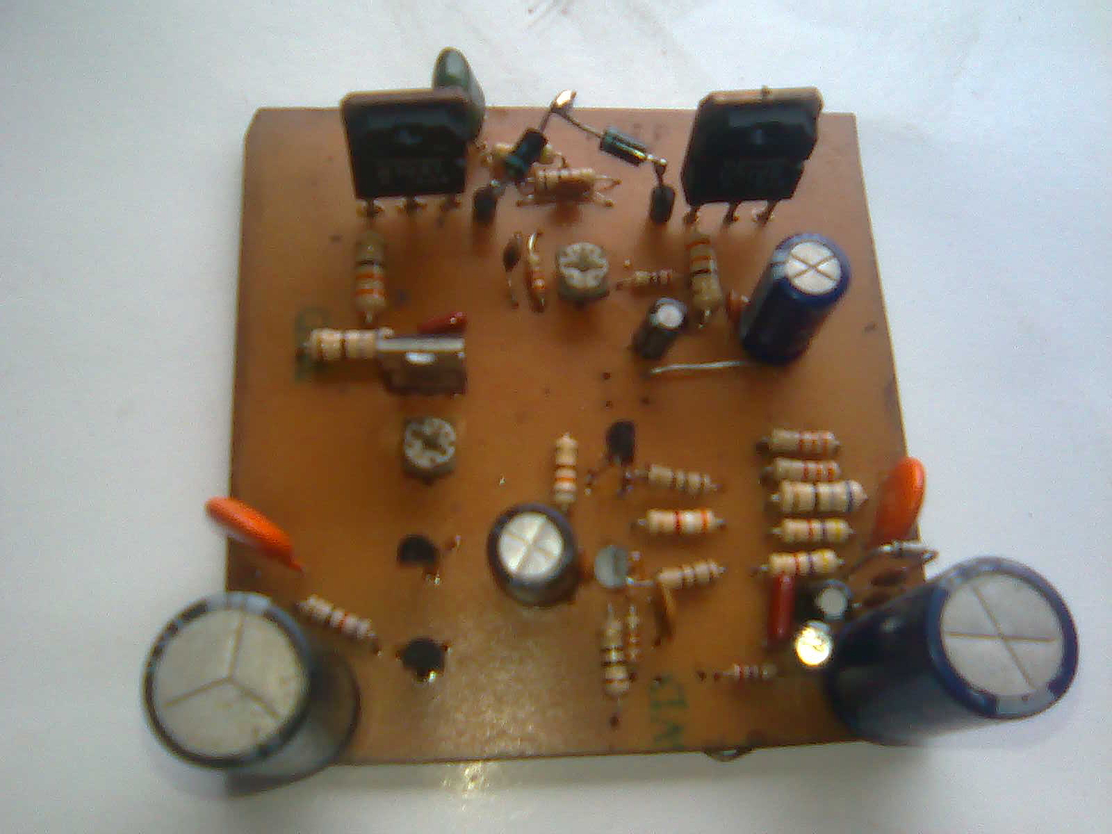

i love the dx turbo in handling the bass, really, i love it. THe punch is very clear and tight. But i think dx standard is so precise in sonic than turbo. I dont know, maybe its just my ear because i dont know how to listen. Its not because turbo has much power because of rail voltage, even so, even if you use 50 vdc in dx standard and 50 vdc also in turbo and compare it, you can hear the diffrence. Thats why i decide to choose turbo for my bass and dx standard for my high(tweeter). The result is excellent. Unbeatable for me.
- This is the DHR.... Dx High Resolution Turbo
