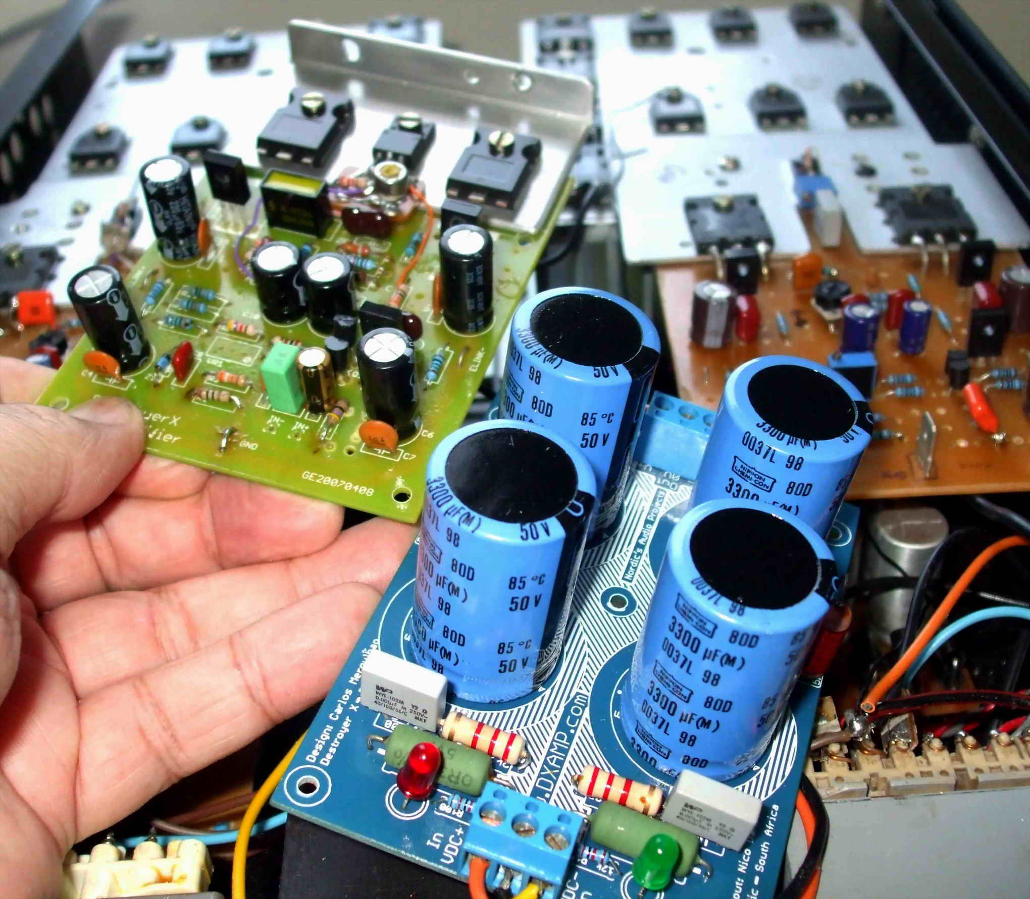

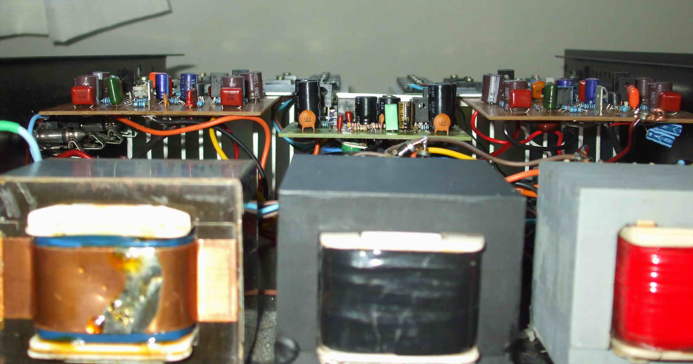

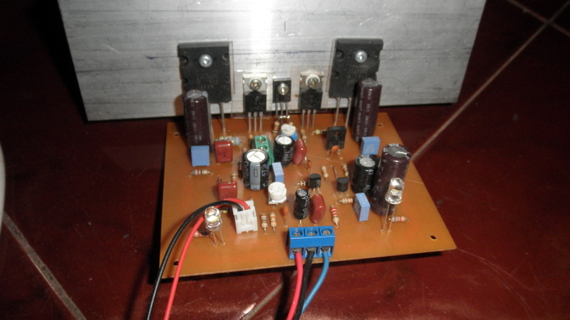

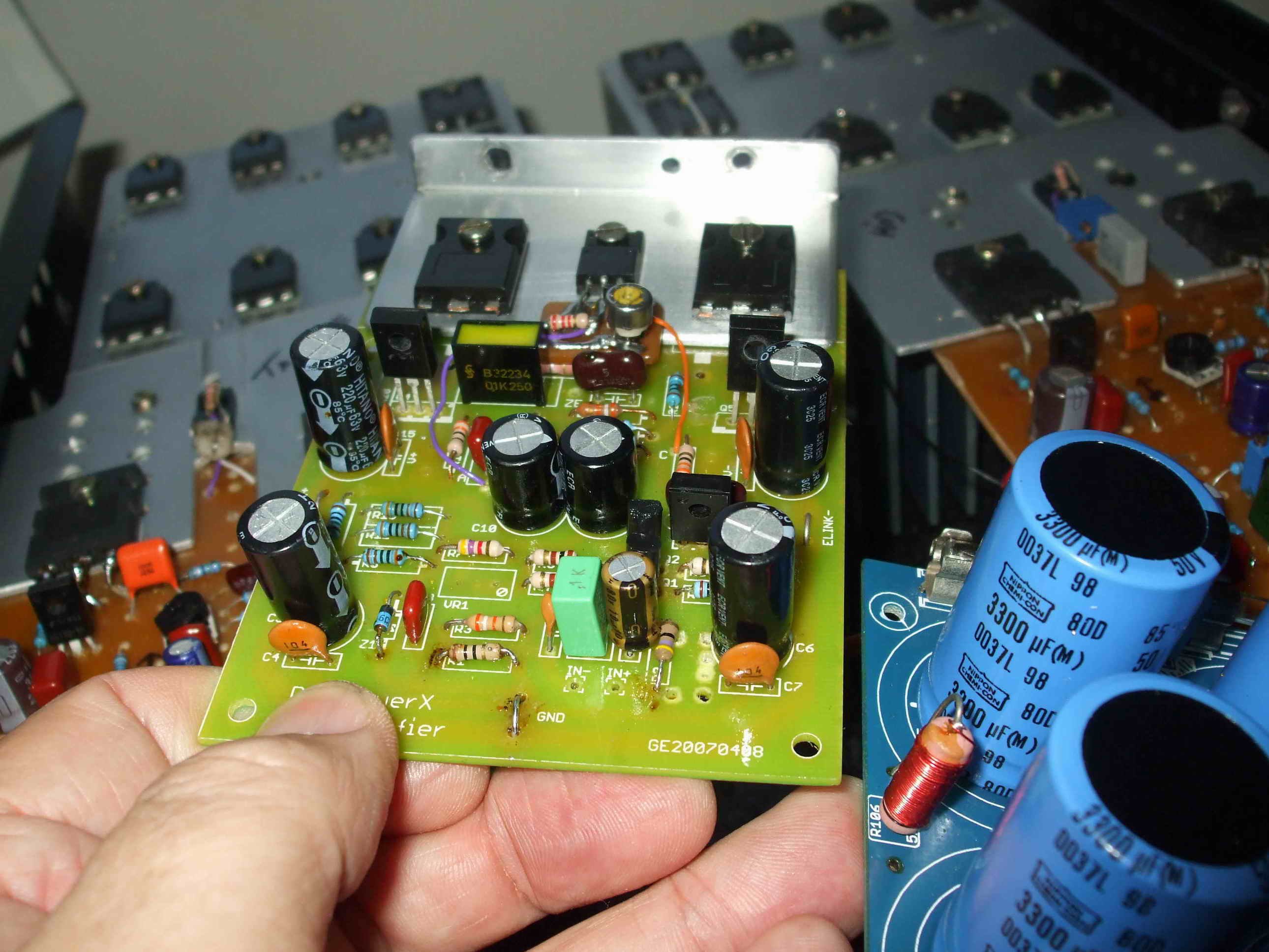

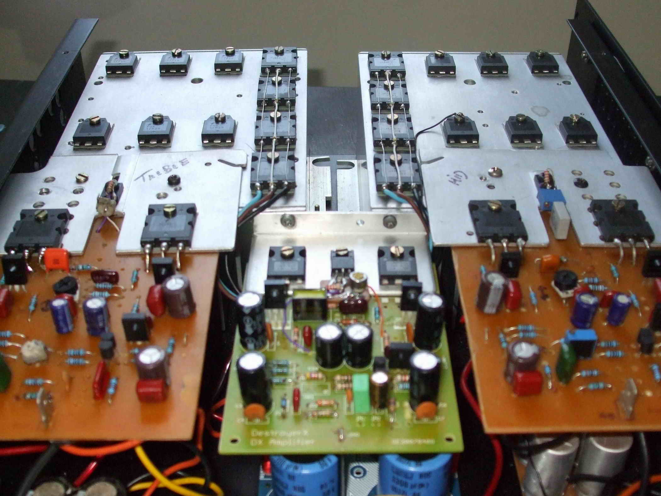

This is the DHR.... Dx High Resolution Turbo
Just want to show the my DX amps inside the old sansui case. Very rugged.
dx turbo using 3 pairs,65 volts. driving the bass ,very lovely bass.
dx standard 1 pair 20 volts driving high.
excellent because adjusting the high will not affect the bass, adjusting the bass will not affect the high. very good sonic. Perfect for me.
That's the idea i have applied in the Dx TriAmp.... one not affect the other
I am, rigth now, preparing the TriAmp to receive the active input filter (IC)... then i will have full control of bass, treble and midranges.
Thank you very much by the pictures Masterinvi.
Very good idea to join the DHR Turbo and the Dx Amplifier.
regards,
Carlos
