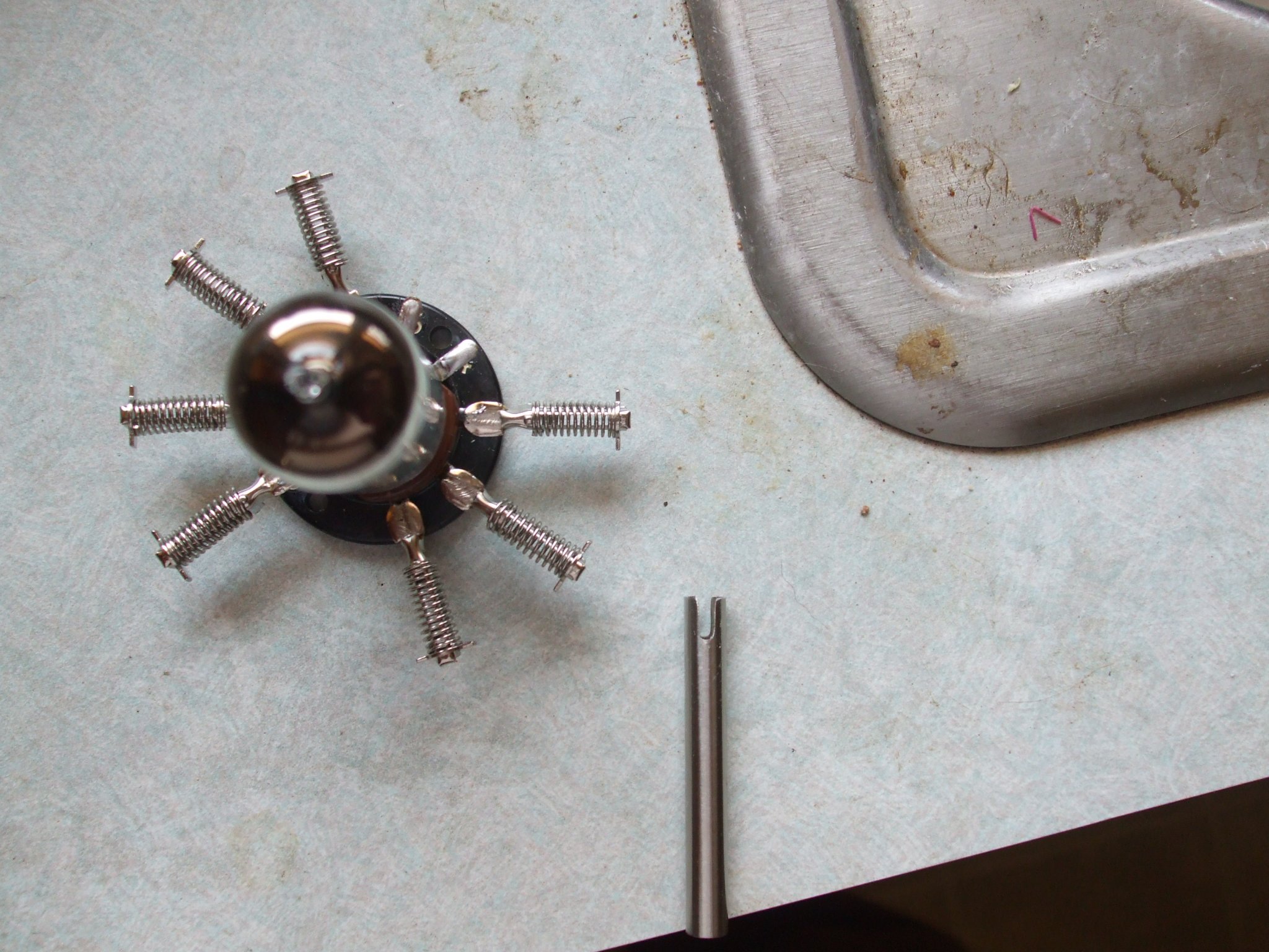

George, I have a home-made tool for inserting wires into the T30 terminals easily, without getting sore fingers:
If you want one, message me with an address. It's made from a soda straw size stainless steel tube using a thin grinding disk.

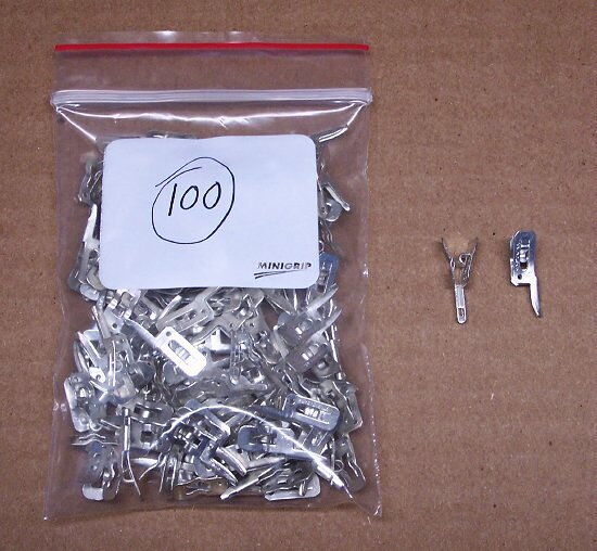

I was thinking something like these Mini Grips ( vertical Fahnestock pins ) until you just posted the spring button things. These Mini Grips are $0.60 each on an Ebay site, like 6X the price of the T30 terminals.Currently I use vertical spring clips that accept up to 14 gauge wire

When using these vertical clips, I keep a small blade screwdriver handy to press down the spring levers, the levers have a slot that fits a tiny screwdriver just press and insert the part(s).

The spring depressor tool works quite well, by the way. No more sore fingers. Only took me a half hour to make a half dozen. Let me know if you want one. Vector made a similar tool with a nice wood handle, but I can't find one online.

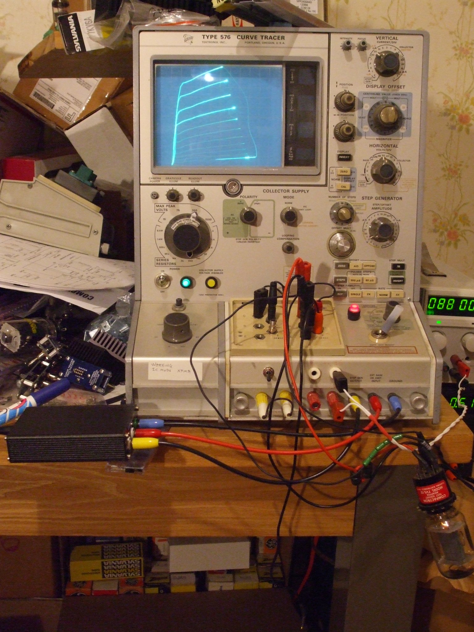

Here is the (2nd) $400 curve tracer I got for parts recently. (turned out so easy to fix, I'm using it for tube or SS testing now) (camera shutter timing caused the blanked traces ) Notice the Pomona Test adapter holding the tube at lower right. Or could use surface mount sockets too.

Definitely NOT OSHA approved with all those "hot" pins sticking out. And I've tested them a few times. Do Not touch the RED lead! I actually modded the curve tracer so that it's highest plate V scale (1500V) is now "just" 750V. Sleeping better at night.

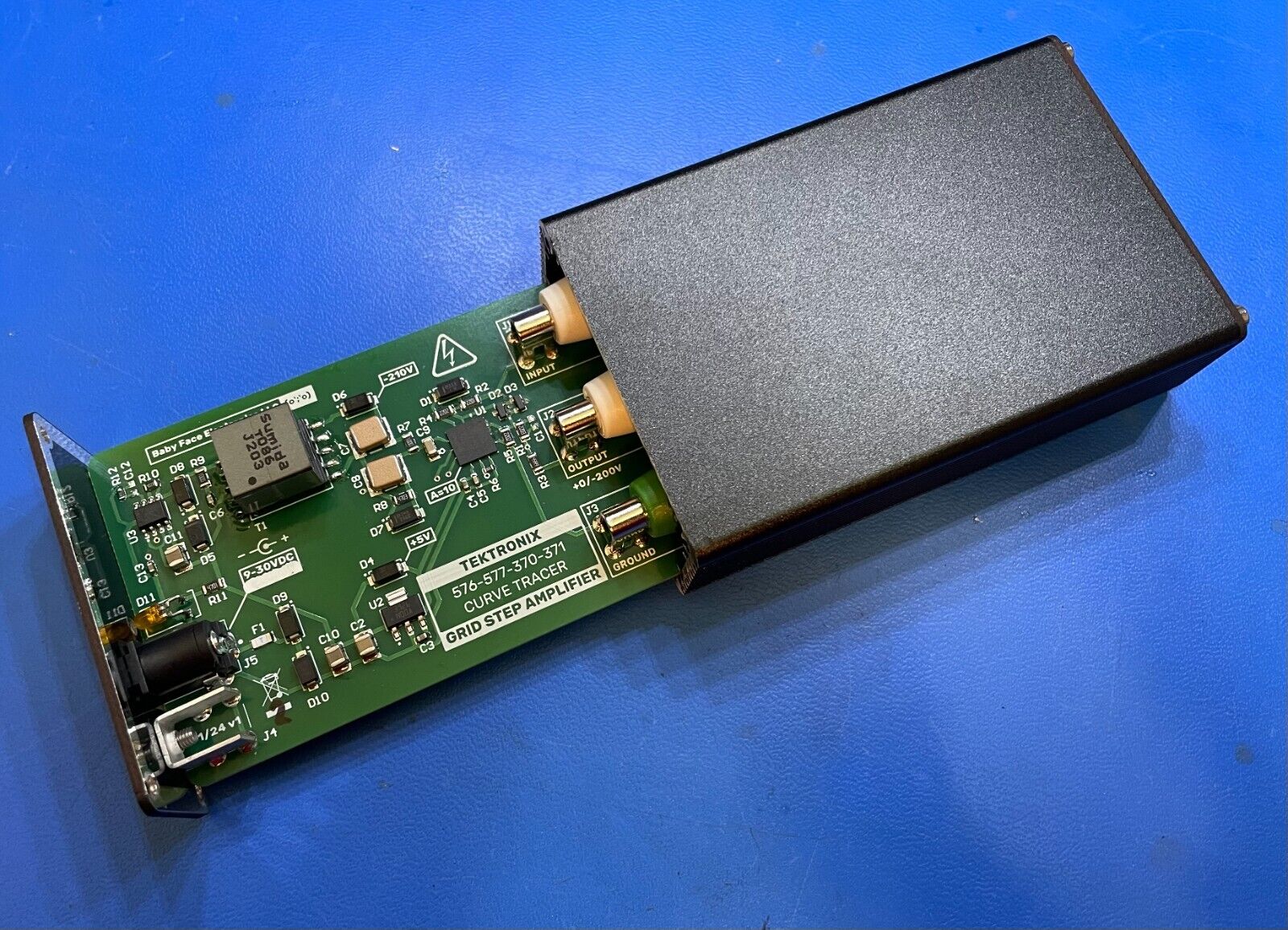

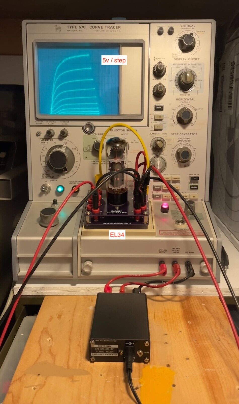

There must be a few Tubies out there with Tek 576 Curve Tracers. I see the 10X Grid Step Amplifier modules (for tube curve tracing using the Tek 576, -200V max step range) have sold out. Hopefully they get some more in. Working nice.

I should mention that I use a 750 Watt Medical Isolation Xfmr to power the Tek 576 Curve Tracer. Plastic knobs on the tracer of course. At least -some- safety factor with that. The Tek 576 is rated 305 Watts max. The HV supply is rated 220 Watts. I should wrap some electrical tape around the unnecessarily exposed outer test socket pins. Most shocks have been from one finger to the next.
The tube socket adapter Ebay shows with the Step Amplifier (in the pic above) is nicely insulated, however, you can only get one tube plugged into it. The tracer can do two tubes, using the big toggle switch, for comparing/matching tubes. So this adapter is not that desirable. My (dangerous) Pomona socket adapter scheme allows two tubes to be connected up simultaneously, and I have Pomona adapters for 7, 8, 9 pin, Novar, Compactron, Loctal, Magnoval and even sub-mini tubes.
I have two different pairs of snub nosed pliers (like a sawed off needle nose) that work well for stuffing wires into the T30s.The spring depressor tool works quite well, by the way. No more sore fingers. Only took me a half hour to make a half dozen. Let me know if you want one. Vector made a similar tool with a nice wood handle, but I can't find one online.

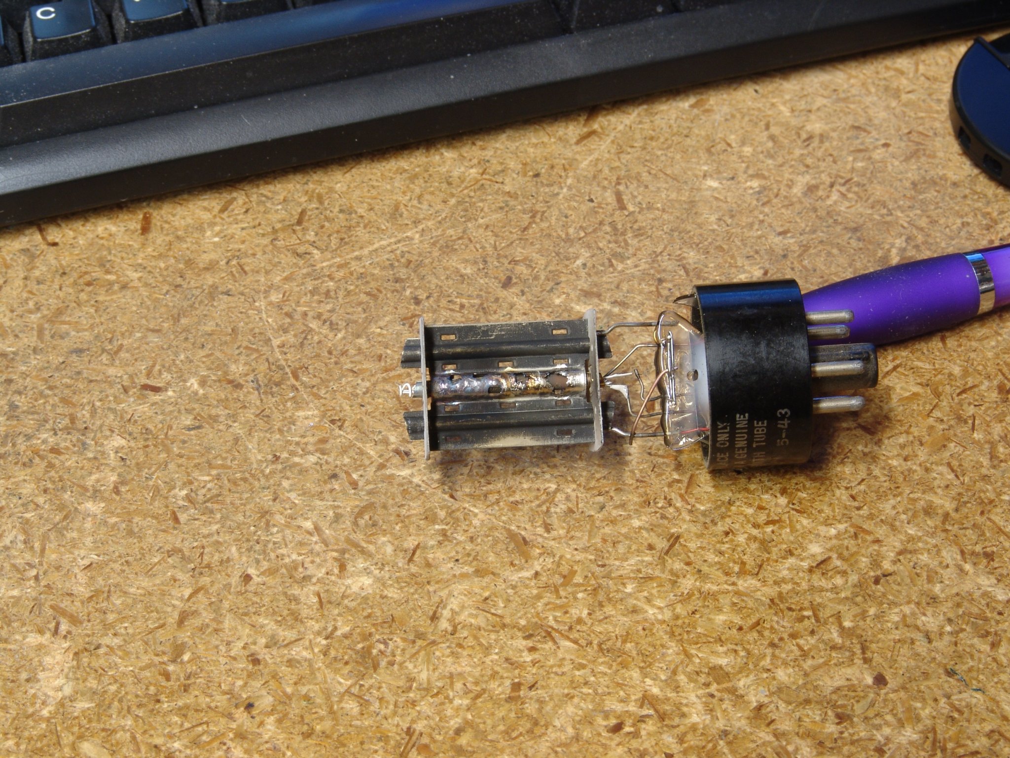

I found this 1943 vintage TV damper tube in a box full of used tubes that probably came from a hamfest. There was a hole burned clean through the plate making the cathode visible. I fired it up on a pair of power supplies to find that it still bettered the published curves for voltage drop VS forward current. I did not trust it, so I decided to take the test a little bit beyond the published values and the rated maximums. This tube put up a good fight. It took me about an hour to kill it. Death came when the blue ray that was shooting out of the hole turned into a plasma followed by arcing and particles of vaporized cathode began impacting the glass eventually leading to a crack. The first picture is after the long cooldown.

I have used the 576 for tubes -- was able to purchase surplus plug-in adapter not yet changed over to tubes.
