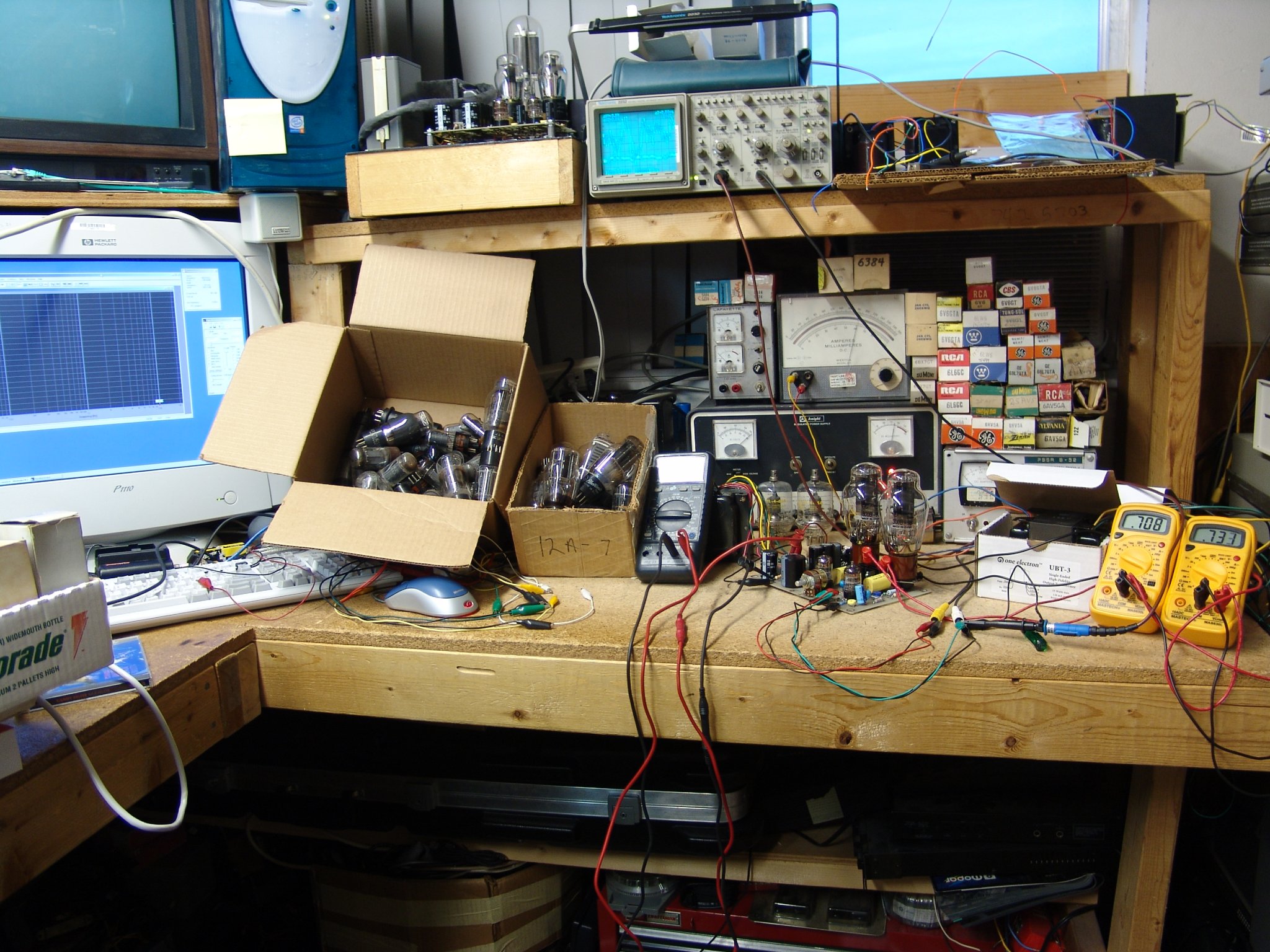

All of my previous tube labs were 400 volt (or more) finger traps. I learned long ago to use a "two step" process to insure a dead board before fingers get near it. #1, turn the power supply output off. #2 pull out the banana cable that connects the power supply to the board. For line powered experiments, pull the plug out of the wall outlet, and remove the other end of the cord from the IEC jack on your project. Just yanking the cord from the wall isn't good enough when the cord on your soldering iron looks just like the one on your live project! Another lesson learned, put some heat shrink or even tape around the dual banana plug that feeds your project. Sooner or later you may need to kill power in a big hurry, and often the easiest way to do that is to yank the dual banana out of the power supply. When you put the wires into the plug you stuck them through the holes and tightened the screws. Those little stubs sticking out the other side are LIVE and in the right spot to blow a little hole in your fingertip when the knob on the supply is all the way up. Yeah, that got me to fix the broken "operate / standby" switch on the supply.

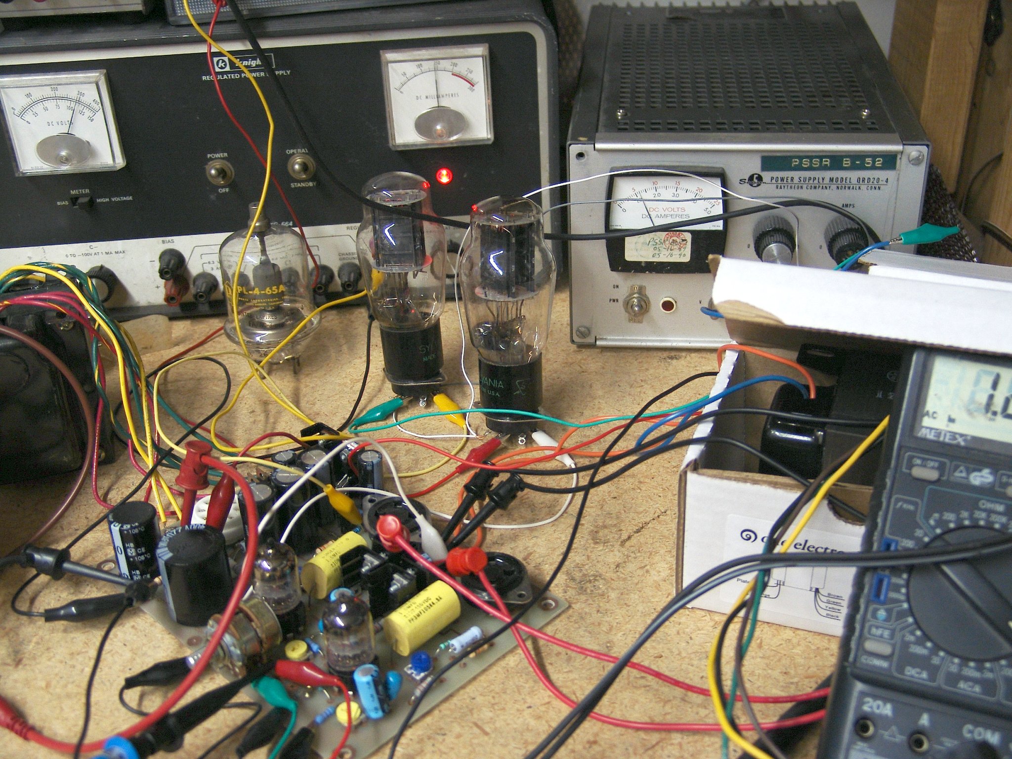

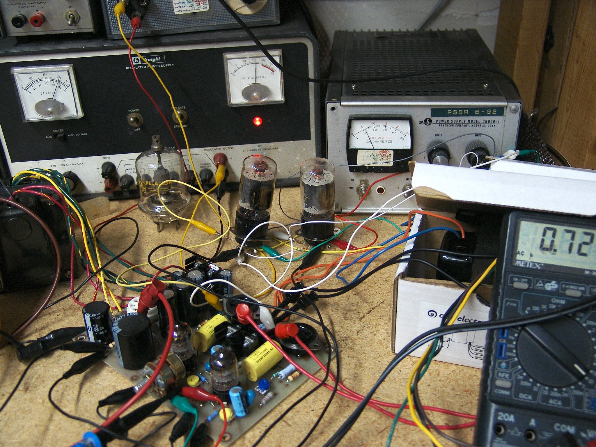

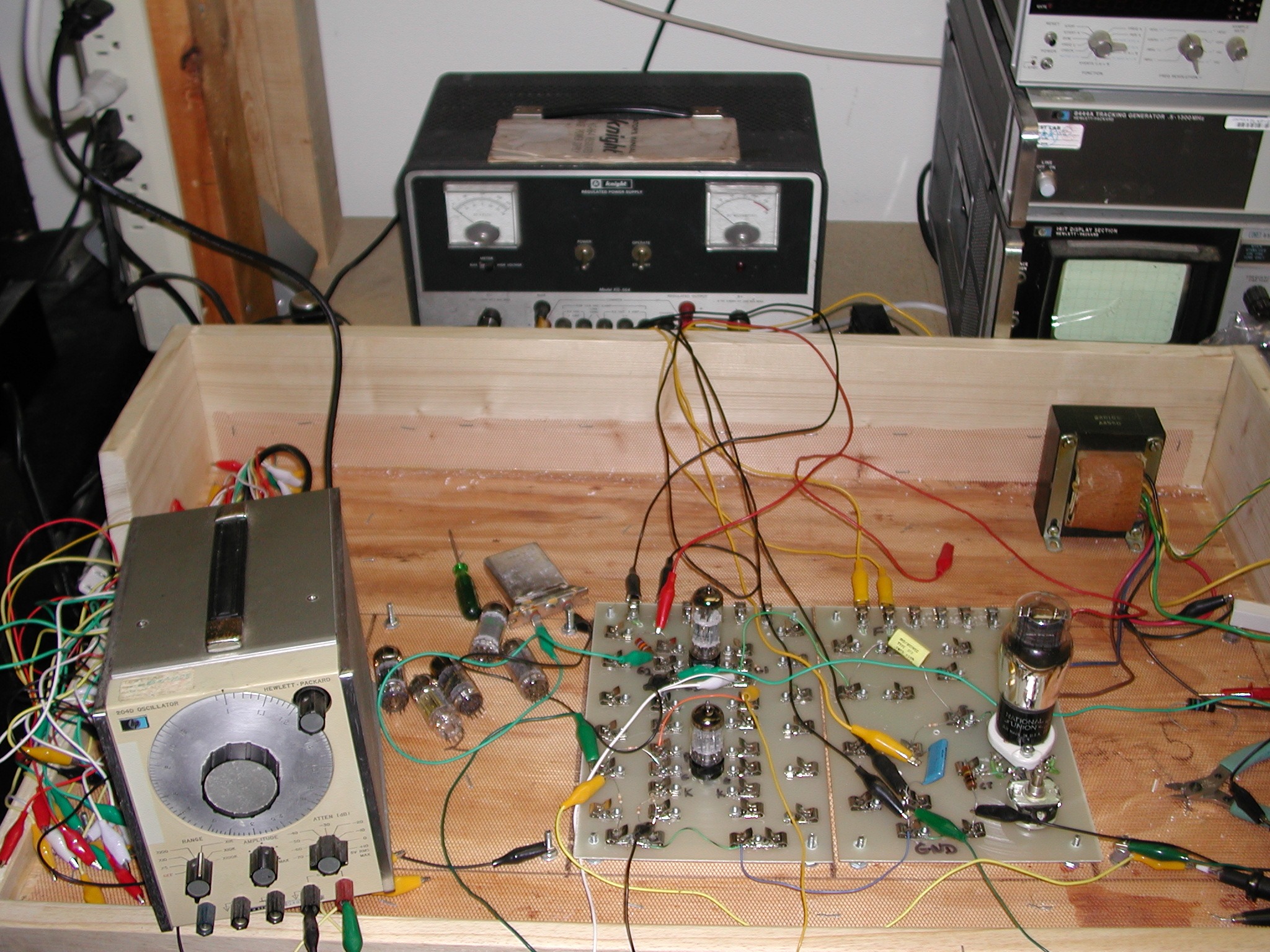

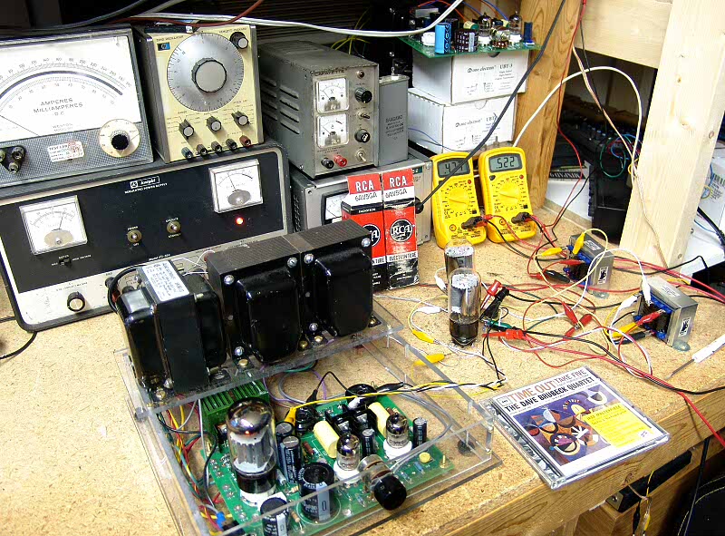

I have made and discarded several prototyping systems. Here are a couple pictures of Tubelab II from 2003 or 2004. This is the very beginning of the original Tubelab TSE board. The IXYS 10M45 chip did not exist, and PowerDrive was not even yet a dream. I was testing dozens of driver tubes in the bottom socket with a pentode CCS load in the top socket. The pentode was likely a 12GN7. The output tube was a 45. I still have the rest of the Fahnestock clips used to build these boards in their original bag from Mouser. The stock number is now dead, but similar clips are still on Amazon.
Within a few months I had discovered the 5842, the Constant Current Diode that replaced the pentode CCS, and the brand new 10M45 CCS chip that replaced the Constant Current diode, and Power Drive. Two small glass diodes can be seen in clips on the right side of the driver board. The 10M45 and a mosfet source follower buffer form the PowerDrive circuit that loads the 45 and feeds the 845. They are mounted on the heat sink back behind the 845 tube.

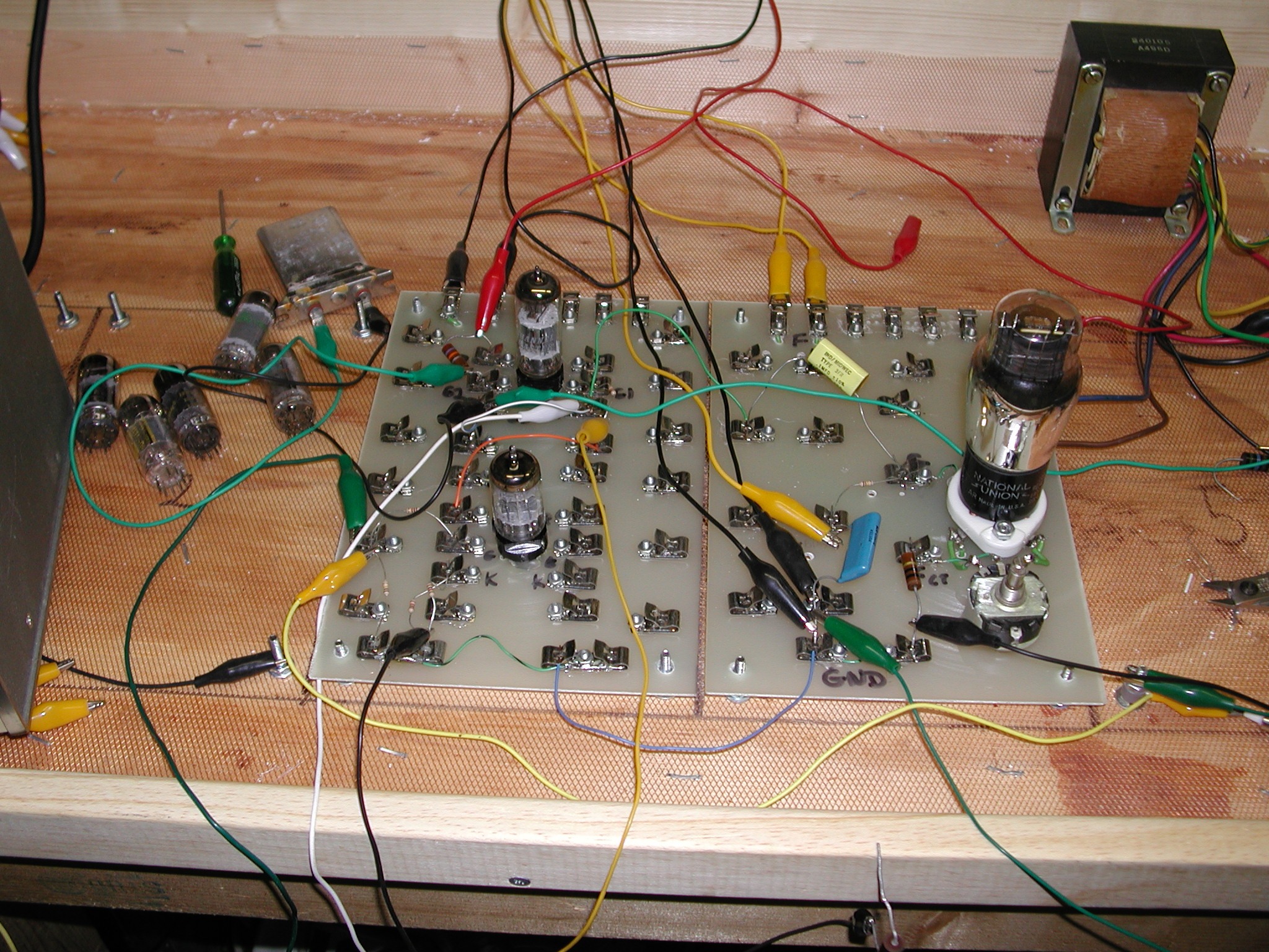

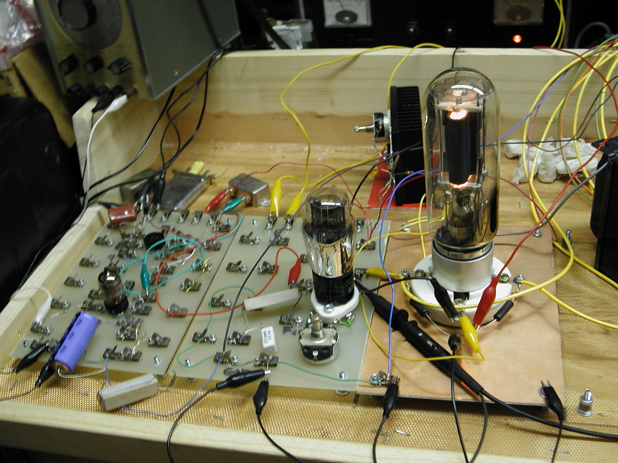

In this iteration of the tube lab each "PC board" all modules were made with blank G-10, no copper. There is a Fahnestock clip for each pin on the tube socket, and several unconnected clips. The modules are rather large and somewhat clumsy to use. Building a multi stage guitar amp on this system would not be possible. The system seen in post #33 is more generic, anything can be built as there are just tube socket modules, and empty generic modules. There were a couple purpose built Power Drive style modules and a module with a row of pots and switches. It's building style was also clumsy, created more wiring, and took longer to change individual parts due to the screw terminals.
I plan to reuse the white plastic base from Tubelab III. It is actually built on the wood base from Tubelab II. Tubelab II had a hinged lid that never got used since it wouldn't close with anything larger than a 6V6GT installed. I cut the sides off when I put the white plastic on. The copper screen is still in place and connected to circuit ground. It cuts down on noise and stage to stage coupling from all the wires.
For now, the individual modules will be single stage amps with all of the major components easily swappable without a soldering iron. They will be PC boards, each 100 mm X 100 mm or smaller, and JEDEC base specific like those from Tubelab III. I will try the T30 thingies, and if they don't work out, I have lots of the spring thingies from Maker Trading Post.
I think these would have been useful if a swappable part mechanism could be added, but they are no longer available either. It seems that there isn't much demand for real circuit tinkering any more. It's just too easy to copy something......until there is nothing cool left to copy.
