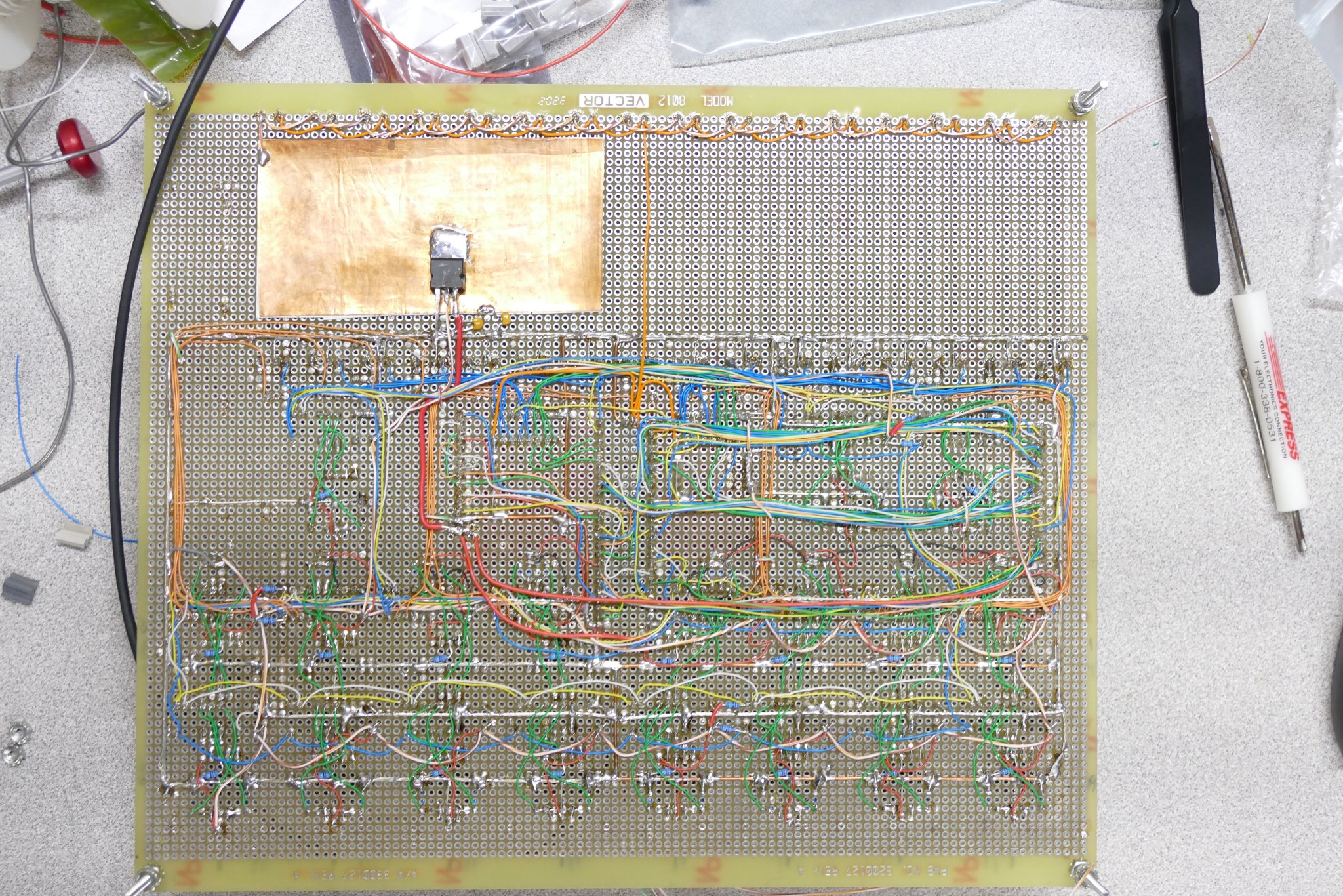

I've been breadboarding for over 70 years, mostly as a designer and troubleshooter of low-level, 24-30 bit-equivalent precision AC and DC, audio-bandwidth analog, A/D and D/A hardware for medical scanners and patient monitoring.
I love the smell of crispy-crittered ICs in the morning.

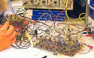

Most of my home breadboards, whether thru-hole or SMT, start out nice and neat and some end up a 3D pile of components, but not quite as bad as the attached circuit by analog giant and fellow National Semiconductor EE, the late, great Bob Pease.
1) I've been working on some high gain infrasonic audio with a low end -3dB frequency of ~ 10 milliHz for several years. My recent first use of a pegboard confirmed what I've suspected all along - pegboards are too open and mechanically unstable for microvolt-level circuits. Solder everything together or make/buy a PCB.
2) Without shielding, high gain infrasonic circuitry is sensitive enough to respond to an ESD-charged garment or charged small poly crate from at least 3 ft away.
3) I've gone through all sorts of typical protection to prevent insidious ESD damage to my breadbord's ICs - wrist staps, humidifiers and the like. I've recently found something that works well to protect them - Home Depot's Husky 18 x 100 inch black DCT130001 tool box drawer liner, ~ $18 per roll.
Just lay an 18 x 18 sheet on your bench. Stay away from adhesive-backed liner. It may make you feel more secure to lay some grounded heavy-duty Aluminum foil under the mat. It has enough carbon black to squelch ESD, but its resistance is in the 1000's of MegOhms per square, high enough to not bother live low voltage circuits. Plus, it's 1/16 inch thick and rubbery, in case you crop a component on it. Just try to avoid dropping solder blobs on it. Molten solder will embed itself.

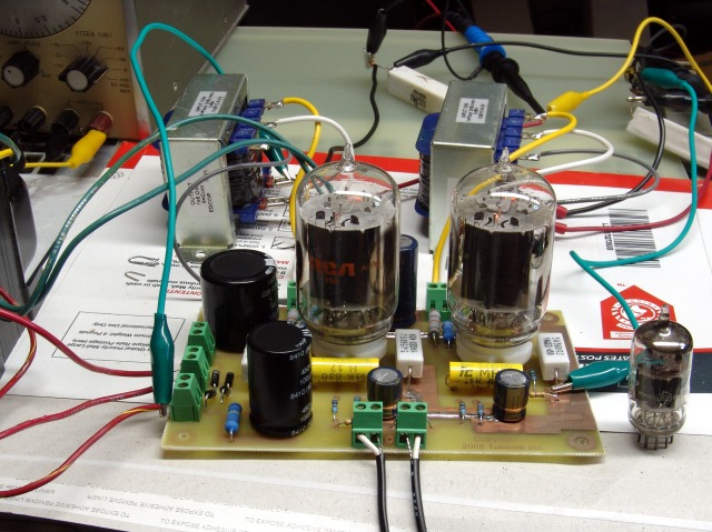

This tube tester was built from an old amp. It's results are much more reliable than any of the commercial tube testers I have:
https://www.russoldradios.com/blog/testingmatching-audio-output-tubes
I had been making SSE amps for some time and often tried random different tubes in it. The 6EZ5 appeared on the dollar list one day, and it looked like it might be useful, so I got some. It worked well in the SSE. Sometime later I found a web site that told me a 6LU8 or 6LR8 was a 12AT7 triode and a 6EZ5 in the same bottle. This meant that the 6LR8 could be used to make a baby SSE. How do I find out if it will work in the shortest possible amount of time. Forget breadboards, why not clip leads? "That won't work!"

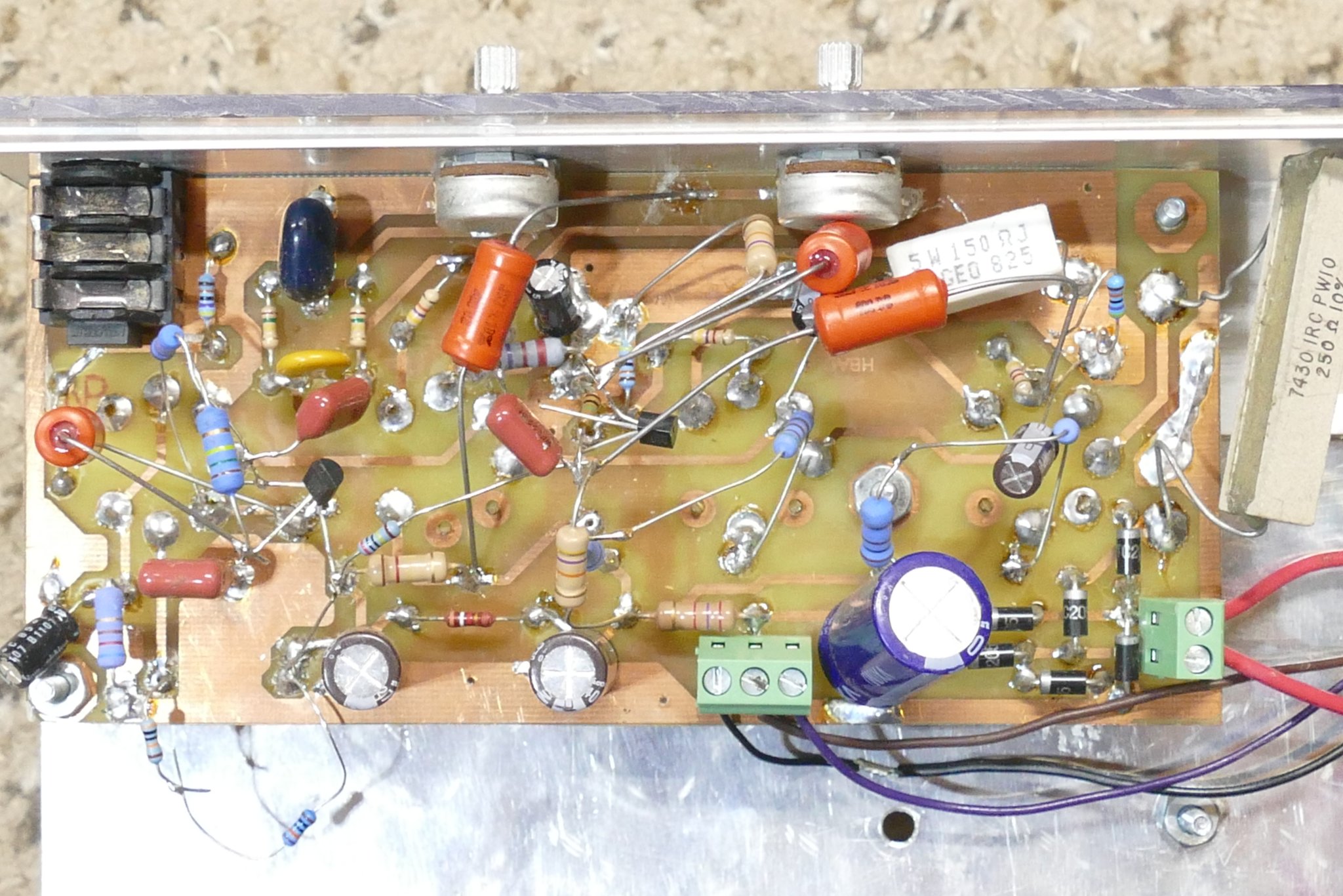

Yes, this amp actually worked, so I made a PCB from the mess. It's still around here somewhere. Don't try this with high Gm tubes, it really won't work.

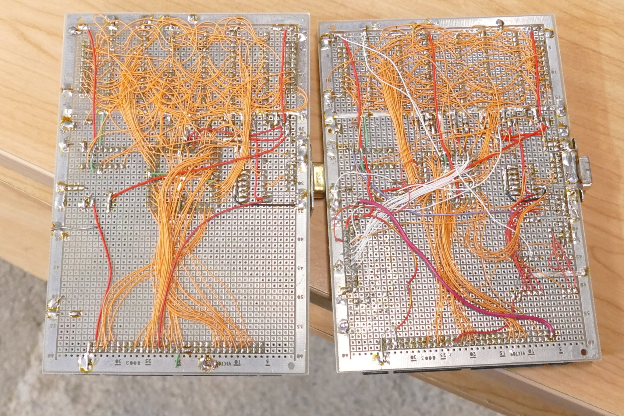

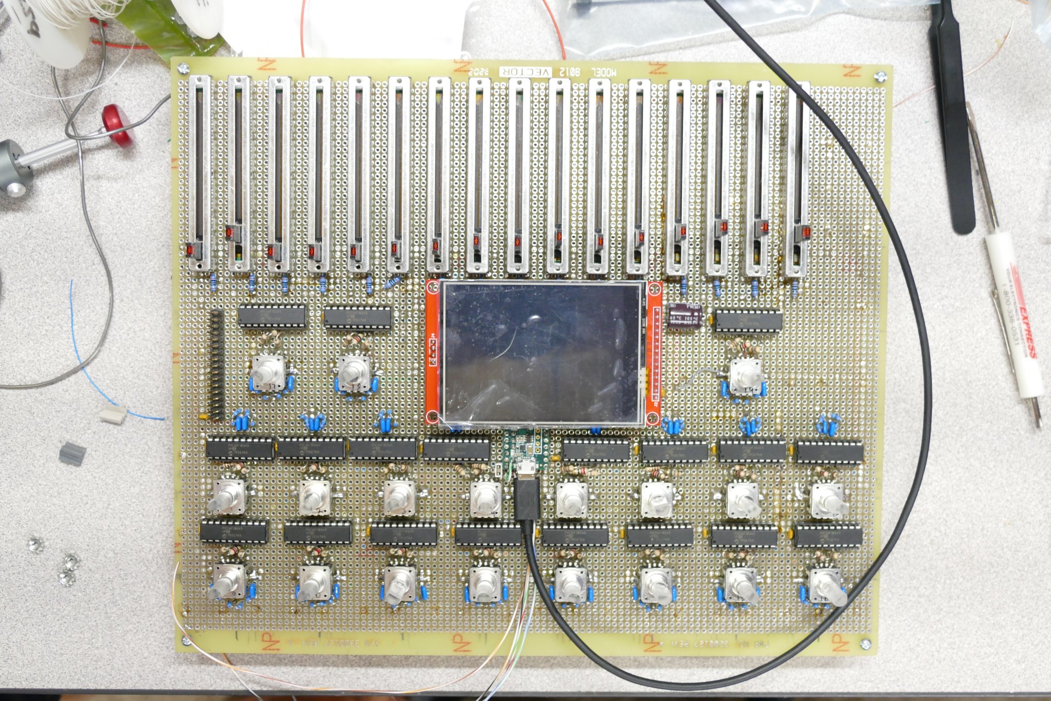

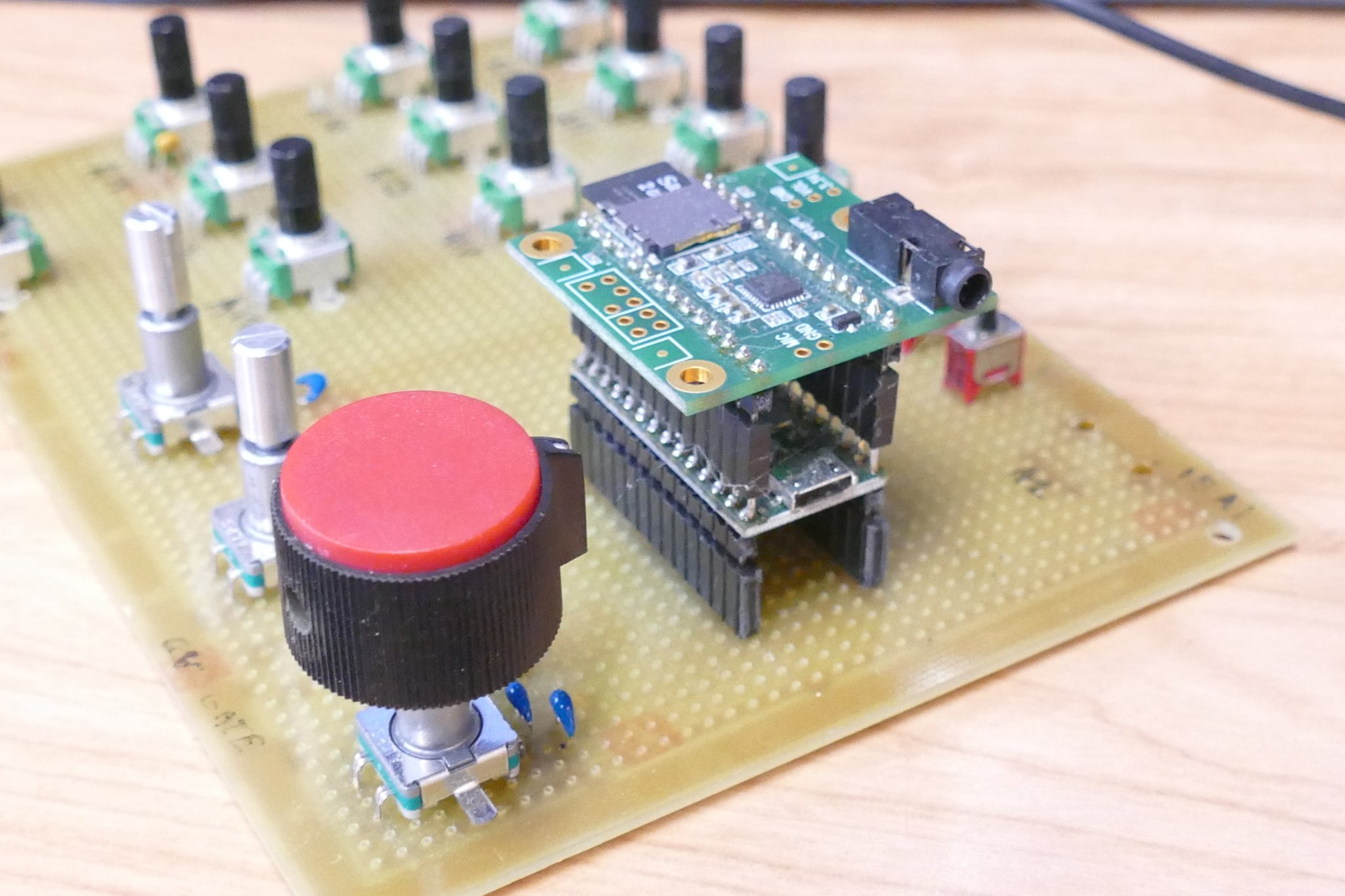

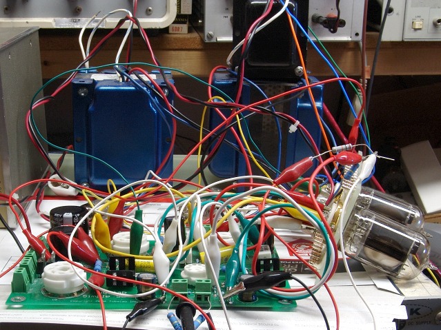

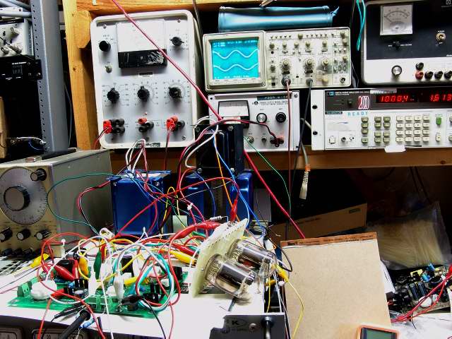

I still build stuff with the same breadboarding technique. The board with the big red knob is a simple "virtual analog" music synthesizer. I find the words "virtual analog" right up there with "Vegan Leather." The board with the slide pots, LCD touch screen, and 19 rotary encoders is part of a not so simple synthesizer with both analog and digital signal paths). This board is just the UI. The sound generator is on another equally large breadboard, still unfinished.

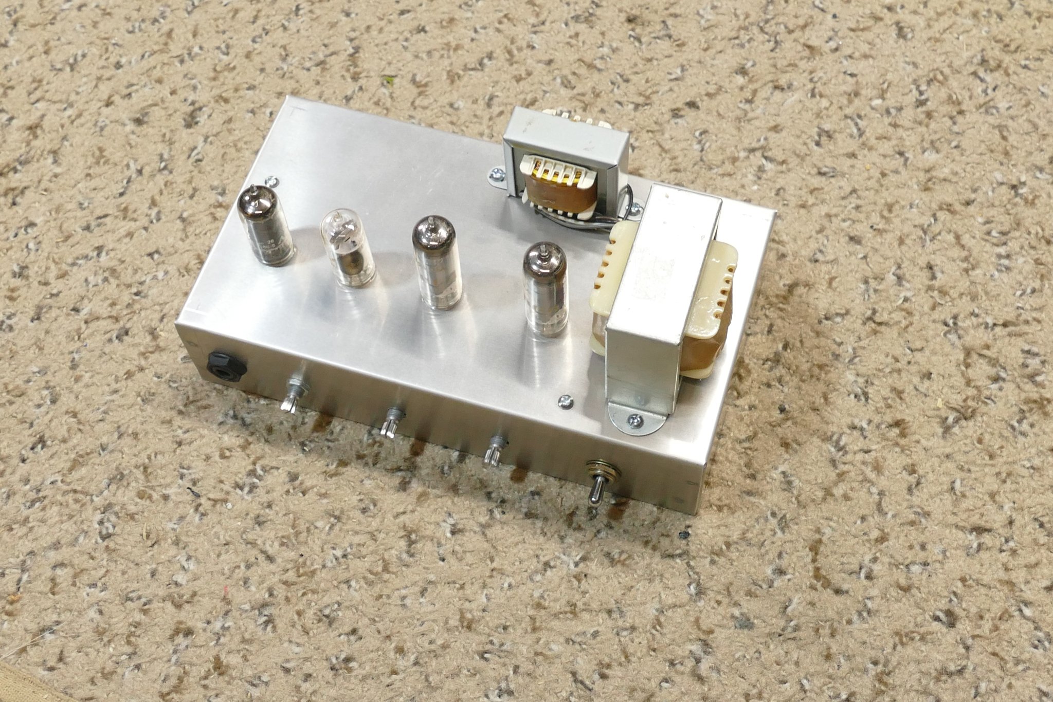

The latest breadboard is the vacuum tube gain stage seen in post numbers 110, 113, 114, and 119 of this thread. It uses much cheaper perf boards from Amazon.

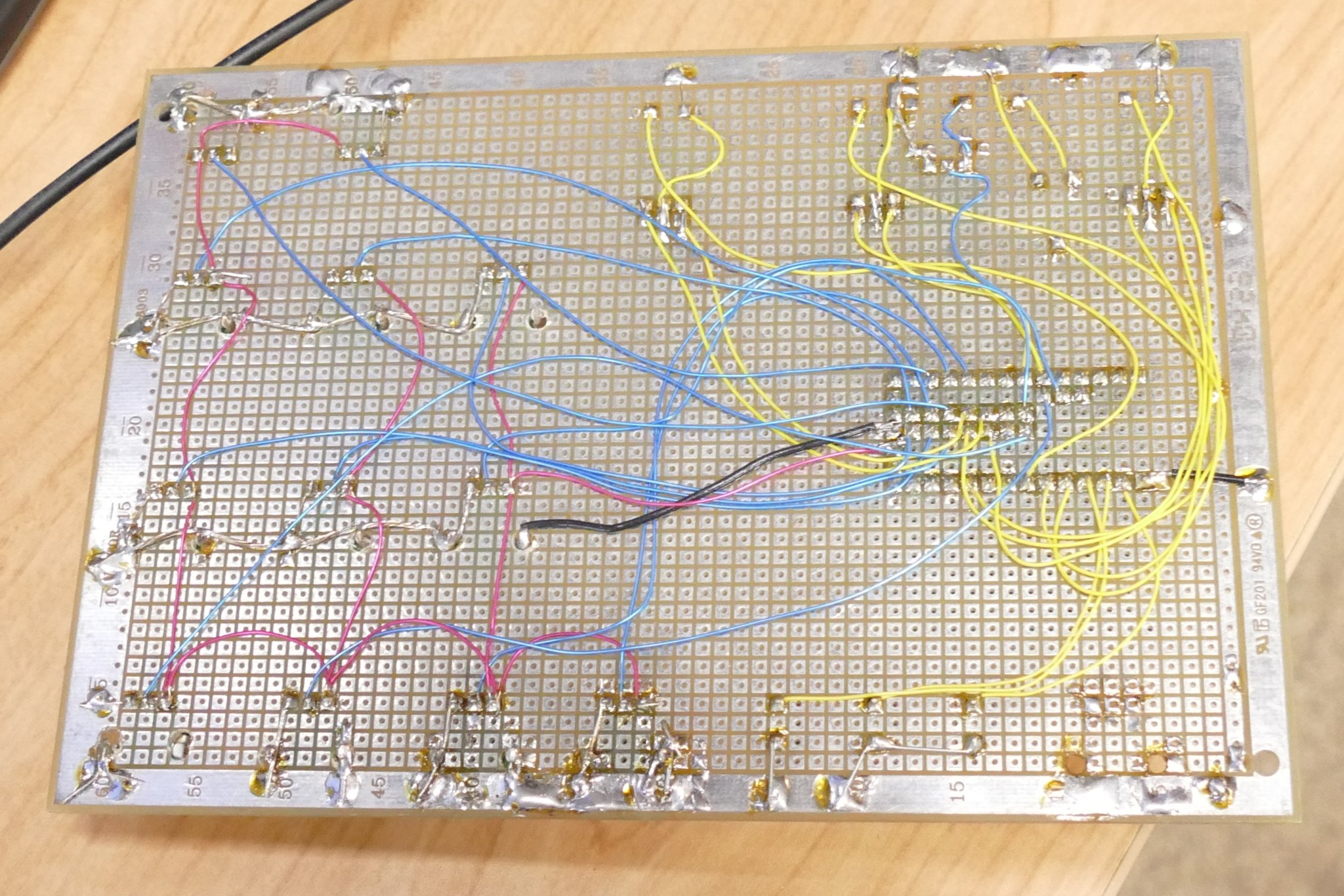

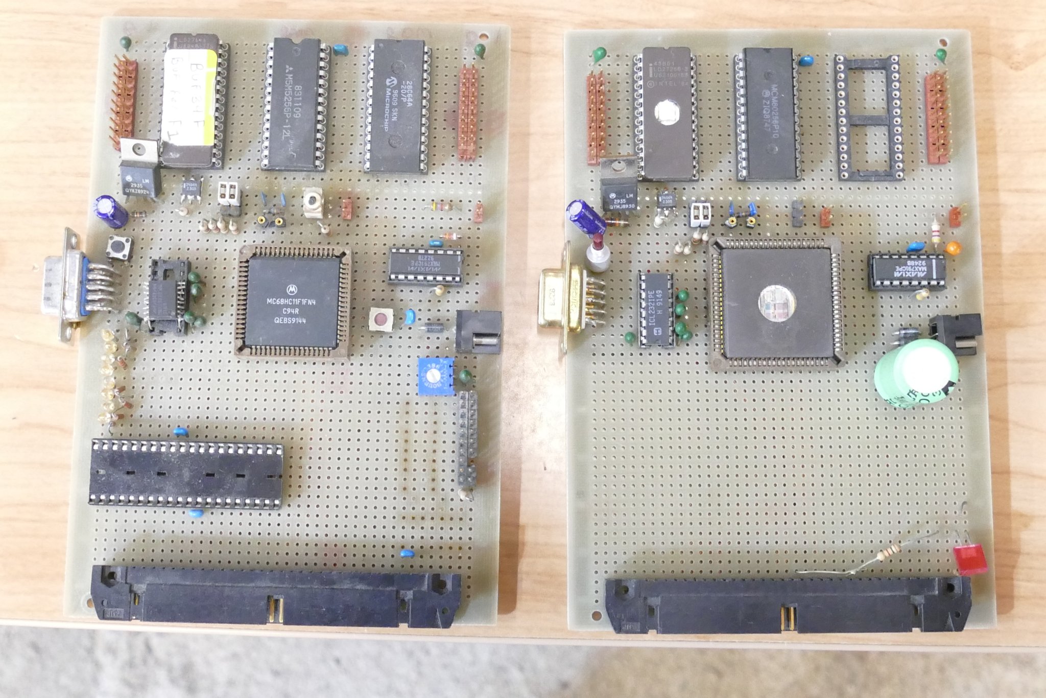

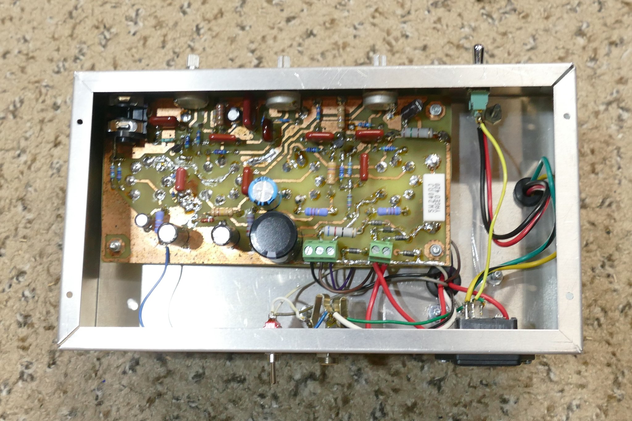

Sometimes I make a PC board, then hack it up Pease style, then trace out what I did to make it work, then make another and put it in a real case.
