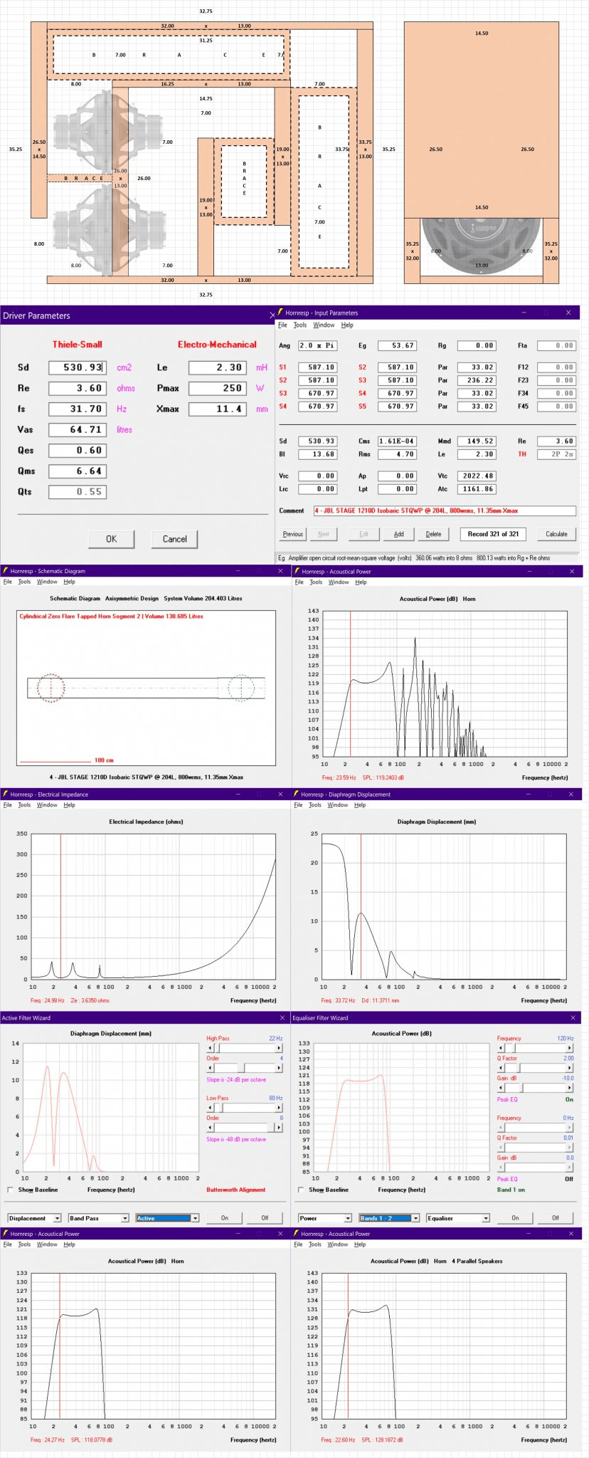

"Joferro
I just see that you posted a Horn diagram. My driver would have been mounted on top of the S2 arrow not inside the speaker"
I know that. I found the 1st pic that showed where S2 is located. The same principle applies whether using Nd, OD, or the TH function in Hornresp.

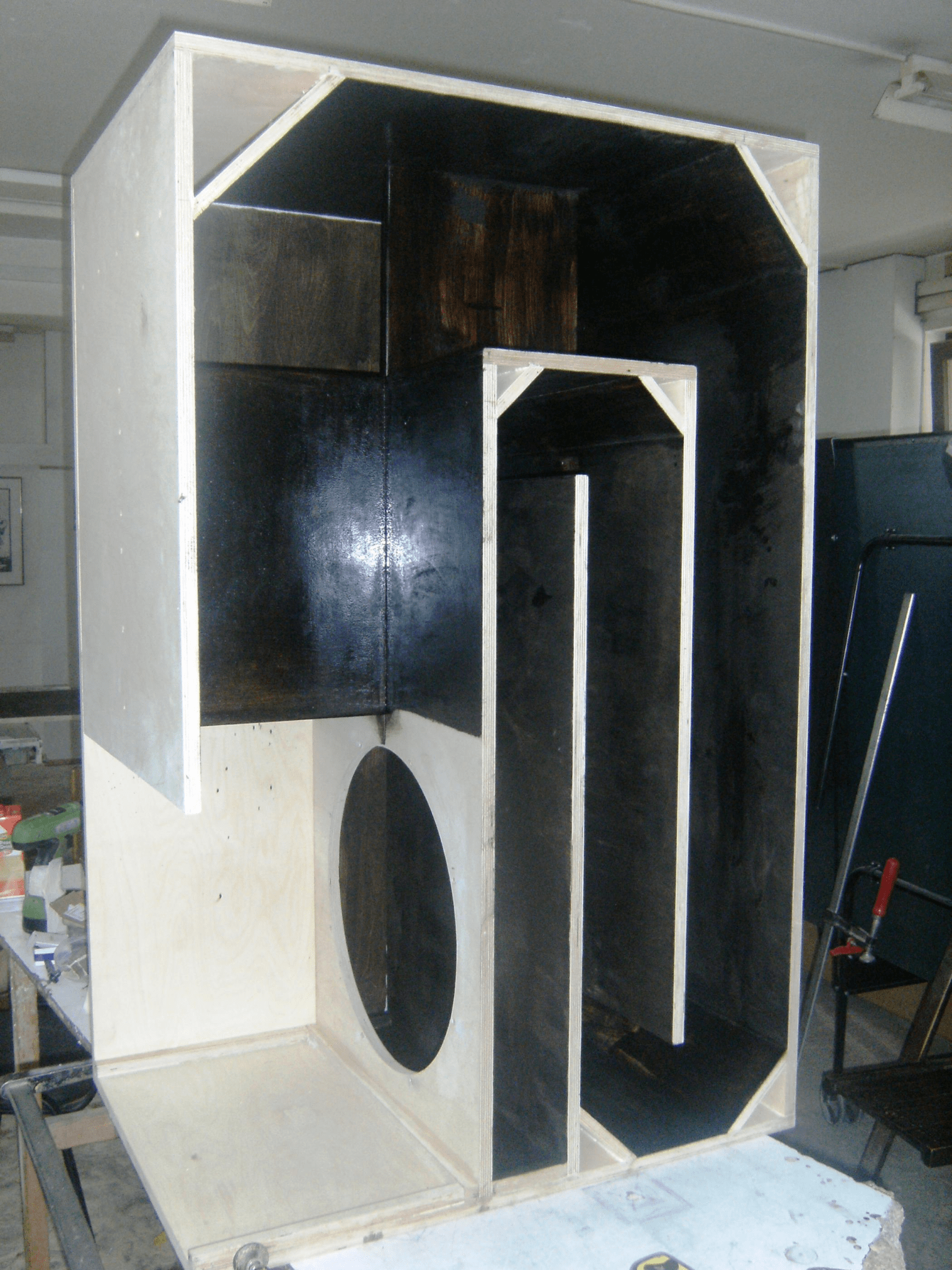

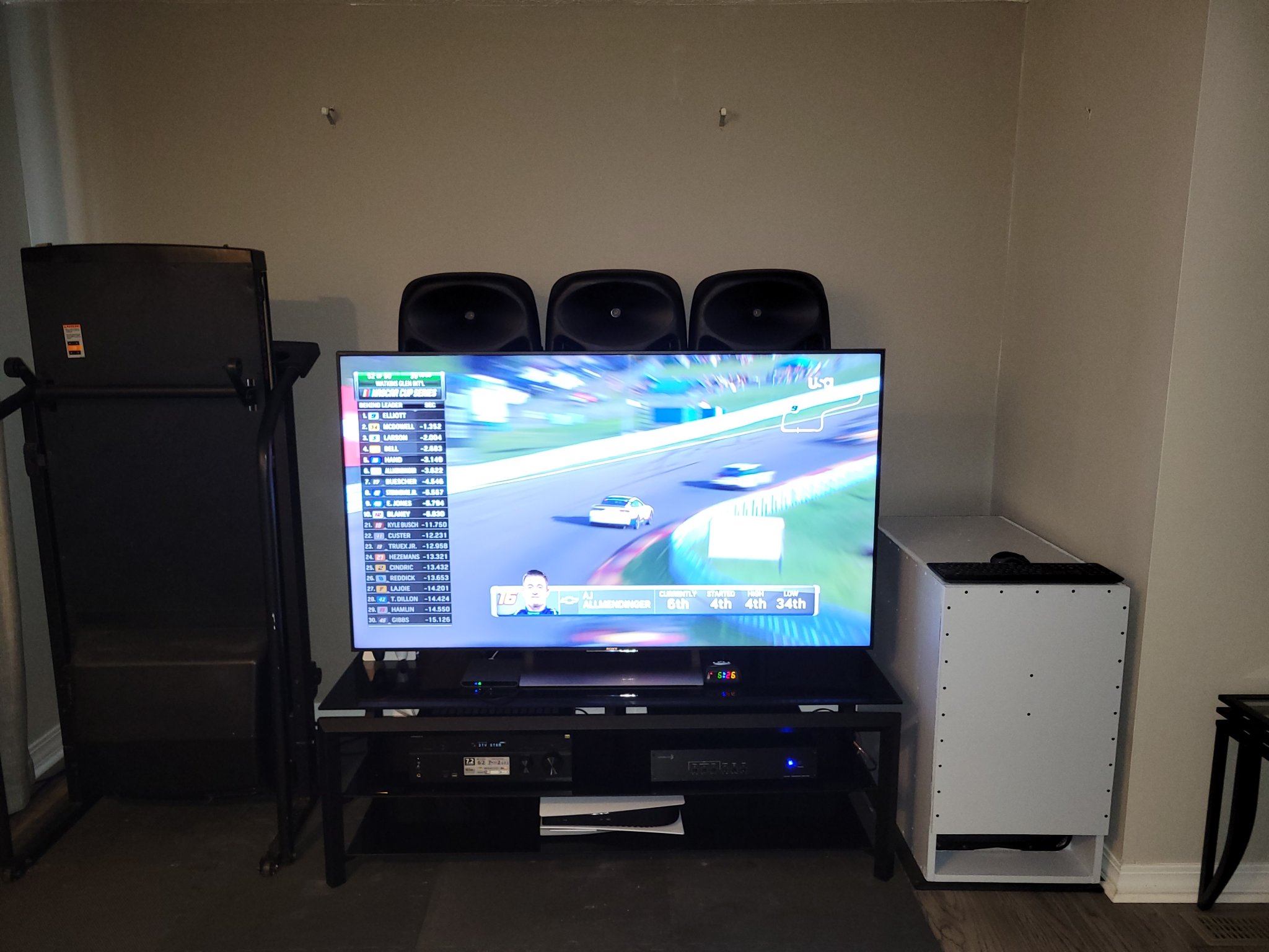

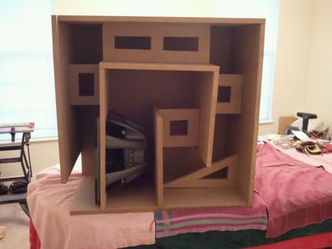

Hofmann's Iron Law...loud, low, small...pick 2. I chose low and small.That thing is a beast, although it doesn't look that big in the room. Why a negative flare instead of a positive one, what does that do?

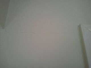

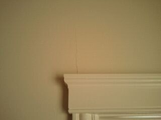

I built the least efficient tapped horn, yet I was able to crack multiple walls with 200 watts from a Yamaha HTR-5730 AVR in 2012. 12 years and still going strong.
Positive flare = loud and big.
Straight flare = easiest build, no angles.
Negative flare = small and low.

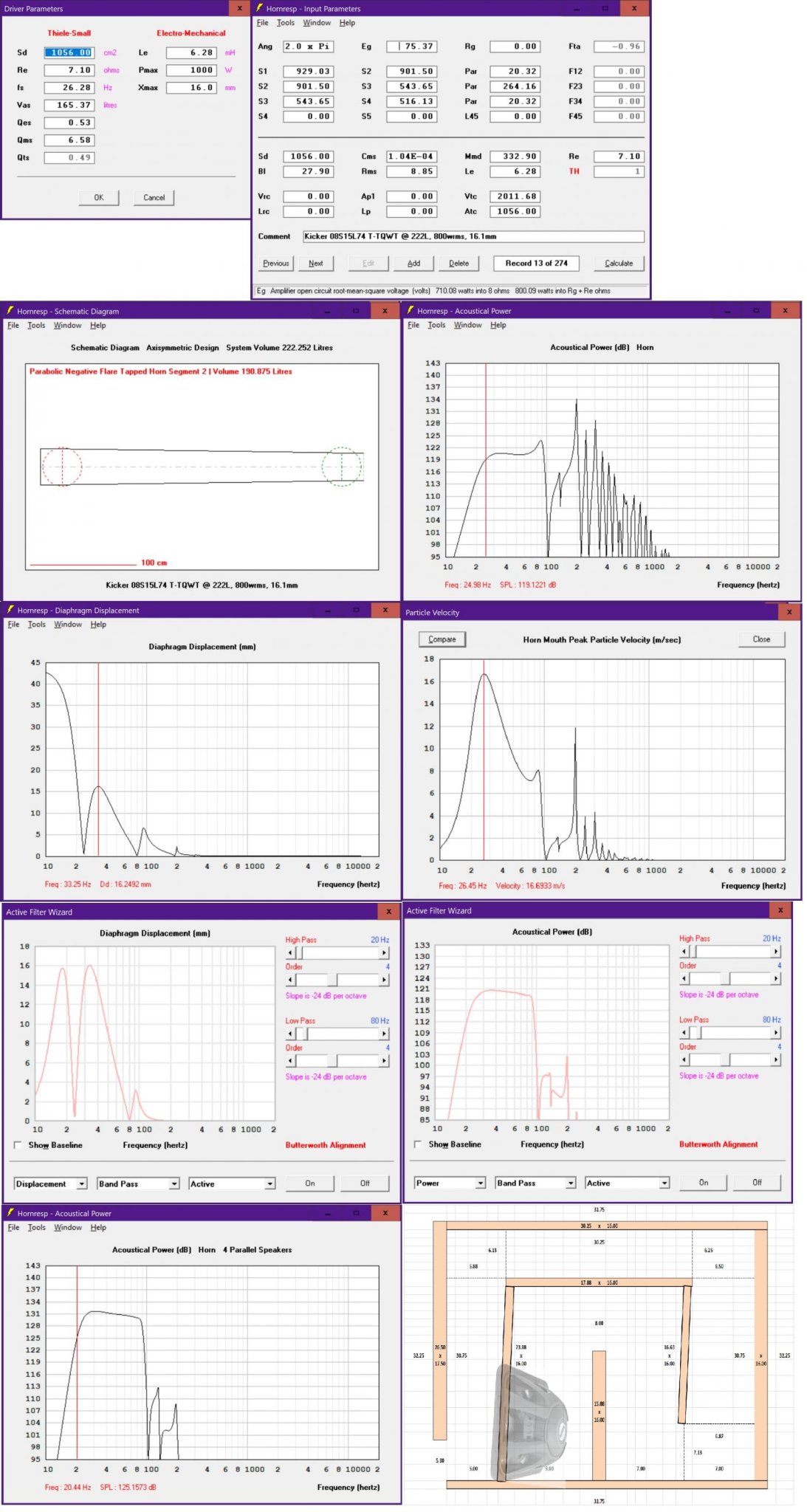

With the stepped feature in HR, you can model straight (no angles) positive and negative flared tapped horns. I think the most segments you can have is 3 when modeling a stepped TH.
This is an example of stepped positive flare TH. NEVER use corner reflectors. They take up volume and lower the efficiency. See the SS15 thread regarding corner reflectors.

My home theater sub is a Tapped-Tapered Quarter Wave Pipe or Tube, basically a negative flare tapped horn.
I want to say bjorno came up with T-TQWT. He's got a million HR models in the Subwoofer thread.

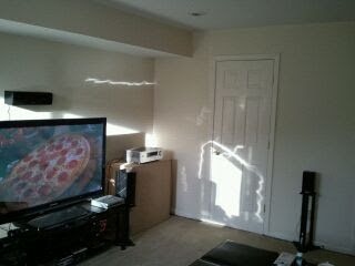

Reading back, I notice that TO is talking about a studio apartment. That does limit some options, I think it's quite important where you want to place the subwoofer(s). Fond as I already am of the Ripole concept, being a dipole they do need room behind them.
I've found out the hard way that just shoving a subwoofer in a corner is not the best idea and the intended placement has a lot of influence on which design will work best.
Positioning is everything!I've found out the hard way that just shoving a subwoofer in a corner is not the best idea and the intended placement has a lot of influence on which design will work best.
Interestingly the best position for a single Subwoofer in my strongly dampened listening room was - the corner! Tried a lot, you have the least SBIR effects there. With 2 woofers it was centered front and back. Now I'm useing a single array with 4 on the front.
