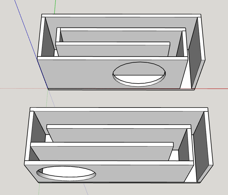

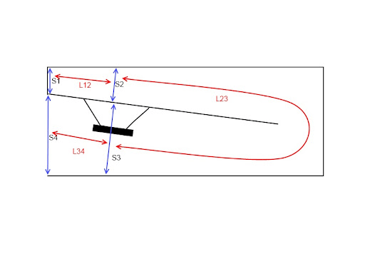

I can agree that the position of the driver might be an issue when there is no compression chamber in a TL.
With the example below, I don't see where there would be major difference in performance between the 2 enclosures.
Mount the driver on the 2nd panel of each enclosure and there would be a HUGE difference in performance.

Yes, cause that's all a TL is...a BR with a fancy port.
A BR by definition has no eigenmodes, a TL differs in that it does. Your statement is balderdash.
All that does is show that you do not have any idea what driver offset (Zd) brings to the party. This was a key finding by MJK in the early 2000s. It dramatically changed the landscape of TL design.
Look at 3 x Fb through 5x Fb. A miracle occurred 😀. 3x Fb is no longer resonating and 4x Fb is no longer a cancelation notch. instead you have bandwidth out to the 5 x Fb resonance and cancelation centered at 6 x Fb
dave
Ok, you getting way too technical for me.
I totally understand driver offset. I've modeled plenty of OD functioned enclosures in HR. Most of the time, I can get the same response without using the OD function.
MOST of the time, the driver's position does not affect the response in a TL or BR enclosure. The driver's position is CRITICAL in modeling a TH, TH1, etc function enclosure in HR.
In SIMPLICITY, TL's and BR's are direct radiator enclosures with a port/vent/passive radiator.
TL's NORMALLY have positive and negative flare ports.
BR's NORMALLY have straight flare ports or passive radiators.
You can model a straight flare TL enclosure the exact same way you can model a BR enclosure HR.
I provided the link where someone built and measured a TL and then removed part of the line and the BR had a better response, however they were still the same enclosure externally and volume wise internally.
Tech people wonder why non tech people think tech people are nerds with stuff like "A BR by definition has no eigenmodes." K.I.S.S.

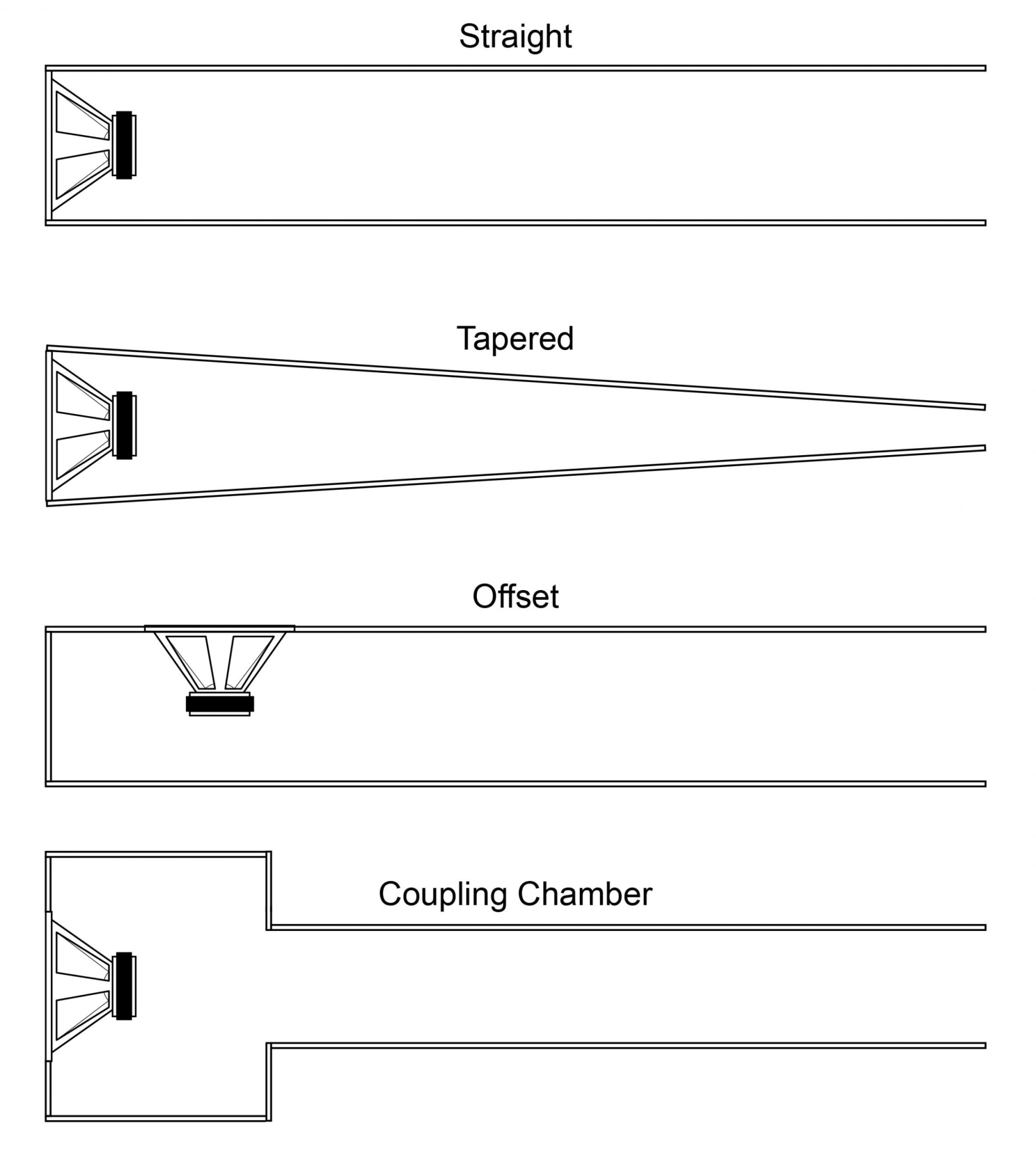

These all have 1/4 wave resonances based on the length from start to finish. So they are all ‘TL’ I suppose? (Even if the Fb is loosely based on helmholtz maths in the tapered and coupling chamber versions)??
Tru. However, buried driver enclosures are not direct radiator enclosures. There is a difference.
There are small to little differences between a BR and TL, especially when modeling the Coupling Chamber version of a TL enclosure.
