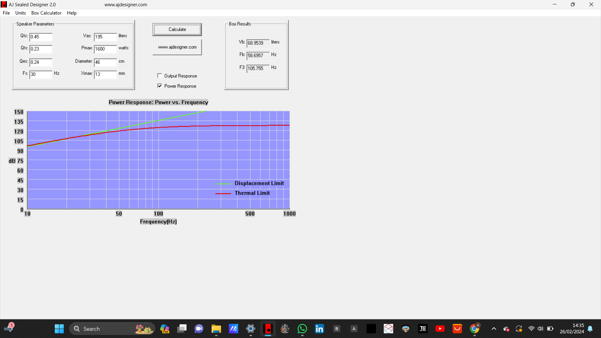

This is what a typical Pro driver "optimised for ported" will do in a small (around 70 litres) sealed box... 112 dB at one meter at 30Hz.... A pair = 115dB and in room corners with around 4dB of boundary reinforcement will give around 118dB at 30Hz....OMG!
That is of course insanely (dangerously!) loud " and never needed in domestic homes.
This driver is AES rated for, 1,600 watts (!) continuous power and has 13mm Xmax!
In real world domestic all you need is a typical low cost Hypex/ICE power amplifier / plate amp of 250 watts into 8 Ohms max...

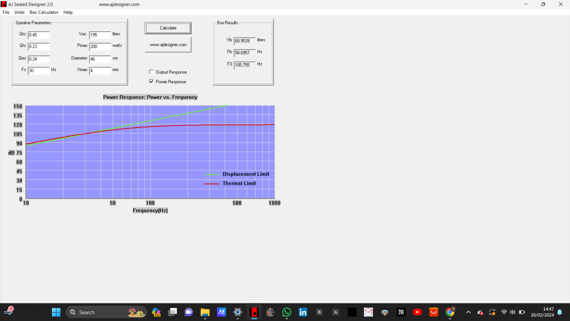

Here is what it does with just 200 watts (under 15% of max power) and never exceeding 4 mm cone movement (just 30% of Xmax) ... A single driver holds 105dB at 30Hz... A pair does 108dB and in room corners will exceed 112dB... Still waaaaay above most domestic requirements.
Reactions: 1 user
PS You can of course just scale this design/driver/loading down (or up!!) to suit SPL requirements.... Bedroom system will be great with a 10 or 12 inch driver in under 20 litres ie small sealed box just big enough to house the driver and around 20 cm to 30 cm deep.
