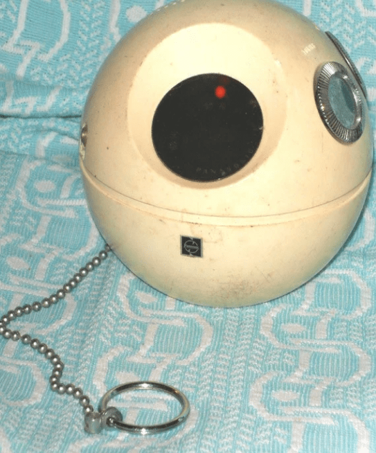

More than once I have been inspired to build something like this old radio my sister had in the 70's. Maybe out of concrete.

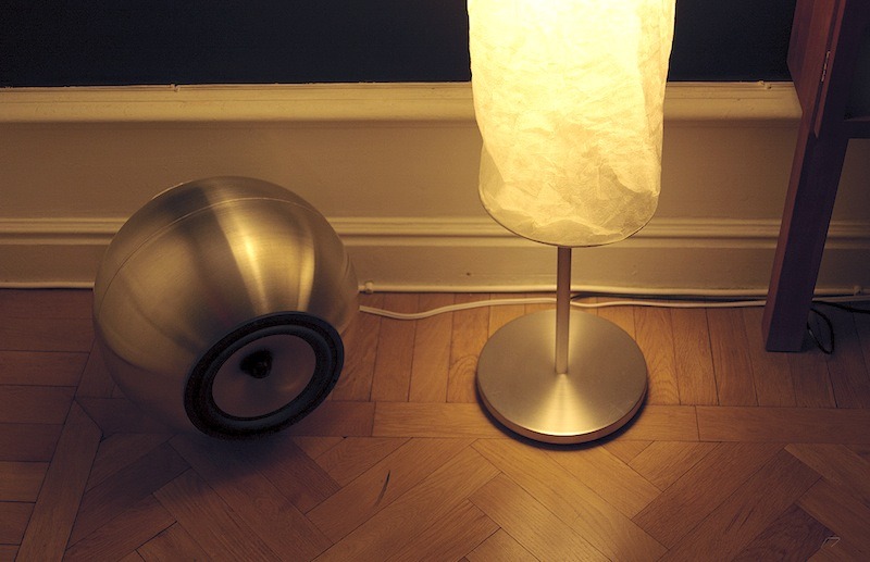

Sounds like a PV1D from B&W but I understand it's nog longer being made. Apparantly not that appealing altough it looked very promising to me. It it is a sphere type enclosure with two opposed 8" woofers, everything is in aluminium as I understand it. A 500W amp + DSP is onboard.

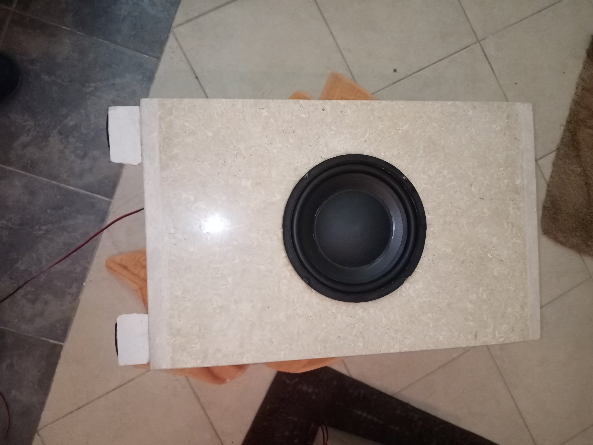

It's the best for me. And it's small and simple to build!
