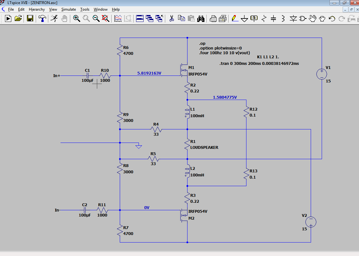

I have modified my bias adjustment and added a couple of source resistors and when fireing up the amp the speaker just let out a terrible fast pecking roar and the speaker started to smell burnt paper.

The speaker survived but sounds a bit harsh nowdays. It is a very cheap litle thing built mainly as an experment. But I like it and a will probably buy a new set of woofers once the amp is up and running properly. Now I have installed a 47 ohms power resistor in series with the speaker so it should survive a couple of seconds longer when playing a 200 watt 100 hz squarewave.
I cant figure out why it misbehaves??? Any suggestions or ideas???

I don't recall if your PS is fully linear or regulated, but if the former then you might consider using a variac to control the mains voltage, ergo the PS output voltage, for inspection work.
Also, an old HAM Radio trick is to place a load resistor in a jar filled with mineral oil to increase the effective heat dissipation capacity, ergo power handling. I no longer recollect the rules of thumb but i'm guessing that a 5x to 10x power factor (not sustained for long times) could be achieved. So a junk box 10 - 25 Watt ceramic resistor might be able to handle your load for brief testing runs... try not to boil the oil 😱
Also, consider returning to the previous circuit topology for some baseline tests.
Sorry, not much specific help with the spinning currents but maybe you can spare those favorite speakers from the BBQ.

mrothacher: You could not get both current and voltage gain from your original zirclotron because of no groundreference. As Nelson Pass said you could use a input transformer with split secondarys to use two groud connections. One for each half of the circuit.
I have been fooling around with the same kinds of circuits the last 4 years.
The Zenitron is a way to isolate the source pins from the drains in order to get voltagegain.

The original zirclotron seems to have a voltage gain of
approximately one. It also has current gain.
True, but Its difficult to get more voltage gain than one without dual grounds, or some other way to stop the 100% local feedback you get through the powersupplies.(in the Zenitron its one of the things that the chokes are doing)

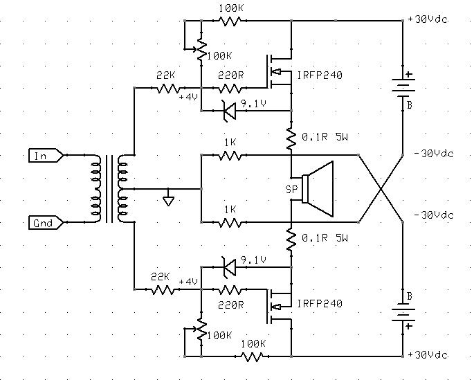

What about this basic Circlotron?
Greets:
Tyimo

I built something like this. Today I would use 24 or 36 volts switched power supplies instead of 15 volts like I did back in the day.

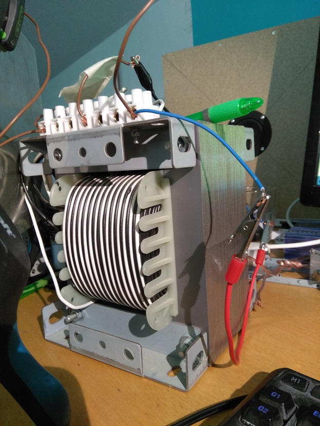

The chokes are two (bifilar) windings on a large transformer core. It does not need to be air gapped.
It is basically a Zen/SoZ Circlotron Long Tailed Pair.
