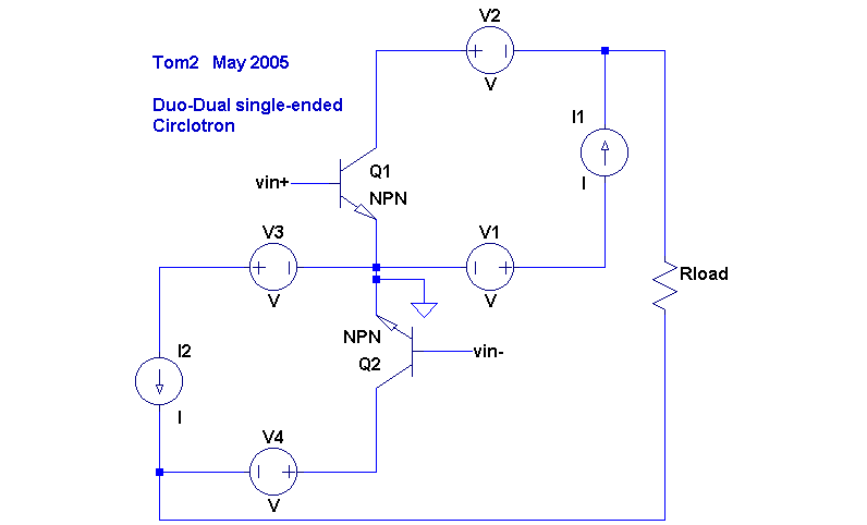

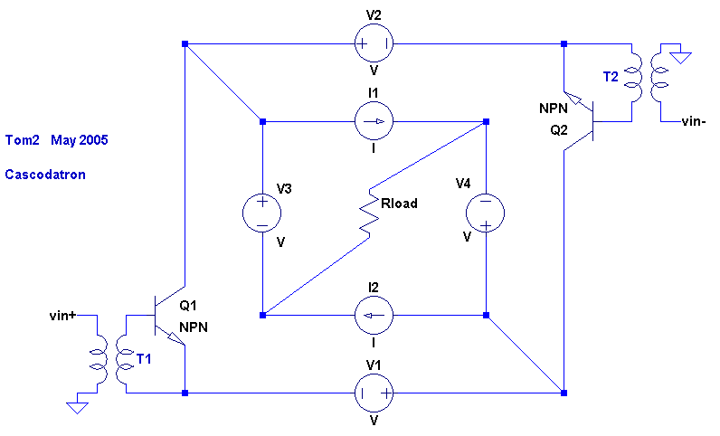

How about using more than one circlotron in a circuit.
Cascodatron???
Tom
The QUADITRON was a try at that. Im working on some extremly complex versions with multiple ouput transformars and chokes. I dont know if it ever will become anything usefull, but its always fun thinking about something.
Circlomanen,
Here are two ideas for your enjoyment.
Yes I agree, multiple circlotrons get very confusing.
The cascodraton idea (or whatever you want to call it) sometimes makes sense and other times seems completely wrong to me.
One could have complementary inner devices or currents rotating in the same or opposite directions. Connections between the different circlotrons.......?????
Have fun!
Tom
Tom
When a dextro (clockwise) rotating circlotron hooks up with a levo (counterclockwise) rotating circlotron, does one get no sound or infinite sound? Will it have to be aligned with the earth's magnetic field?
Just curious,
LarryO
