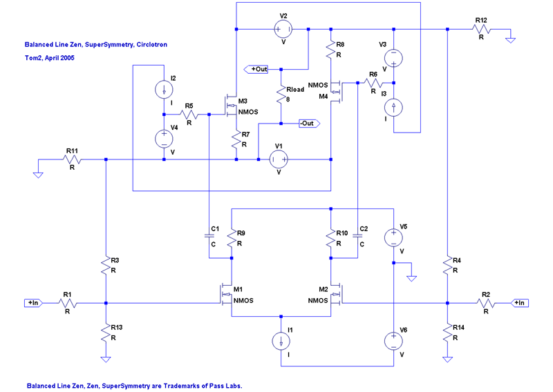

Your zenitron circuit puzzles me.
Since the power signal current can only circulate
through the load, power supplies, power mosfets and 2200 uf caps, --- thus this implies the power signal current increases on both the positive and negative parts of the signal through both power mosfets (since the mosfets are biased on). IMHO one of
the power mosfets for a given positive (or negative for the other mosfet) part of the signal seems to work backward to what it should. In other words the KVL loop of the power supplies, power mosfets, load and 2200uf caps derives what voltage should be across the power mosfets and thus one mosfet should be decreasing in voltage across it yet the current though it is increasing??????
IMHO the difficulty I am having understanding the zenitron, SuSy circlotron circuits and x100 circuit is the circuits seem to need or have two or more ground reference points. My brain keeps telling me the circuits can have only one?????
I can't get it through my brain on how to drive a circlotron with volatage gain in a balanced way without resorting to input transformers as a way to isolate the two circlotron halves from having ground reference problems. Maybe I just don't see it yet.
Perhaps more circlotron KVL grokking needed for me!
Your aleph, resistor, lightbulb circlotrons seem ok to me.

It only has one ground reference point.The exact middle of the circuit.IMHO the difficulty I am having understanding the zenitron, SuSy circlotron circuits and x100 circuit is the circuits seem to need or have two or more ground reference points. My brain keeps telling me the circuits can have only one?????
The amp kind of "flaps its wings" in opposite directions with the middlepoint being still all the time.

Circlomanen,
The zip file contains two schematics.
One circuit uses a balanced line zen input for voltage gain.
The other uses a reflected cascode front end for voltage gain.
Both use the same circlotron output stage buffer.

This schematic uses the balanced line zen for
the voltage gain in the front end and a circlotron
buffer stage for the output.
Its a very simple circuit.
I use Linear Technologies Switcher Cad as a
schematic drawer. The schematic has been resampled
down to 800x600. Hopefully its readable.
Tom

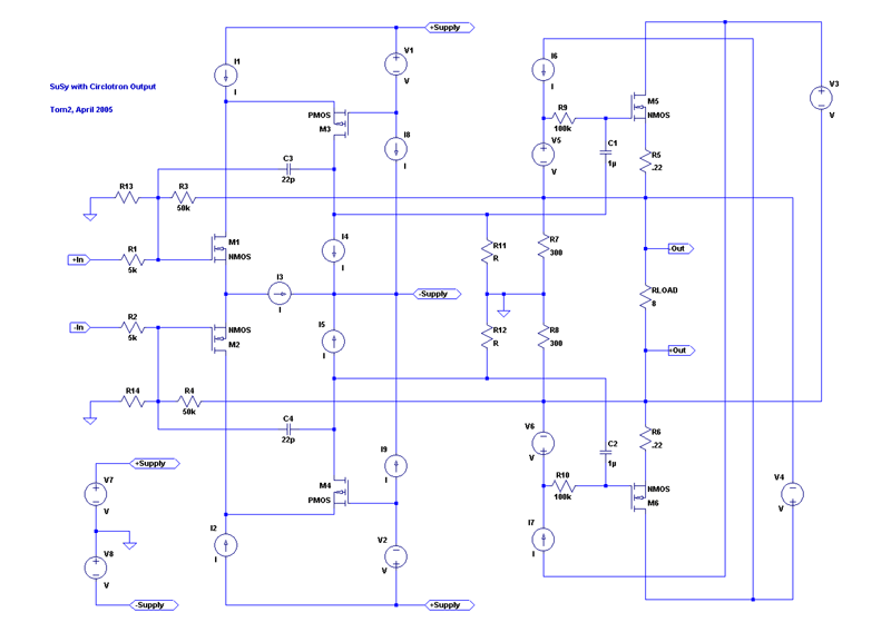

Thank you for posting the pictures!
Nice looking.Especially the one with folded cascode.

No not much! You should go ahead and built it! To make it easier you should build it with 9 volt batteries and smallsignal- transistors. 2SK170 and BC 556 in the front end, and IRF 510 in the output. That way you will probably get a lot of different ideas and new solutions to eventual problems.( And its cheaper to let the magic smoke out on these.) I think its the high level of nessesity of understanding and solving the problems you encounter when building an exprimental design,- that is the best way to learn. All these simulationprograms makes it to easy to check out how something work. You get lazy and never push yourself to do that extra thinking to really solve the problem in a clever way.Tom2 said:This schematic uses a balanced reflected cascode
front end for voltage gain and the same circlotron output
stage like the previous schematic.
There is obviously a lot of work to do on these schematics.
Tom
I have burnt a lot of resistors, transistors and a speaker on my long and winding road to these designs. But I had a lot of fun.🙂
