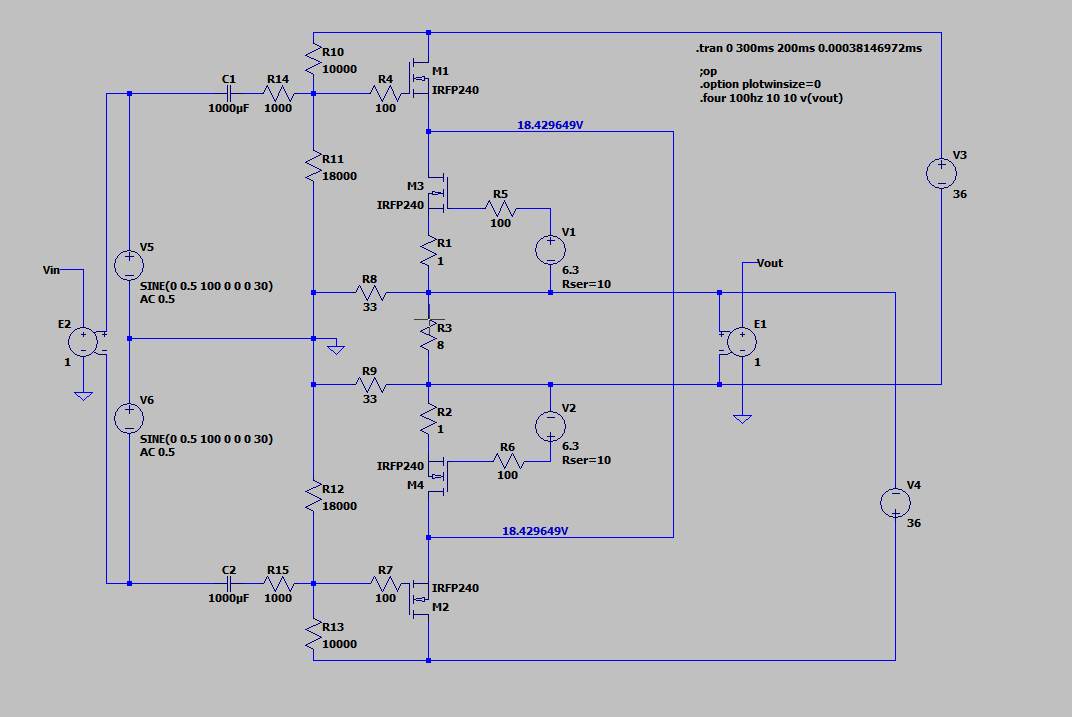

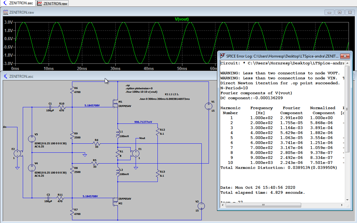

The inductor is there to break up the feedback loop that otherwise turn the devices into source followers. It creates voltage gain.
It is a SoZ V.7 with super symmetry feedback from the alternative Circlotron universe, where you don't need the bottom CCS or high power resistors.
The schematic posted above is just taken from my rather hazy memories from when I built that amp.
It is not optimized in any way. I would definitely want to spend some quality time in LTSpice before committing to real devices, power supplies and heat sinks.

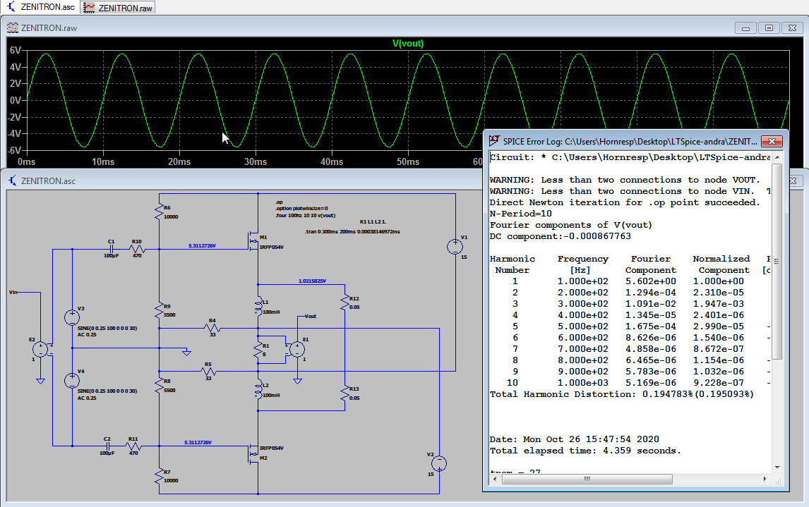

any advantage compared to a common source circlotron that don't need the inductor to have some gain?
How do you design a single stage circlotron without inductors or signal transformers that does have voltage gain?
Can you show the same for the version with the inductor load? How much voltage gain do you get with the inductor load?
(I have to admit that I don't quite get how/why the inductor or resistor causes any voltage gain, but I am sure I'll figure it out somehow.)

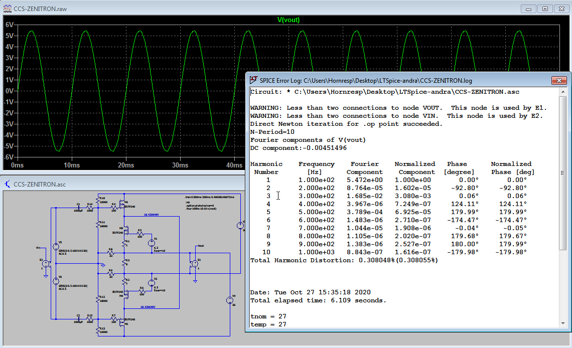

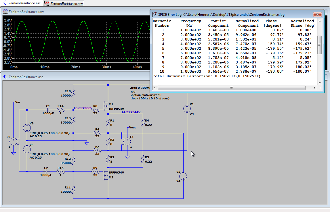

I have never had the chance to compare them side by side. Both should be third harmonic dominant since both are balanced and has some second harmonic cancellation mechanism inherent in the design.
The Zenitron amp design was my try at making a simple one stage circlotron with voltage gain.
It was many years since I last had a listen to the Zenitron design. I have scavenged my ugly rats nest build for parts, but I would like to build a new Zenitron based on a matched pair of IXYS IXTH16N20D2 depletion mode devices to simplify the bias circuitry and the super symmetric feedback.

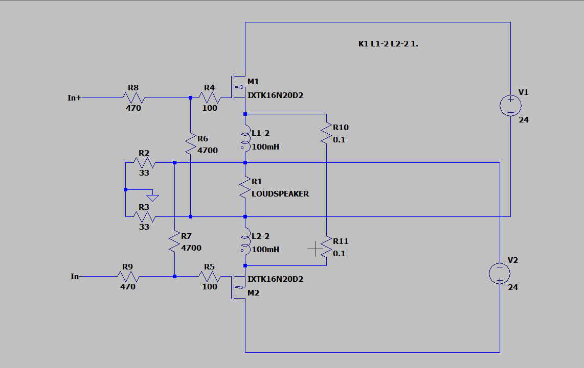

What does it take to drive the inputs of the Zenitron? Does it need a source with a low-impedance output?

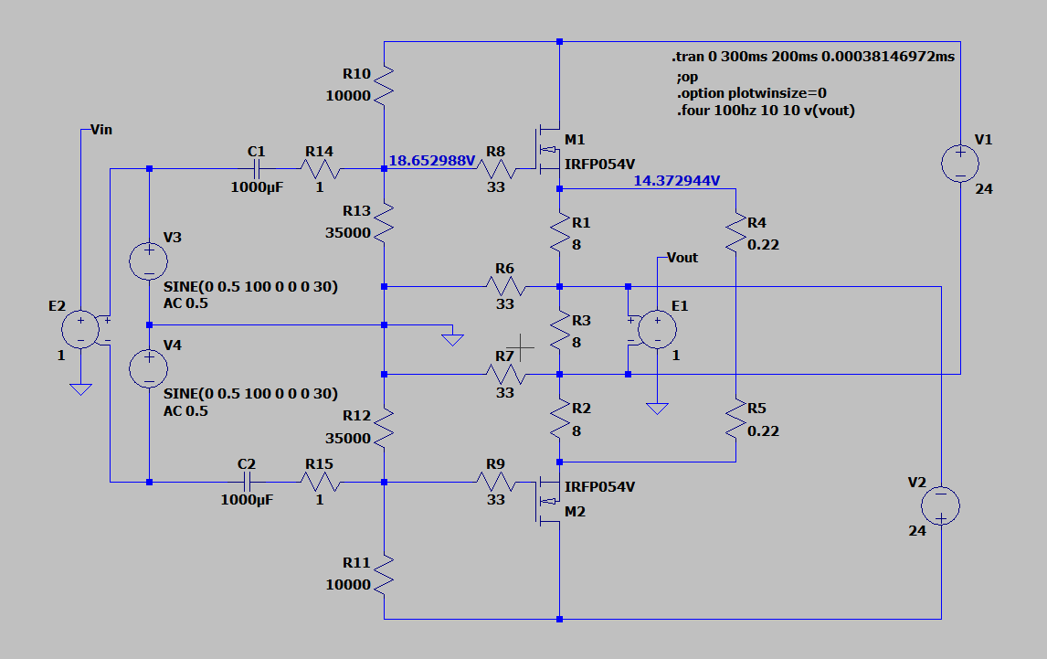

The input impedance can be set to other values dependent on the devices, the intended frequency range and what kind of preamp you have.
The IXTK16N20D2 does have a rather hefty gate capacitance and I would guess they need quite low resistance in series with their gates to avoid excessive distortion in the high frequency range.
It is possible to use constant current sources or modulated current sources instead of a large bifilar winded coil. The CCS would need at least as much voltage as the active devices, which kind of detracts from the simplicity and efficiency of the design.
The Zenitron is a Zv7-T http://www.firstwatt.com/pdf/art_zv7.pdf but "circlotronified" to avoid the bottom CCS and the input capacitors of that design.
What Nelson Pass writes in the Zv7 article applies to this design, with the exception of the bottom CCS.

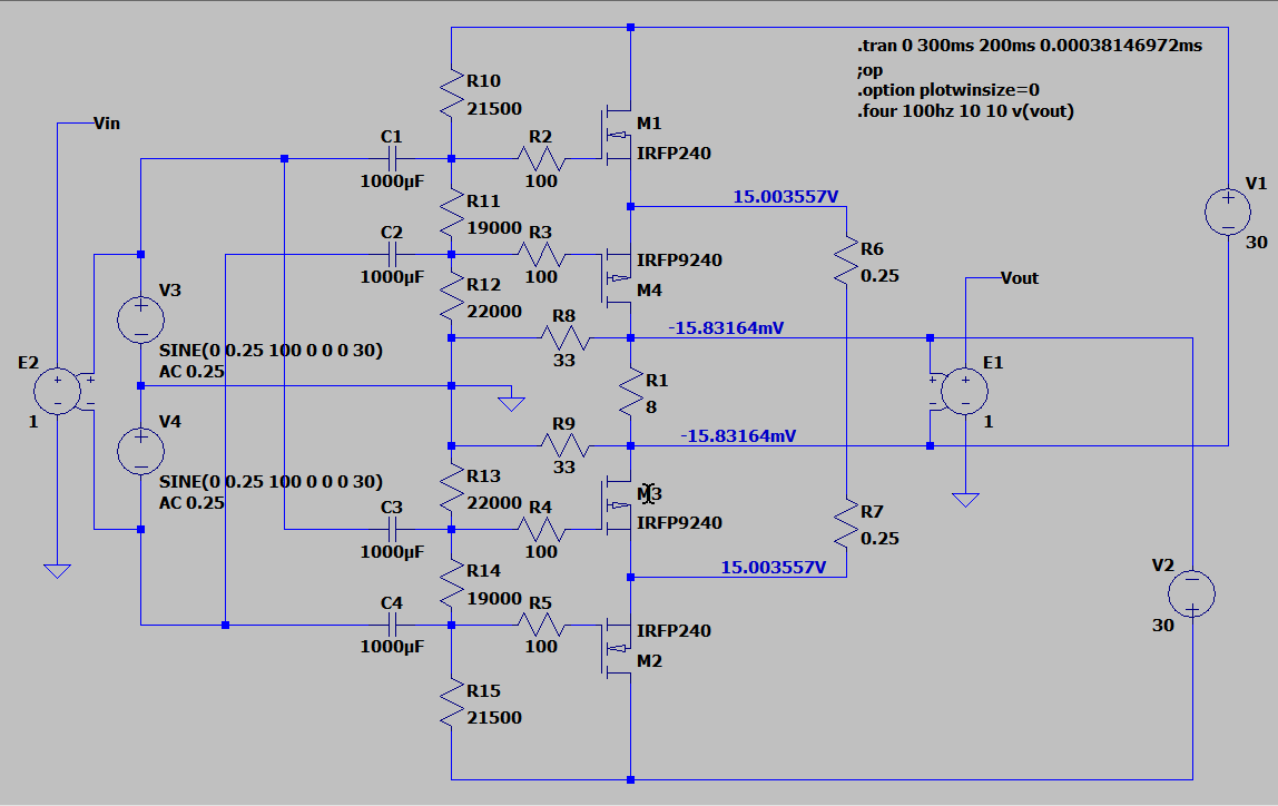

Let's take your circuit in #111.
Assume we bias at say 1.2A, the IXTH16N20 needs a Vgs of ~ -2.4V.
So this is what the CCS has as total headroom, while inputs can still be DC coupled.
We can take a IXTH20N50, which needs almost no source degeneration for 1.2A.
So the entire 2.4V can be used as Vds, which is sufficient according to datasheet.
And then of course the mid-point of the speaker (or the 2x 33R) does not have to sit at Gnd.
It can be at a constant negative voltage, and the CCS will get more headroom.
And 2x depletion NMOS is for me simpler than winding inductors.
Hopefully I have not missed anything really stupid without thinking it through thoroughly,
Patrick

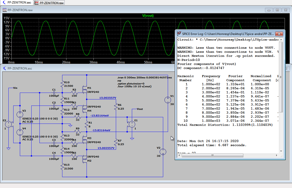

As to the high capacitances of the 16N20, one solution can be to use another 16N20 as self-biasing cascode.
The lower (driver) NMOS will then get a nearly constant 2.4V Vds, which also looks OK from datasheet.
So 6x 16N20 in total per circlotron.
Patrick
