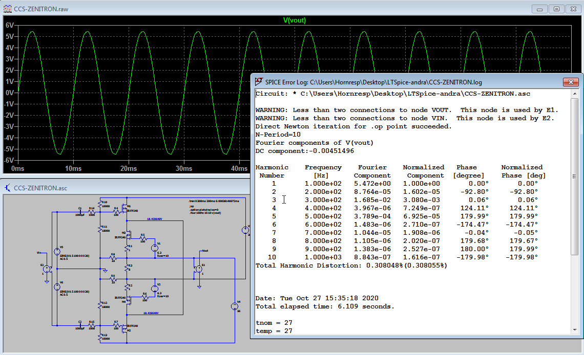

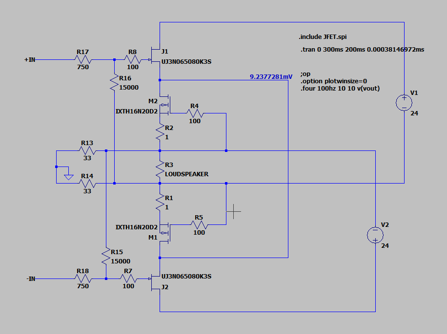

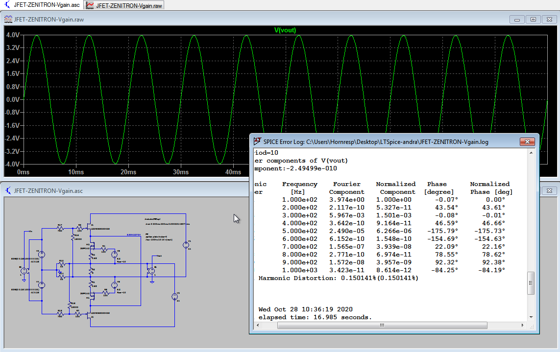

I have been exploring your CCS loaded Zenitron idea a bit.
I don't have any spice files for IXTH16N20D2, and I believe the UnitedSIC JFET UJ3N065080K3S is a better candidate for this application.
It seems to hit 12 watts output power at the onset of clipping. It clips very soft and gradual, much like a triode amp.
The two CCS could be made with IXTH16N20D2.
We agree on that certainly.
The Vgs limits your maximum output for a given gain.
No such issues in a follower.

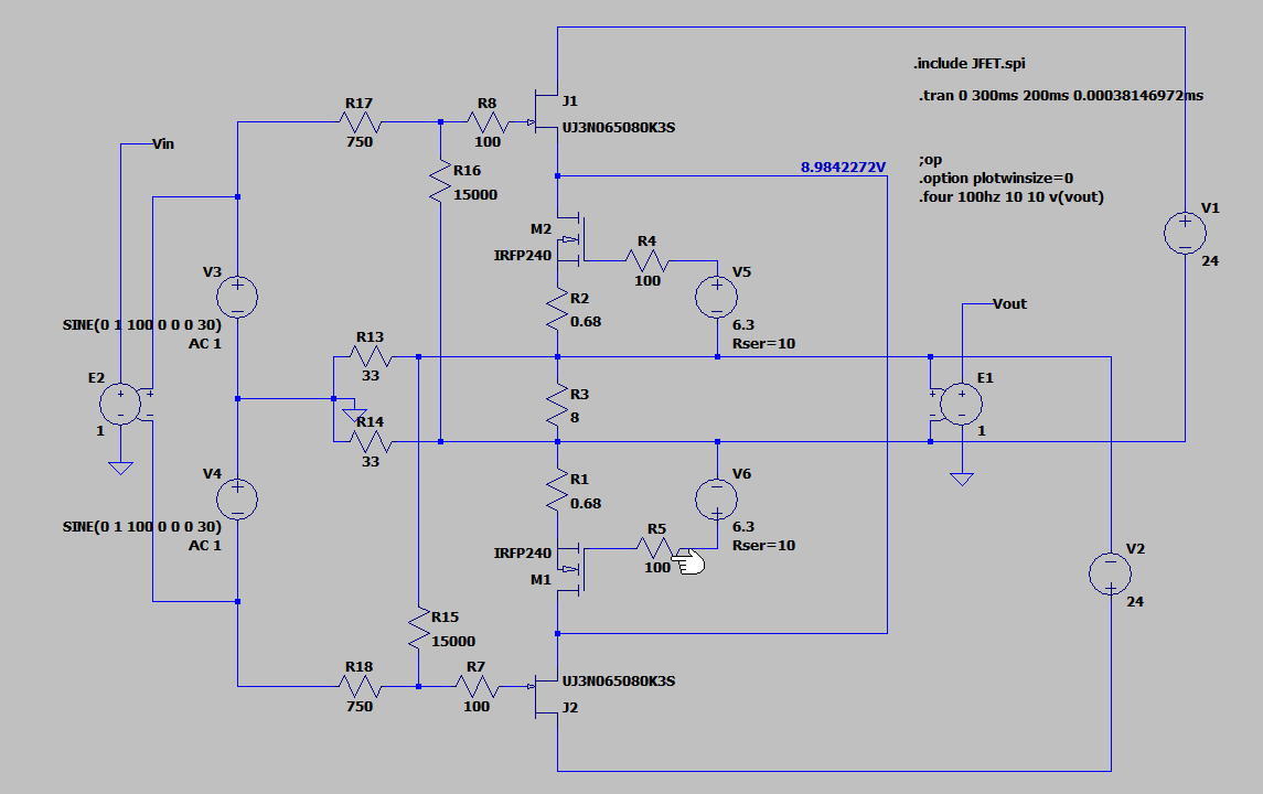

Some thoughts perhaps on real-life implementations.
The power JFET is loaded by a CCS, and hence Vgs does not need perfect matching.
However, as bias is only determined by the two CCS’s, they have to be matched and stable at all times.
Any mismatch will readily manifest itself into a DC offset.
Those IXYS depletion MOSFETs have a significant positive tempco at bias.
So certainly not ideal for the job.
Here I propose two variants, using Renesas lateral MOSFETs (2SK1058).
These have a negative tempco at bias and are therefore self-stabilising.
One can also add an additional self-biasing circuit as shown on the RHS.
In that case the two NPNs for the current sources should be matched and thermally coupled.
For example, Toshiba HN1B01FU-GR.
Patrick

> I thought you suggested to replace the United SICs with the Renesas
You need a FET with a Vgs of -10V or so at bias.
2Sk1058 certainly won't do.
Patrick

So a quick attempt in Spice.
(You need to remove the ".txt" from the .cir filename and place in the same directory as the .asc files.)
Works OK, but rather poor efficiency, even compared to other P-P Class A.
And bandwidth limited to 20kHz -3dB; 10k load per phase to the source.

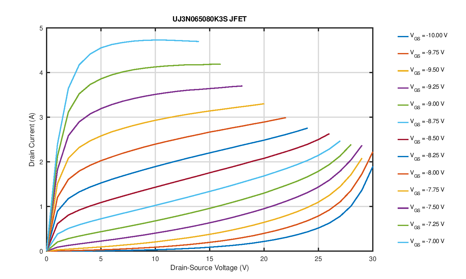

...and I believe the UnitedSIC JFET UJ3N065080K3S is a better candidate for this application.

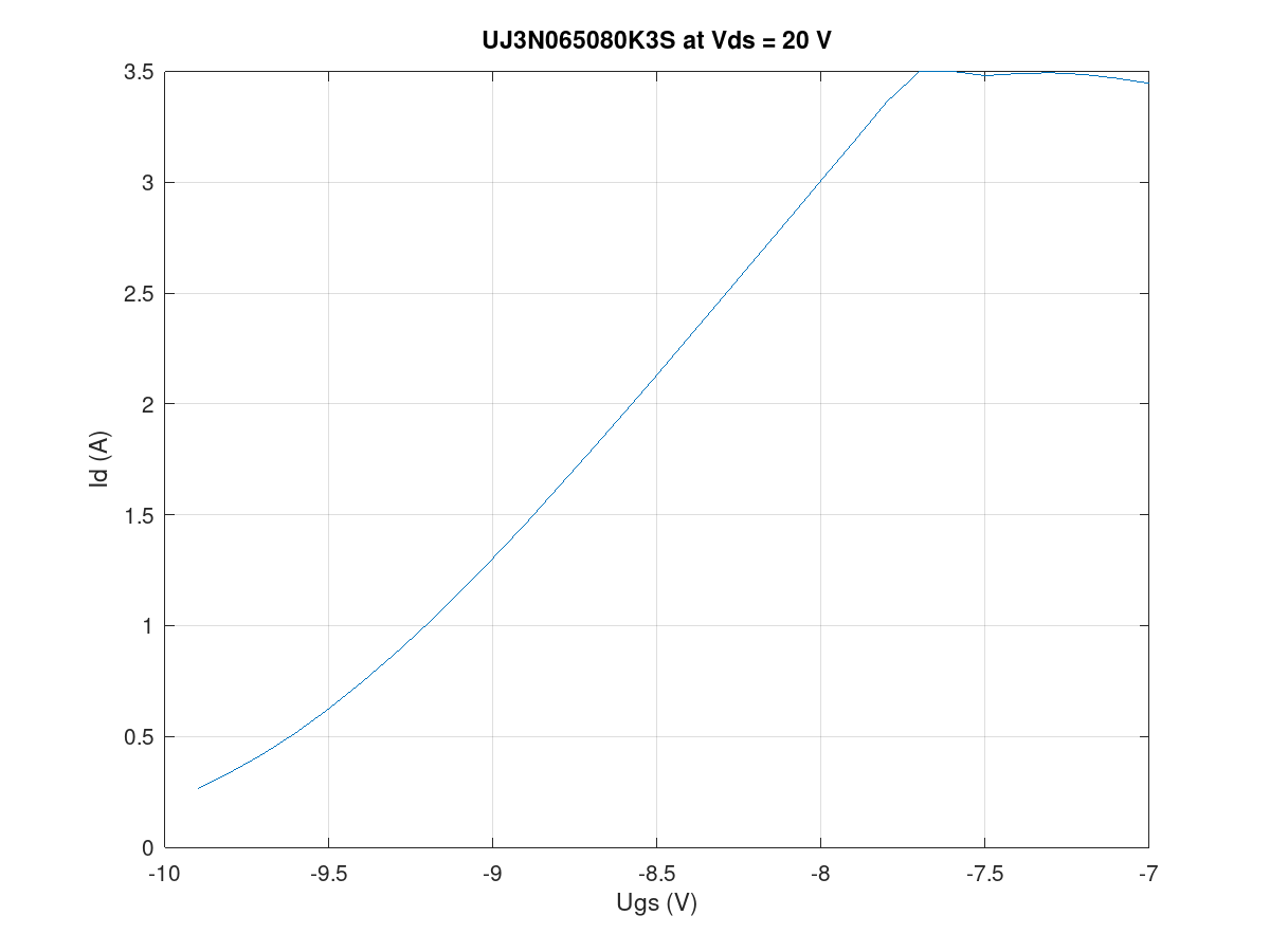

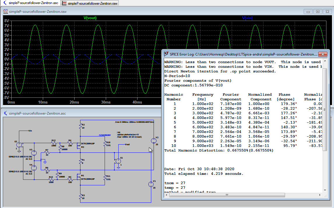

I ran the UJ3N065080K3S through the curve tracer to see what the curves look like in reality, as the datasheet curves do not cover the typical "audio amplifier range" very well; see attachment. The flattening of the curves at high current is due to the self heating and negative tempco. However, I am not sure what's happening at 20 V and higher... is this normal for a JFET? What is it?

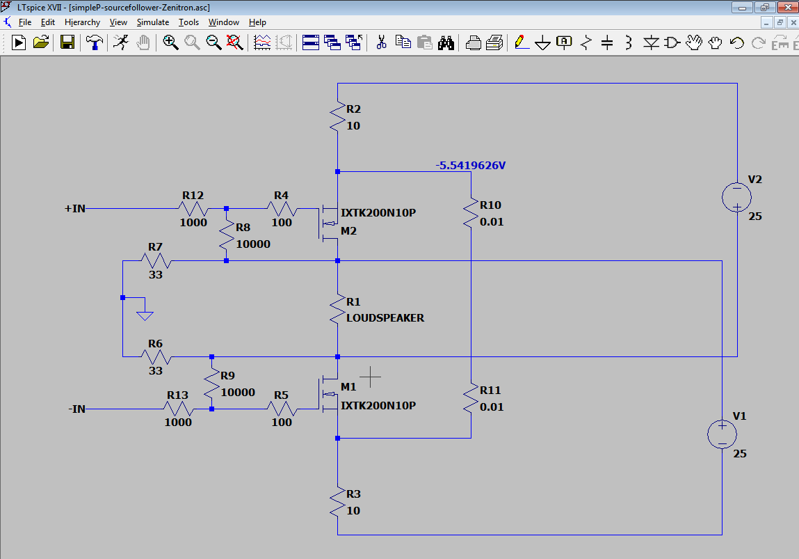

I tried to simplify the power resistor current source, enhancement device, super symmetrical Zenitron as much as I could, and this is where I ended.
If one only needs a few watts output power, a fully balanced design, super symmetrical feedback, DC coupled in and output, and has a large stash of 24 volt switched power supplies laying around unused, then I guess this could be a fun design to fool around with.
Distortion drops substantially with higher voltage from the power supplies and more current through the devices.
I guess the UJ3N065080K3S would be best at 2A or higher.
This is very depended on how it is used but since this is the Pass Labs section of this forum I would argue that the sweet spot is around 15 volts drain to source and 0,5 to 1,2 ampere of current,
A nice smooth triody section of the curves - that is easy to "work the load line" for some distortion cancellation in simple one stage, low-to-non negative feedback single ended designs.
This looks more interesting. 🙂
Would you care to share your spice file ?
