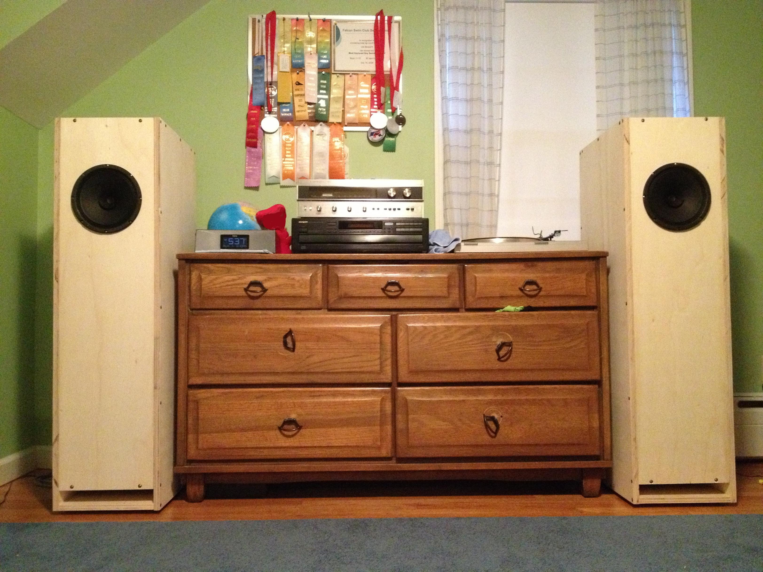

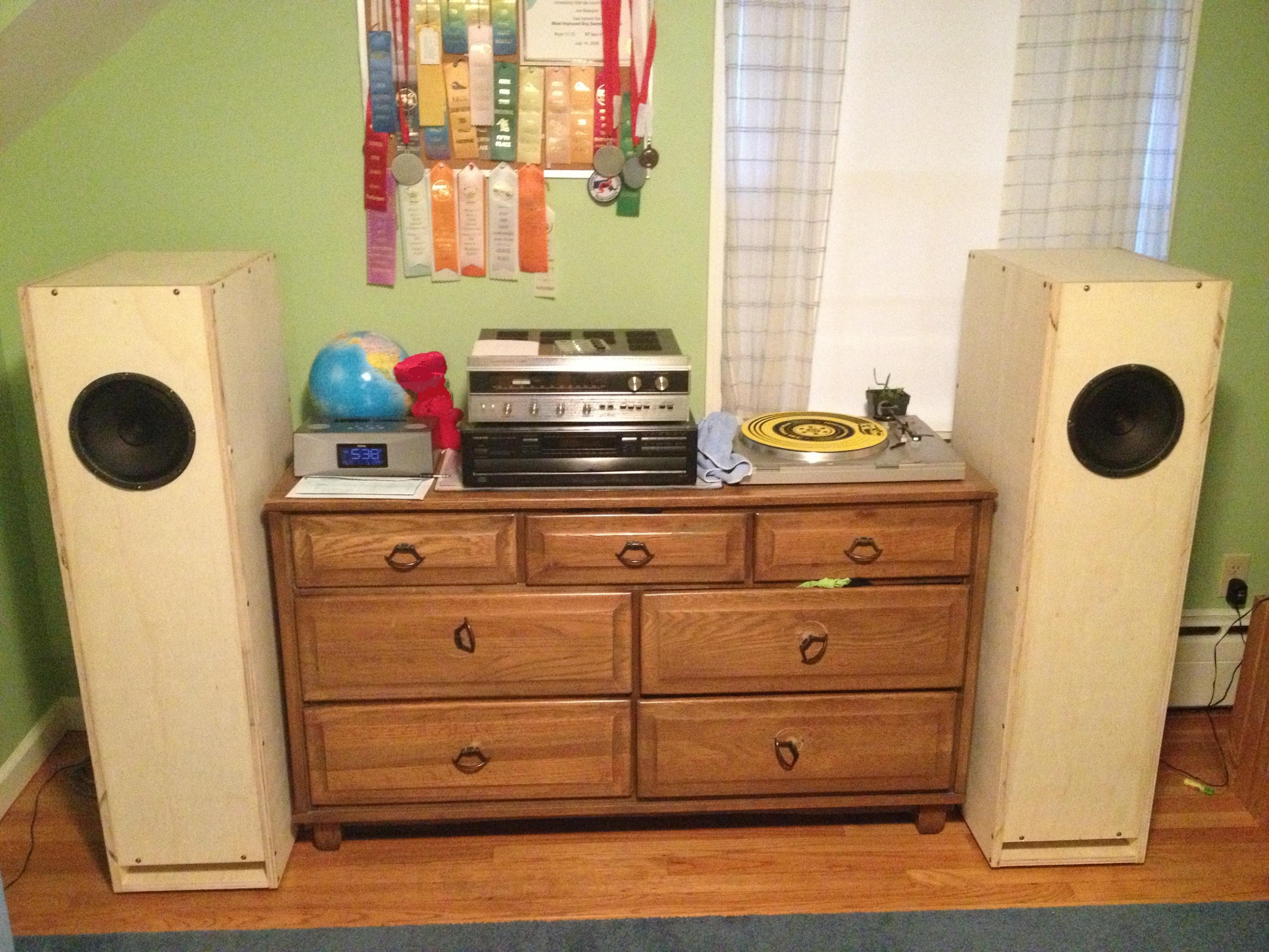

I have been meaning to do this just didn't get around to it yet. Here are some pics of the final pair of speakers as they are set up in my room, in case anyone wants to see 😀
the placement is not ideal but its the best I can do for now.
