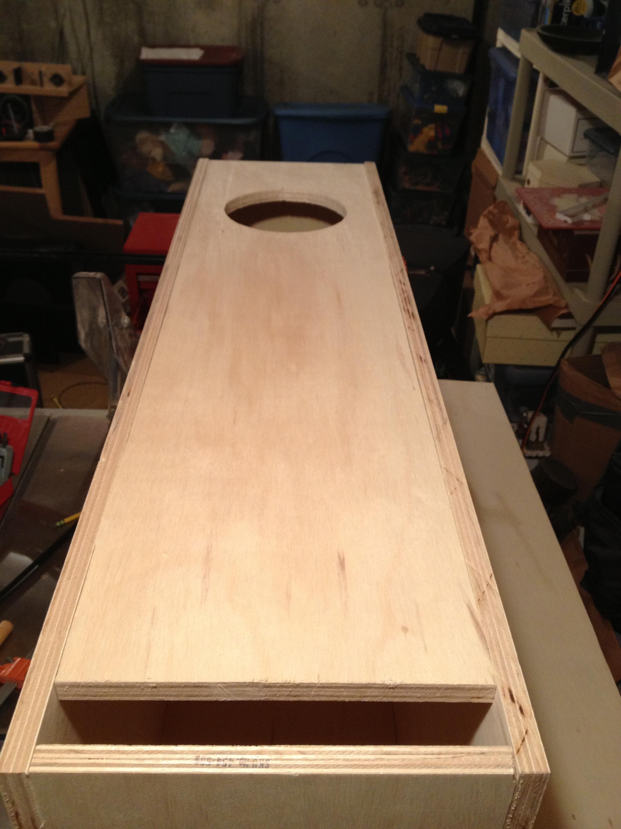

Wood Cutting Done!

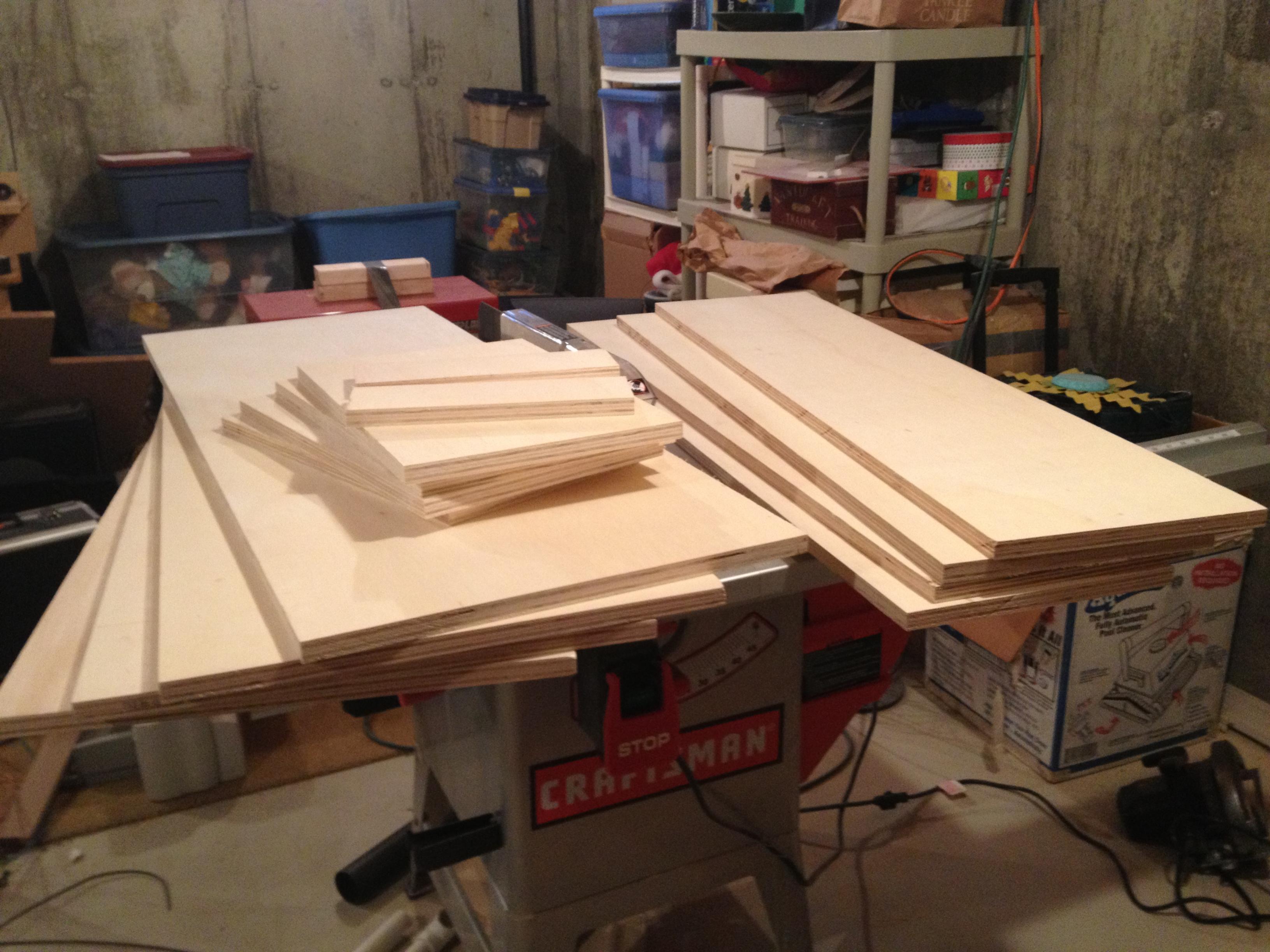

Here are some pics of the work so far. The first pic is of some stacked wood... not so interesting. But that pile is all of the pieces for the two speakers. It took about 48 square feet of ply for the two cabinets.

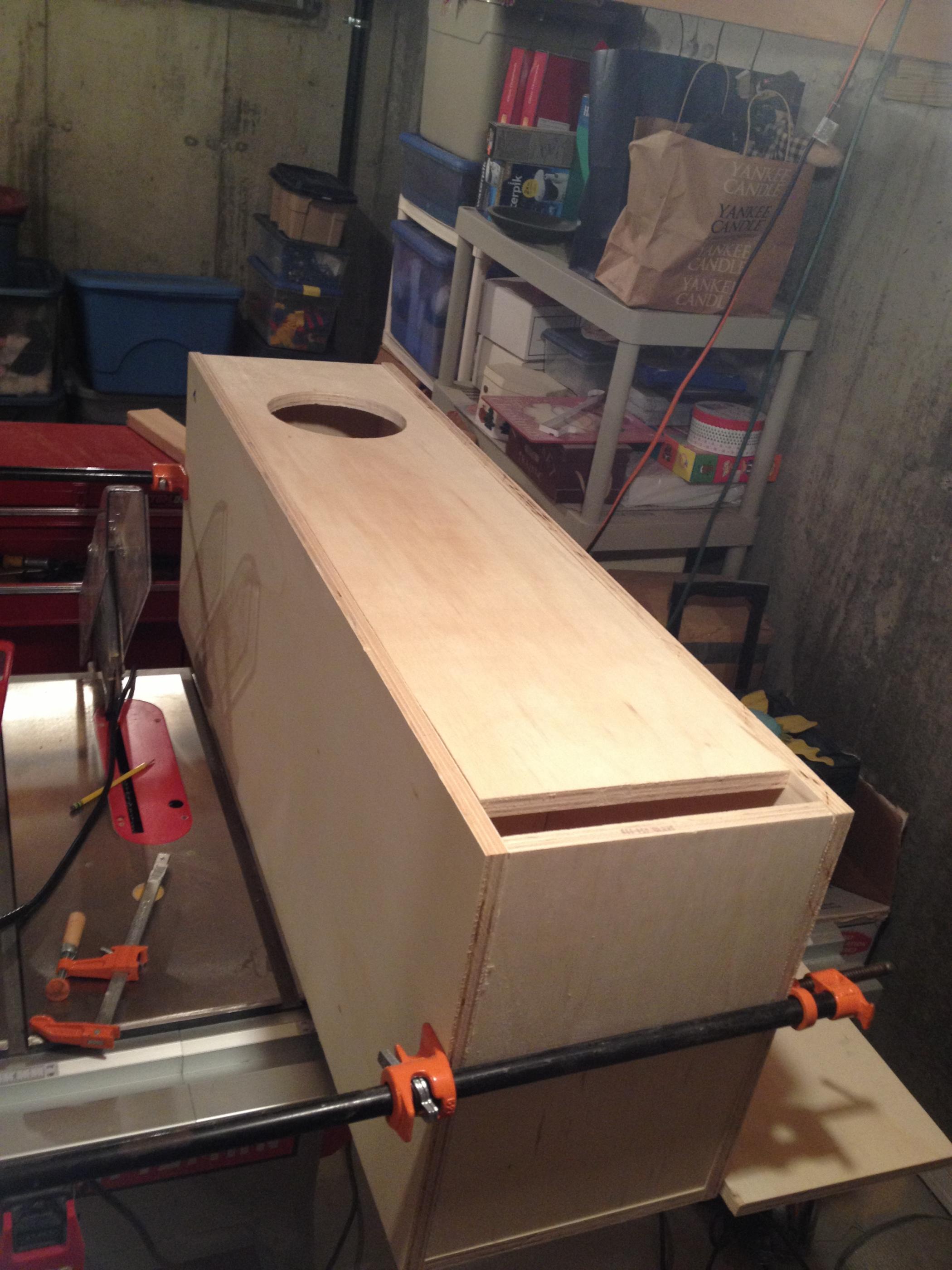

After the circles for the drivers were cut, I mocked up the cabinets using some clamps to hold everything in place. It's a big speaker but well proportioned I think. Tomorrow I will begin putting the cabinets together.

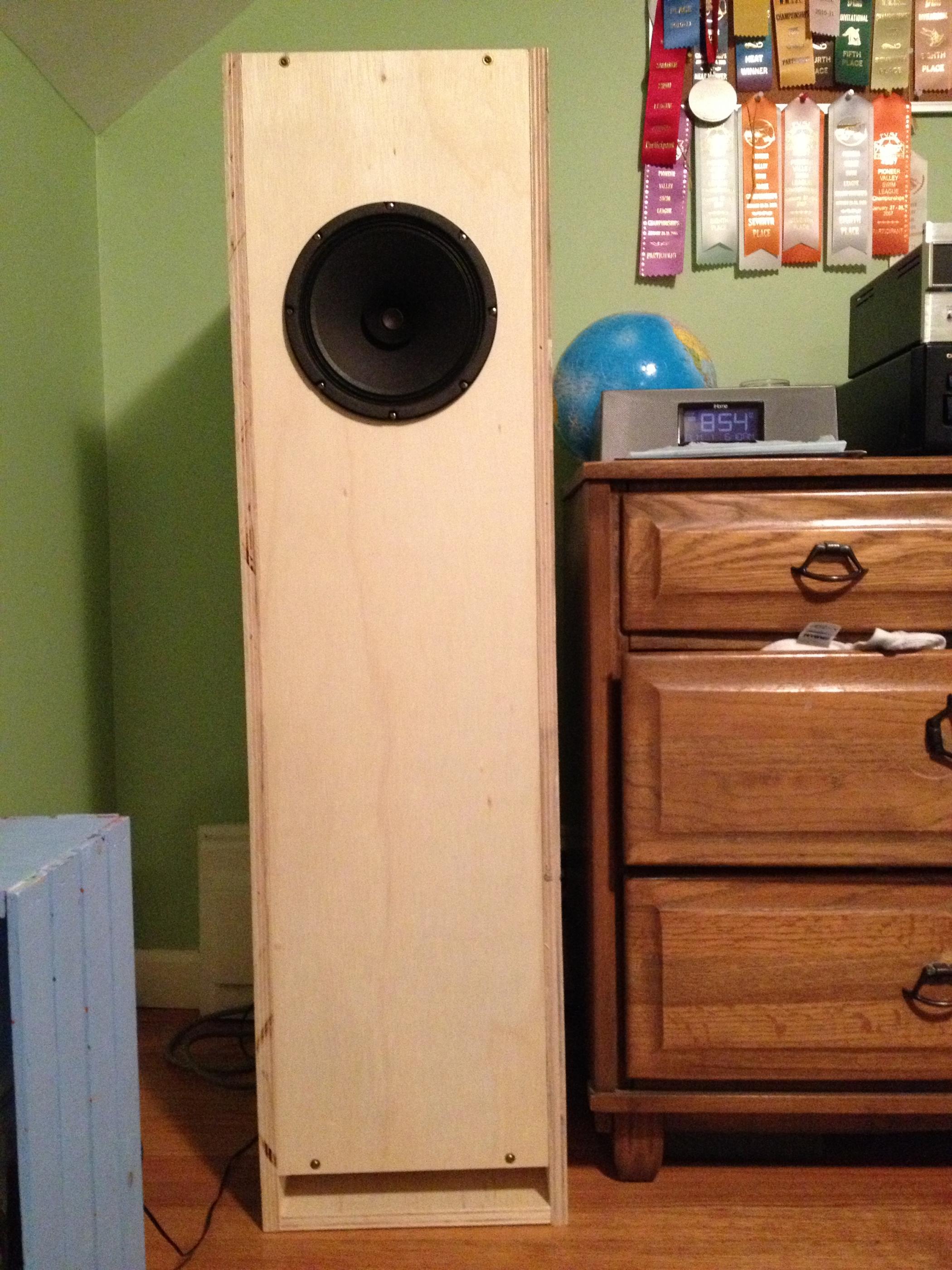

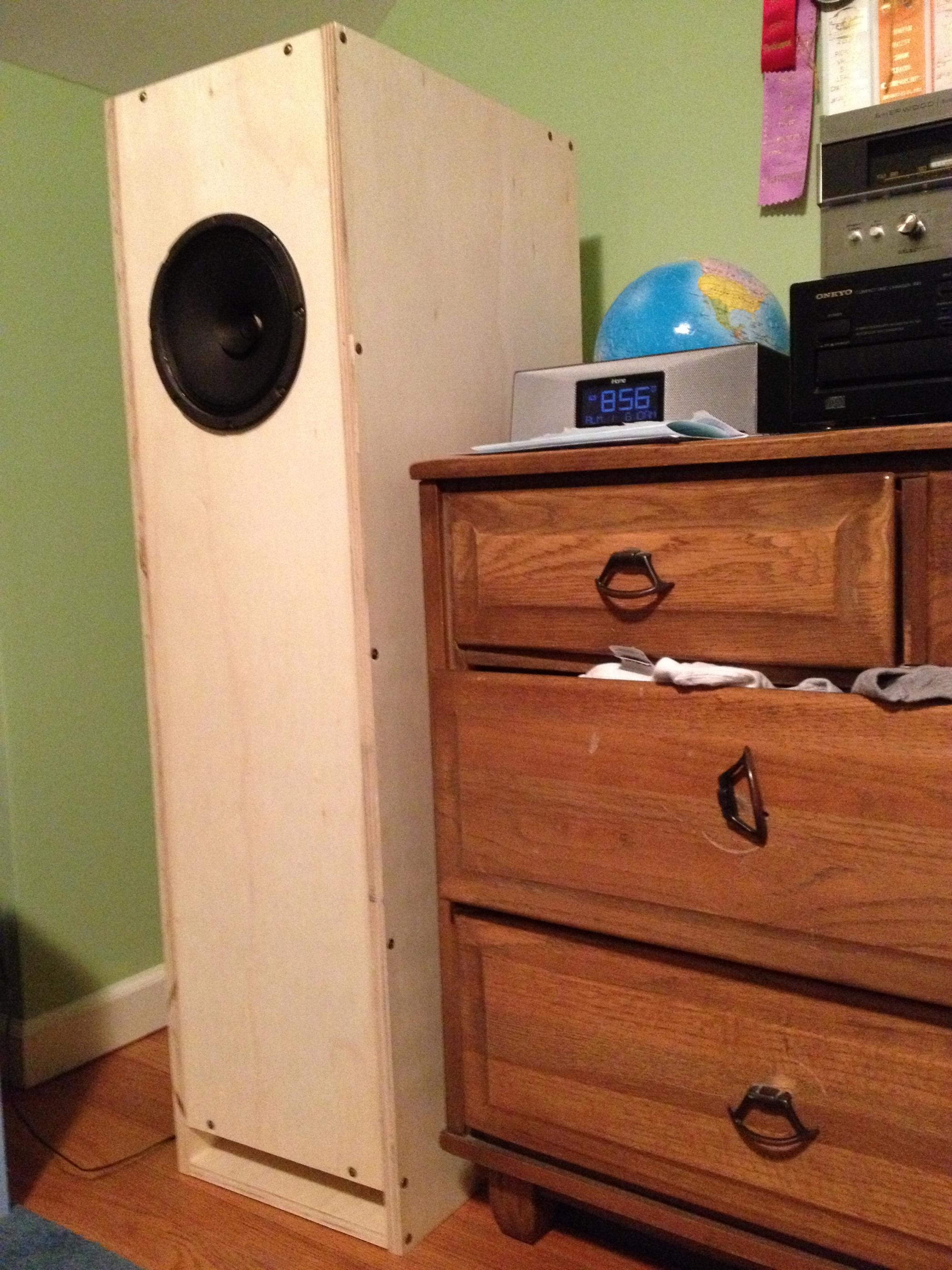

The World's First WiBAQ!!!
Not first pair, just first single speaker. I'm going to hopefully finish the second by this weekend. The one that is 'finished' is still missing cabinet spikes and binding posts. The wires don't exit the back of the speaker yet, as I am waiting for the binding posts before I drill the holes, so I haven't had the chance to listen to it yet.
I am also going to wait until some warmer weather to apply a finish to the cabinets. I was thinking a simple linseed oil rub. Right now its 30 degrees in New England and it would take a finish quite a while to dry in these conditions. No way am I applying linseed oil in the house.

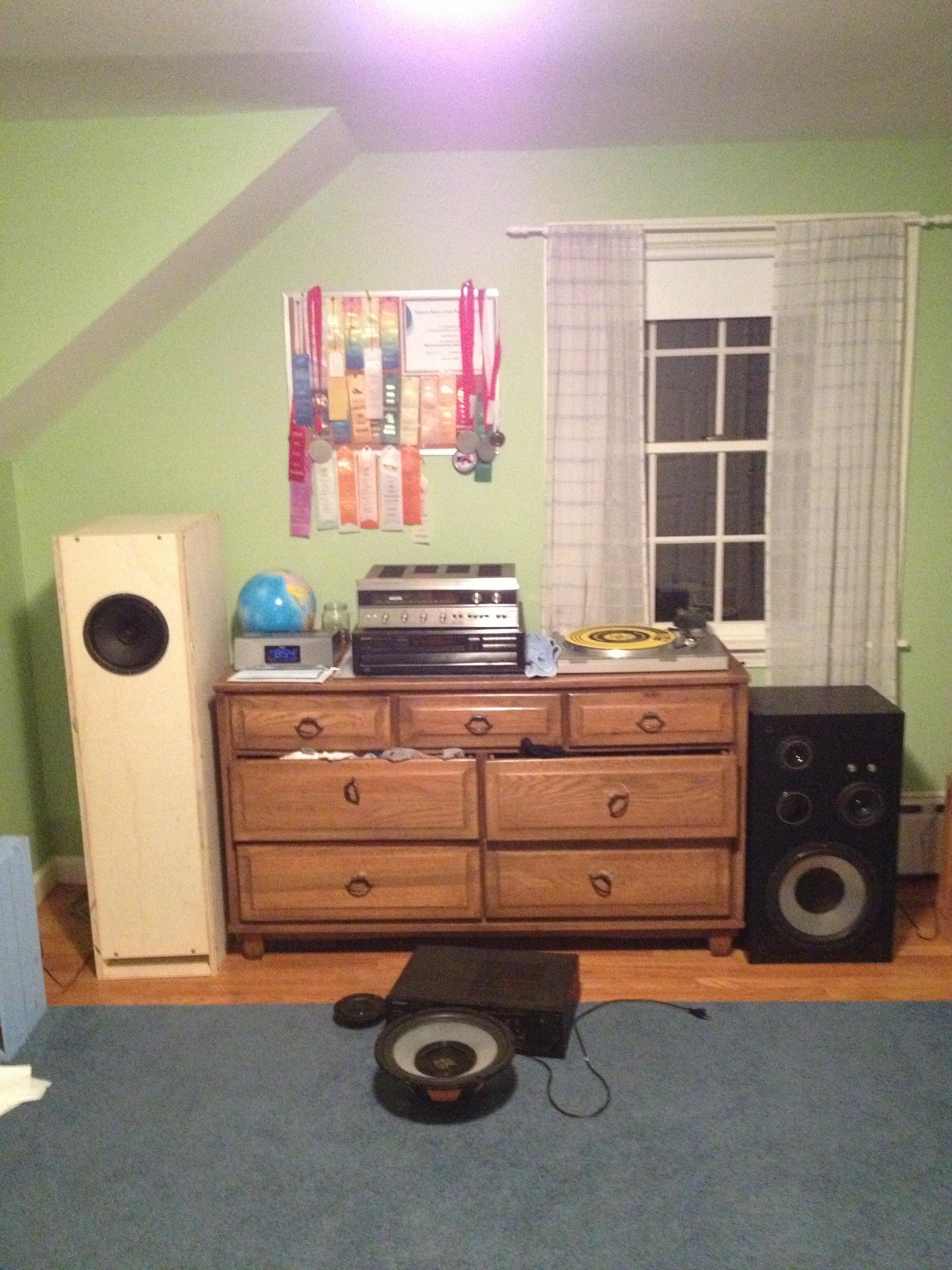

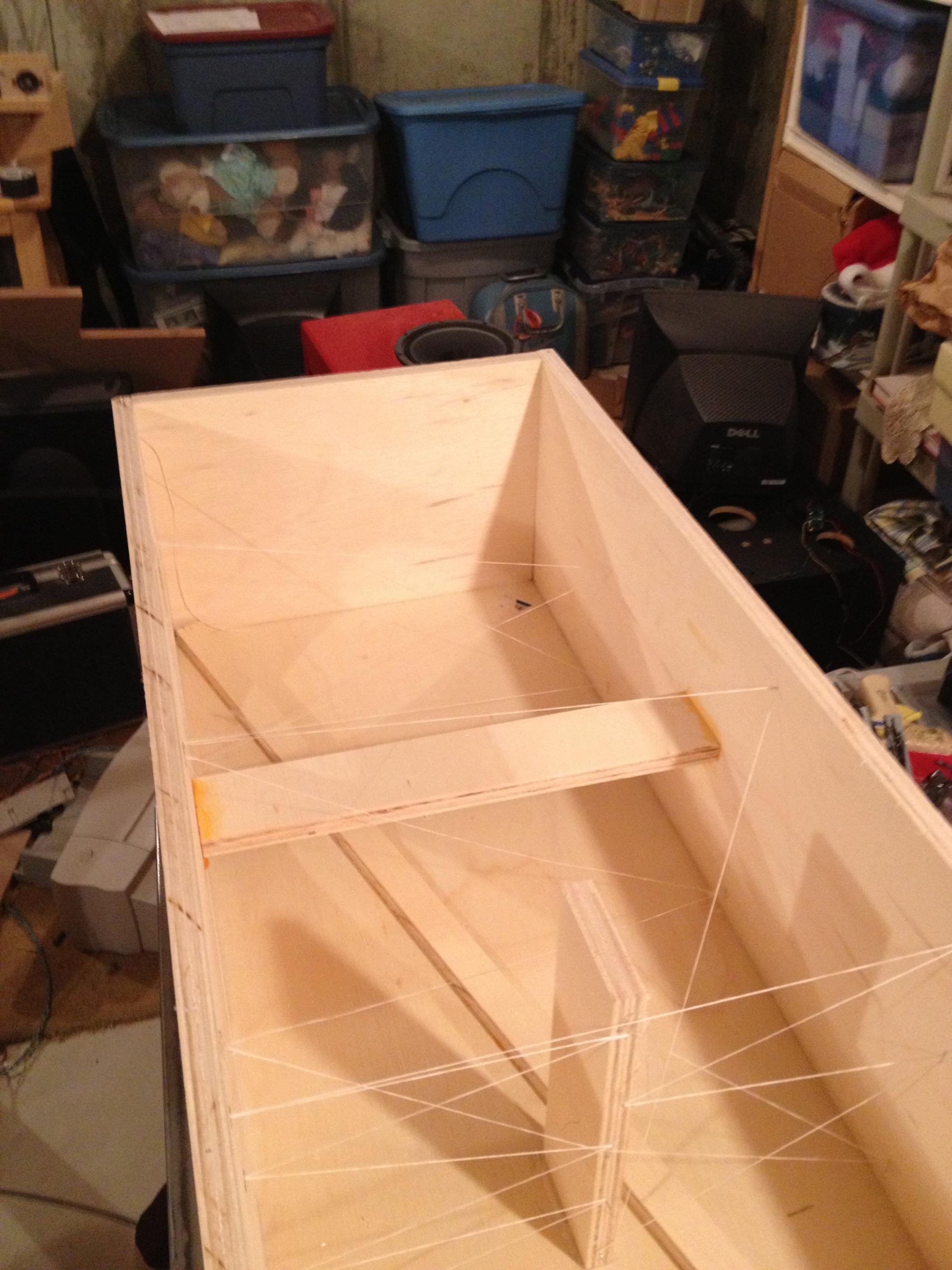

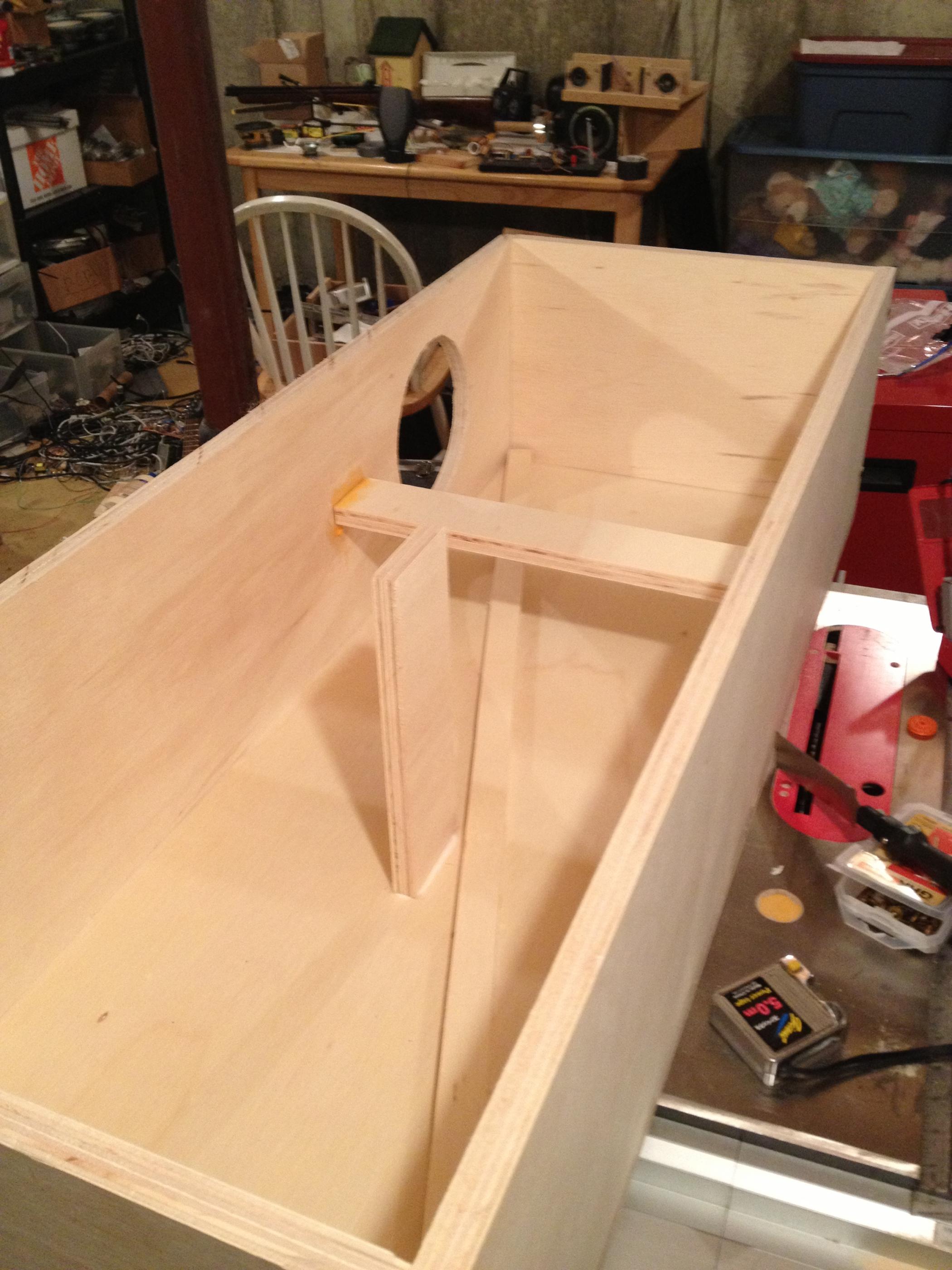

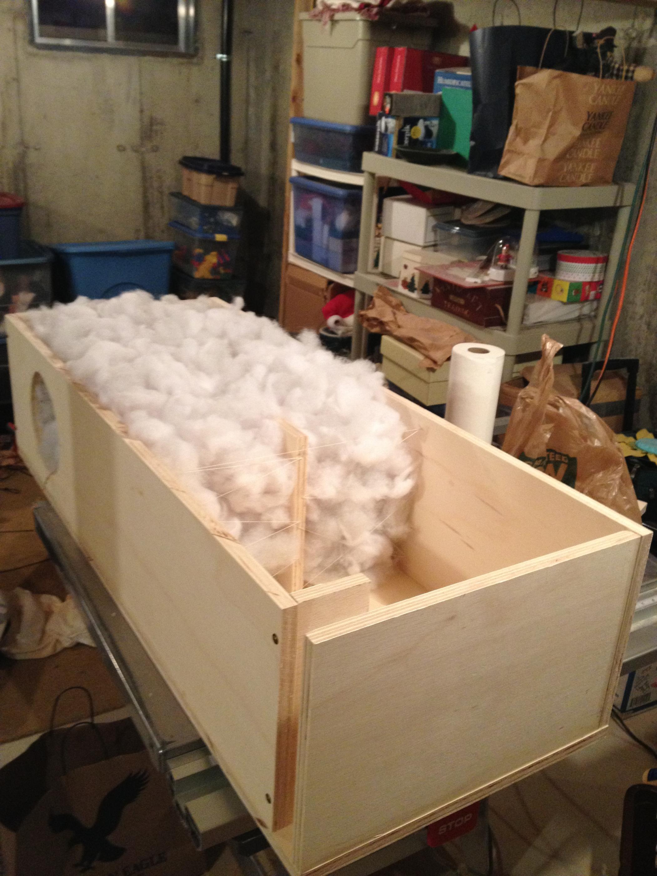

So what do you think? The first couple photos are the interior of the speaker, including the bracing I used, the strings I added to support the stuffing, and the stuffing itself. The braces were scrap from the cutting process. There is a strip going diagonally across the largest side just to stiffen it a bit, and one brace going side to side and another going front to back. These were place at the "Golden Ratio" points. Why? Cause I told myself it would help, and I had no other way to decide on the placement.
The finished speaker pictures are of it situated in its home in my room. The look large and in charge but not really overwhelming. Can't wait to begin to listen to it! 😀
