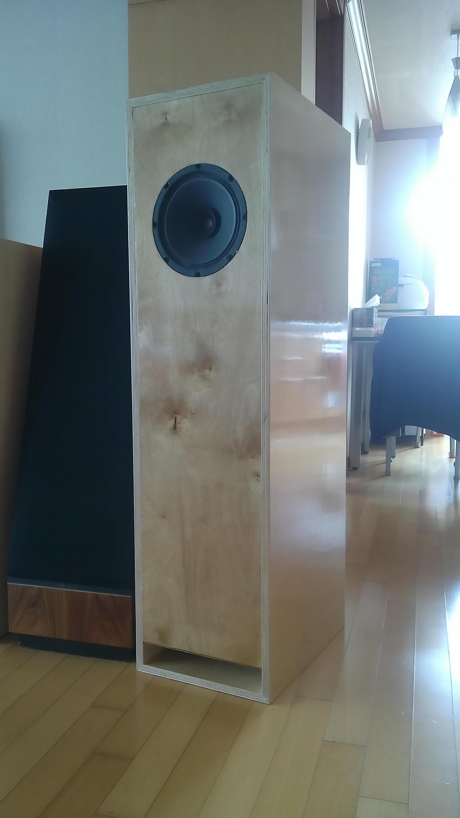

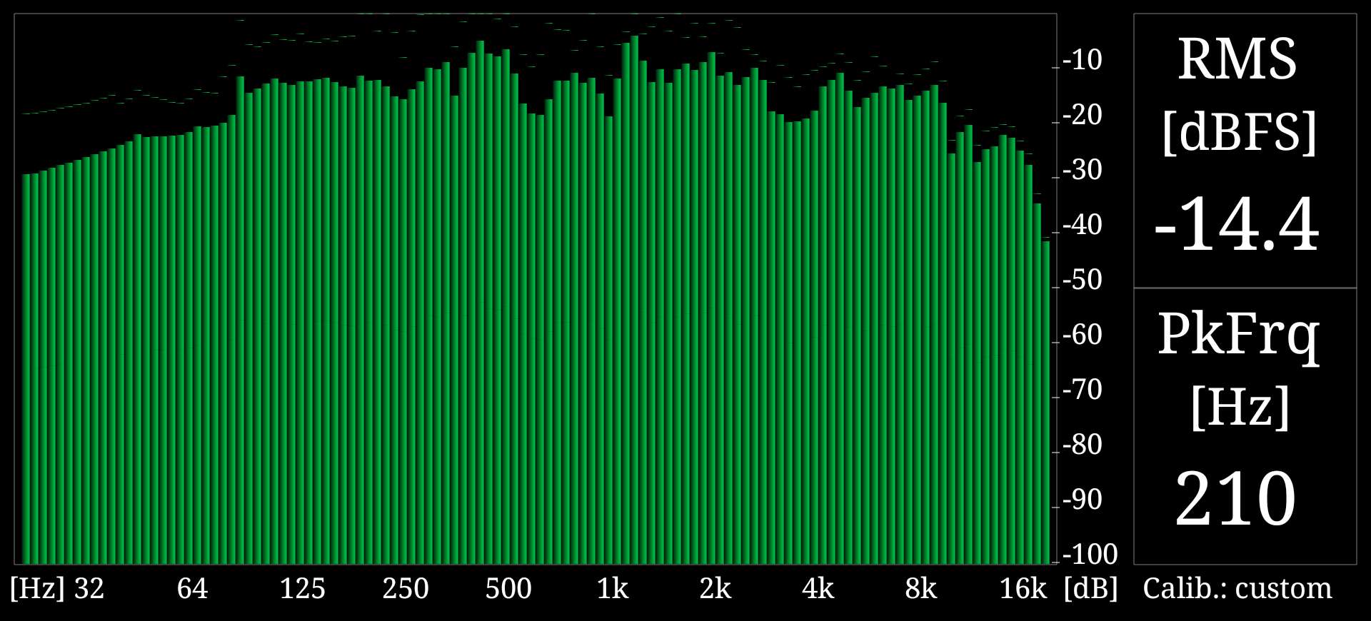

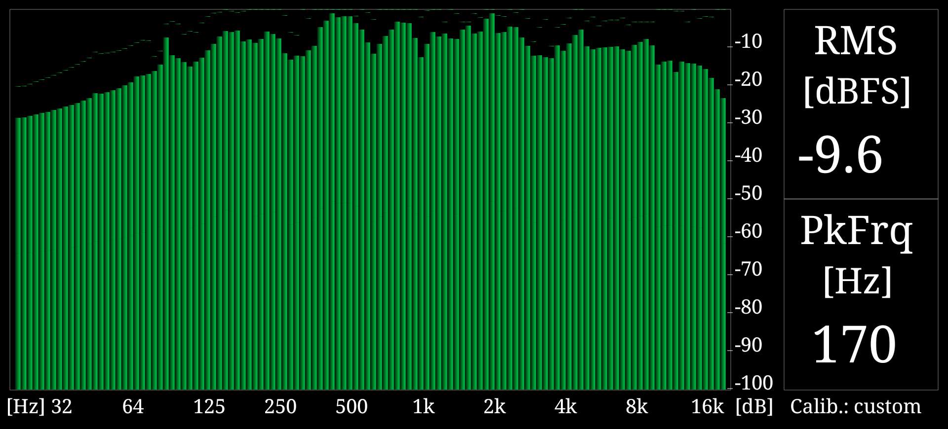

Hi, all.
It's my WIBAQ. I finished it 2 wks ago and I'm really enjoying it.
I did not opt the BSC circuit.
First graph was taken at 1m, on axis and second one at 3m, my listening point. I'm using Thiel 22, Alpair 12.2P and Wibaq.
As you see in graphs, its performance is awesome. Its bass extension is satisfactory, Of course it cannot make a tight/fast punches as thiel 2.2 does, however, the amount and extension is enough to enjoying Jazz / Classical music. I don't have to turn my my sub on while listening music.
It makes a very detailed sound. It delivers musical nuance very well. The sound stage is not so wide. Its stage is limited btw 2 speakers, not go out of them. And unfortunately resoution is sometimes not enough to play the orchestral music - location of instruments is not clearly drawn when playing symphonies. It plays Jazz / Chamber music very well, not orchestral works.
It does not do well with my SET - using 205D tubes. It works well with my Firstwatt J2 / Berning 230EA amplifier. It is out of my expectation.
IMO, it's a really good unit and design. I encourage you to build it. It's really a awesome speaker design.

Very nice build! I can't quite read your RTA screenshots. What is your estimate of the f3 frequency? I recall the sim had it around 35Hz - how close are you getting to the predictions? Sims here: http://www.diyaudio.com/forums/attachments/full-range/320031d1356696610-wild-burrow-betsy-ported-speaker-betsyk-simulation-tabaq-style.pdf
Very nice build! I can't quite read your RTA screenshots. What is your estimate of the f3 frequency? I recall the sim had it around 35Hz - how close are you getting to the predictions? Sims here: http://www.diyaudio.com/forums/atta...ted-speaker-betsyk-simulation-tabaq-style.pdf
Dear xrk971
As you see, it's not an anechoic response. I measured it in my room. Thus, the response was spatially averaged.
However, I could observe a small peak at 48hz in every measurements. Thus I think 48hz may be the F3 frequency.
And in estimating this graph, I could assume its characteristics comparing to my previous measurement of Pensil design with Alpair 12.2 / Thiel 22. I think the limit of bass (-6dB) is around 40-45hz. It's better than my expectation.
