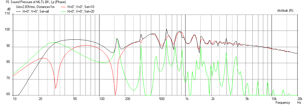

I think Visaton BG20 may be a good alternative. The vent dimensions can be calculated using the AMLTL method. With a Qts of 0.44, Vas of 110 liters, and 92dB sensitivity it seems to be a good choice. Pricing on this driver is also quite bargain priced in the US.

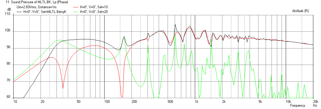

For a MLTL as designed for Betsy K per dimensions given in post #1 (11in wide x 45in high x 16.25in deep with 1.625in tall x 4.0in long vent), you can drop in the Visaton BG20 into the same box with one mod - change the vent from 4.0 in to 6.0in long. Should work almost the same in terms of sensitivity and bass extension.
Here is Betsy K:

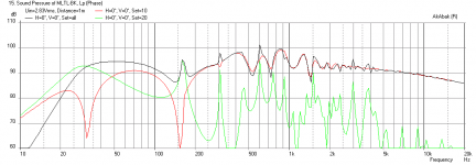

Here is BG20 with vent extended to 6in long:
The sims are for the speaker placed against a back wall so you have some cancellations and reflections, but also bass gain for 1/4-pi placement.
In either case, I would recommend some EQ or BSC to balance the highs with the bass. About 1.0 mH and 3 ohms should do the trick.

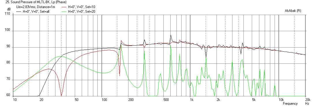

One note, if you plan to use the speaker far away from a back wall so you don't have bass enhancement, keep the vent at 4.0in long and this should increase the bass output. Here is response with 4.0in long vent, placed far from back wall (2pi) with 1.0mH and 3ohm BSC:
Here is Betsy K:
Hi there X: 2pI simulation, w/BSC is really flat, dramatic change, any analysis on the three mid range peaks and two later dips? They are at the same places as the first graph, although the peaks are attenuated some.
So are these design anomalies? Or related to geometry. Are they expected to be present in a built enclosure, if so can they be corrected by stuffing changes? ...regards, Michael
Those are all back wall and floor reflections - the difference was just setting the "Reflection" switch off. Actually, it might be 4pi come to think of it. Baffle step is still there - just no reflections from nearby walls. Stuffing will control the sharp spikes on the green curve which really won't make it out of the vent.

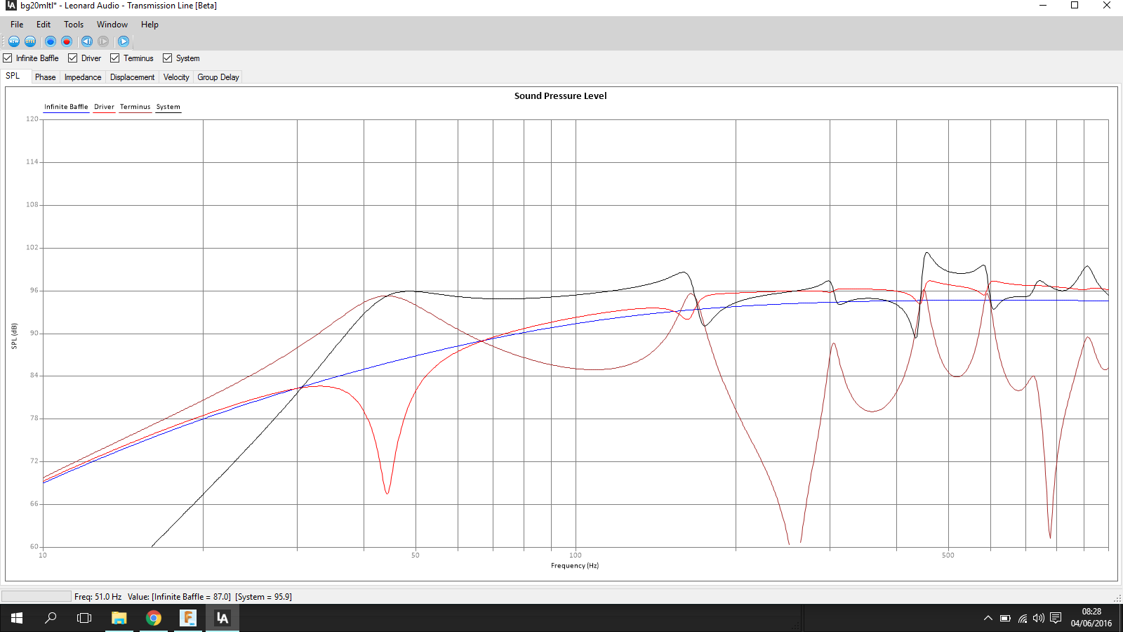

I am also very intrigued to try the big cheapo BG20. I made a simulation of it in a wibaq enclosure with 6in port, and mine doesn't want to go as low as yours. Do you know why? Different sim system, of course, but this much difference?? I smoothet it a bit with stuffing, but that doesn't really affect the bass extension...
You said to use BSC to tame the highs, but since I am a "no filter" guy, do you think removing the whizzer cone would achieve something similar?
Any ideas how to get good performance from this driver in a smaller box?
And another question: I can't quite imagine how loud a speaker like this is. Will it be enough for outdoor picnic/party events? I know this is a bit too general question, but anyway...
Maybe you did not turn on boundary of nearby walls and floor. Both enhance bass. Akabak is usually pretty accurate about the bass extension.
BSC is not evil it's not a crossover but a way to shape the output by attenuating highs so that the bass can be heard. Get a cheap $1 1mH ferrite core inductor and a 5ohm or 7ohm resistor and try it out. You might be surprised.

I can simulate effect of BSC directly but I find 1mH to be the typical value needed given the baffle width of a typical speaker with 8R driver. 5R gives maybe 3dB attenuation of high shelf. 10R will be about 5-6dB or full BSC max cut. Of course the WIBAQ baffle is a bit wider than a typical 6in wide baffle so maybe 0.8mH can be used. It's a mild effect in the frequency where it starts the shelving function (high pass cut ).
OK, so the BSC circuit usually compensates for baffle's effect, which, if I understand things right, can also be handled with rounded corners and narrower speakers. But the BG20 is "hot" everywhere above 500Hz. Whould a 1mH, 5Ohm BSC compensate for that also?
