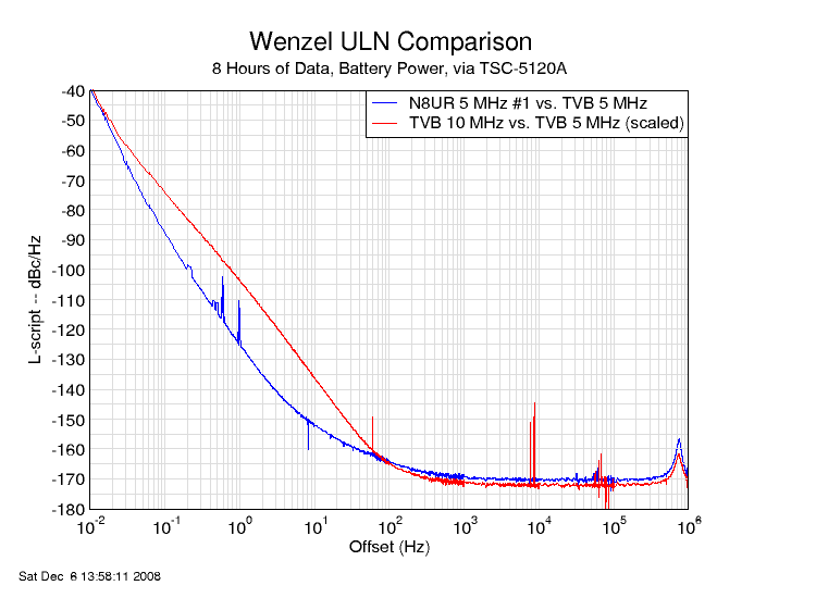

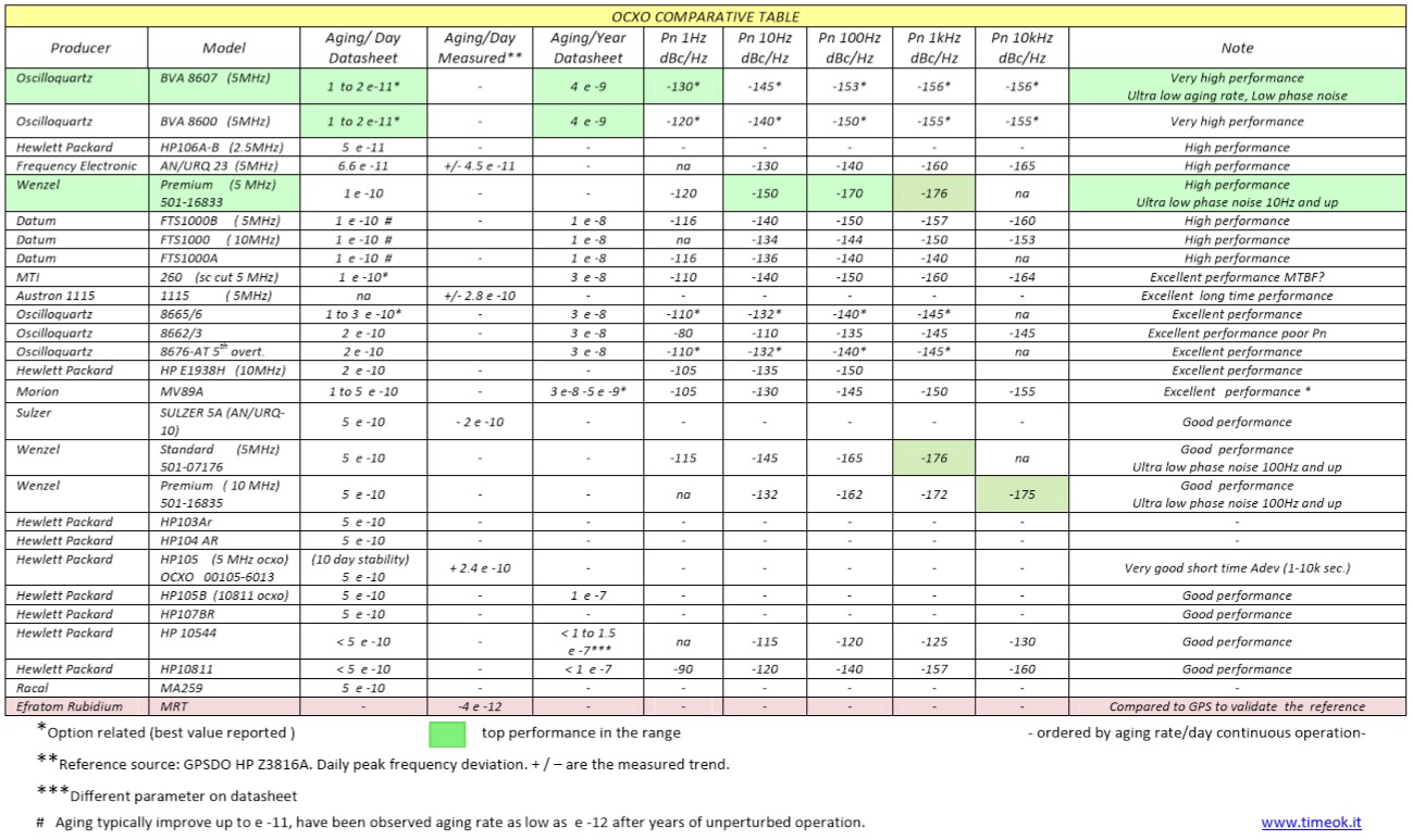

For reference below you can find a comparative table with the best OCXO on the market. The top performers in the range are the Oscilloquartz BVA 8607 and the Wenzel ULN, that means many thousands dollars to get one of these (no chance to get a frequency suitable for digital audio).
I also attach the phase noise plot of the two top performers. As you can see at 10 Hz from the carrier the phase noise performance of the prototype oscillator is very close to the performance of the best oscillators on the market.
The top performers are better at 1 Hz from the carrier, but as I said in a previous post I think there is still improvement margin by shielding the new oscillator and by feeding it with a better power supply.
It's true that the Crystek is a 22.2792 Mhz oscillator, so you have to divide it by 4 to do a better comparison, and theoretically its phase noise will improve 12dBc, but in the real world I'm not sure you really get 12dBc better phase noise performance. Anyway, assuming 12dBc better, the phase noise difference is 'only' 36 dBc (148.7 - 112).
