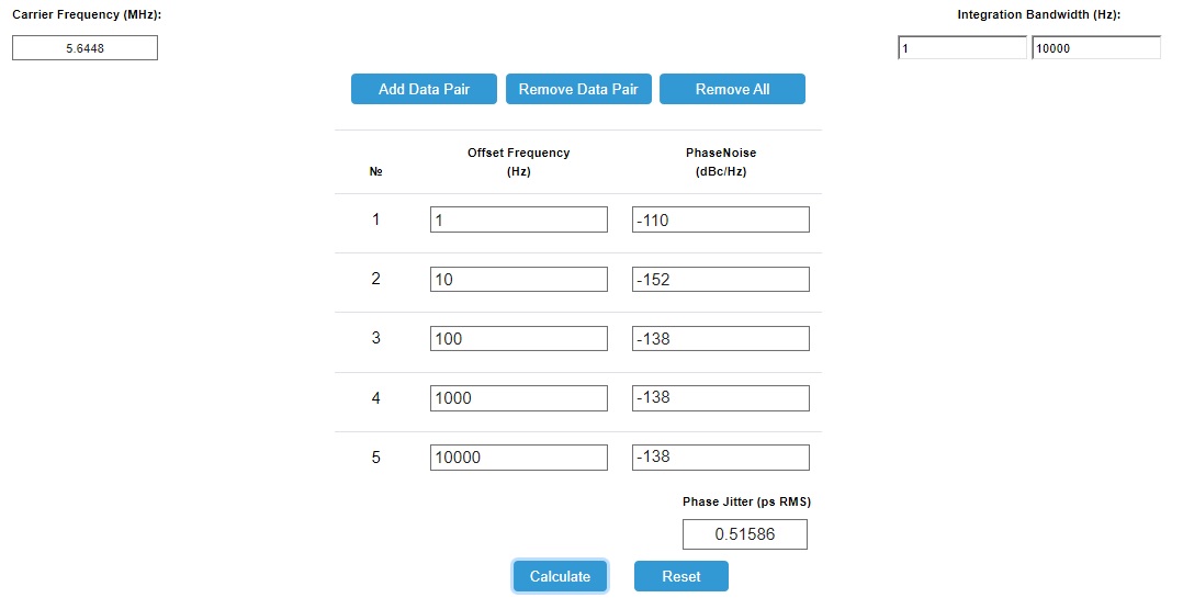

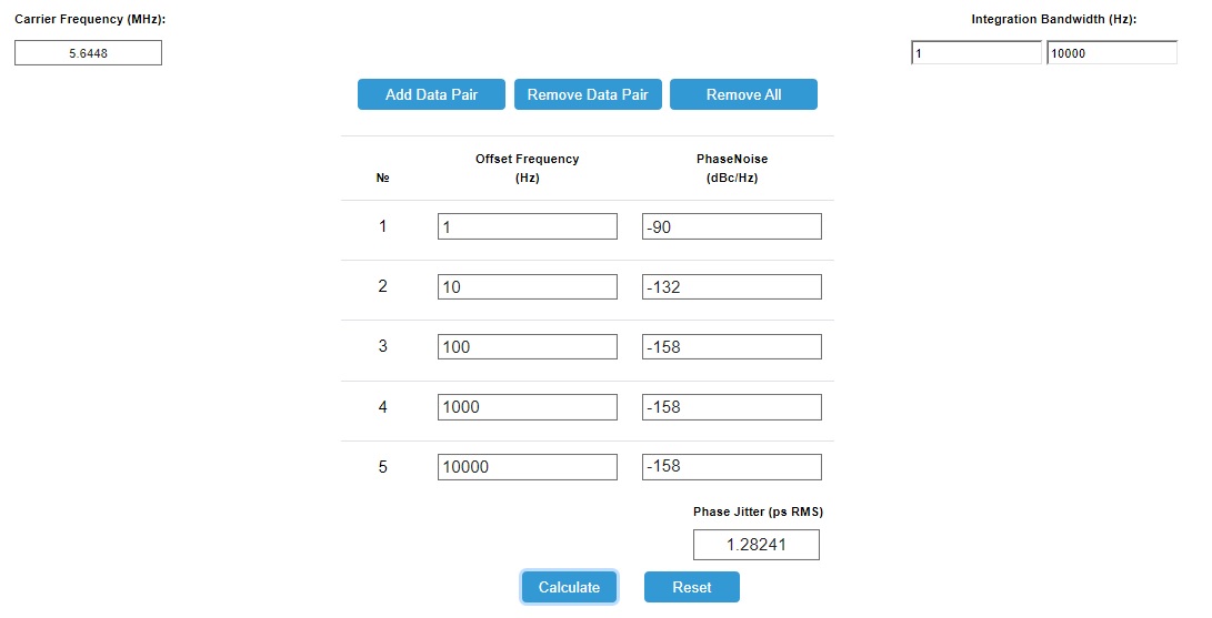

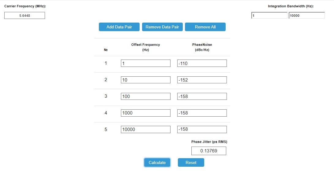

Please, take a look at the attached pictures.
The first shows the phase noise to jitter conversion of phase noise plot of the first measured prototype oscillator. As you can see the calculated RMS phase jitter is around 138 femto seconds.
The second picture shows the same plot with some alterations of the close-in phase noise, +20dBC at 1Hz and 10Hz from the carrier. As you can see the RMS jitter rises to 1.282 pS.
Now the third pictures that shows the same plot but with different alterations, +20dbC at 100Hz, 1000Hz and 10000Hz from the carrier. Also in this case the RMS phase jitter rises to 516 fS, but much less than in the previous alteration of the close-in phase noise.
