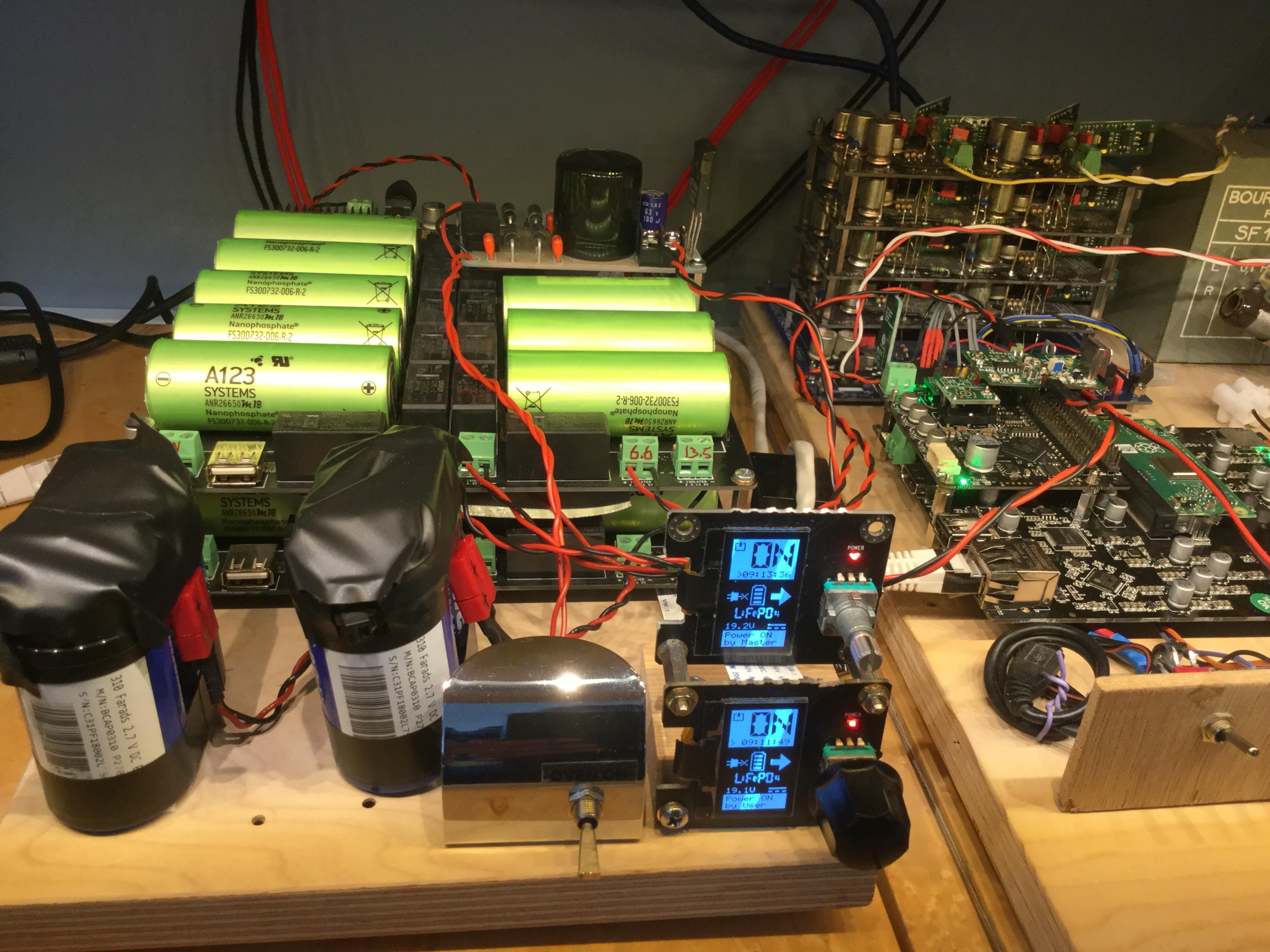

Supersurfer,
Do you have photos/instruction of how you implement the clocks in Fifopi?
I ordered Iancanada’s Fifopi II.
I want to try Andreas’ clock too. Thanks.
Just use the dil pcb from Andrea. You can connect with u-fl, sma or directly. I used u-fl first but directly is a bit better. See attached pictures.
It will be a problem fitting two of these dil pcb’s though. But Andrea is designing new boards to fit the fifopi; I think using the clocks on fifopi is the most used implementation of the clocks.
