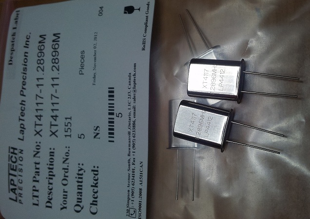

The crystal
Since a very good crystal is the goal of this project, I got a custom device from the canadian Laptech Inc.
The most important features for a very good crystal are: cold welded package, very low ESR and very high Q, but overall its surfaces have to be strongly polished.
If the surfaces are not polished with the maximum care, the crystal shows some kind of perturbance that decreases its performance in phase noise close to the carrier.
The selected crystal is an HC/49U cold welded polished AT crystal.
These are the typical characteristics for a 11.2896 MHz crystal:
Mode: fundamental
ESR: less than 10 ohm
Motional capacitance: less than 12 fF
Q: better than 150 k
But features aside, the most important feature of the above crystal is that its features are standardized and repeatable.
The crystal is individually polished and tested from the manufacturer, that throw out the devices that not performs as specified.
When I got the first batch of 5 crystals, they were accompanied with a list where each crystal is tested individually. This list contains 12 tested crystals, but 5 only of them passed the selection.

Indeed I'm planning to use a 3rd overtone crystal for the Driscoll oscillator.
I got also some pieces of 3rd overtone crystals from Laptech.
These are the specs:
Frequency: 33.8688 MHz
Mode: 3rd overtone
ESR: less than 15 ohm
Motional capacitance: 1.35 fF
Q: better than 260 k

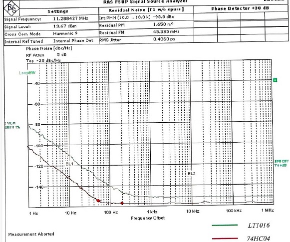

The Clapp crystal oscillator
The first circuit I have built is the Clapp oscillator, a variant of the Colpitts.
The circuit was designed by a smart dutch guy, using only a few components.
The oscillator include one jfet as the active device, and a few capacitors and resistors.
Then a simple '04 inverter was used to square the sine waveform coming from the oscillator.
The circuit is intended for use with fundamental mode crystal, from 5 MHz to 25 MHz.
This oscillator was measured with a R&S FSUP system.
As you can see in the attached plot the performance is impressive:
-132 dBc at 10 Hz from the carrier and -101 dBc at 1 Hz
RMS jitter below 1 ps (0.4060)
One of the best AT crystal oscillator I have ever seen, not far from an state of the art OCXO.
Note that the oscillator performs much better using a 74HC04 for the squarer, rather than using a comparator such as the LT1016.
The crystal used comes from the german QT Quarztechnik GmbH.
It's a HC-49U resistance welded package, 15 ohm ESR, laser engraving strongly polished crystal. Very similar to the Laptech, that on the paper should be a little better, since it show lower ESR and comes in cold welded package.
The dutch guy measured also the oscillator with Laptech crystal (I sent him 1 piece) with his DC receiver. The DC receiver cannot measure the phase noise very close to the carrier. The results was:
at 200 Hz the noise is at the bottom of the DC-receiver: -157 dBc/Hz@200 Hz
at 50 Hz the noise is -155dBc/Hz@50Hz.
He said about the Laptech crystal "...one of the best Xtals I measured before! Moreover its microphonics is very low which makes it very suitable for a transport in the same room as the loudspeakers"
Next step: the circuit diagram.
The schematic of the Clapp crystal oscillator is enough simple, one J310 jfet as the active device and a few other components.
The capacitors C1 and C2 depend on the oscillator frequency:
- 100 pF for 11.2896 MHz and and 12.288 MHz
- 200 pf for 5.6448 MHz
- 50 pf for 22.5792 MHz and 24.576 MHz
The capacitor C3 is required only to fine tune the oscillator for measurement; in the real operation it has to be replaced with a 0 ohm resistor or a link.
The resistor R2 has to be choose to get 18-20 mA flowing through the jfet when the crystal is removed from the circuit.
The resistors R3, R4 and R5 are required to get 50% duty cycle.
Finally an inverter is used to square the sine waveform coming from the oscillator.
The circuit requires two low noise power supply: +15V for the oscillator and +5V for the squarer.
To get 3V3 at the output, the 74HC04 should be replaced with a 74LVC04, and the +5V power supply should be replaced with 3V3 voltage.
Here attached the part list to build the oscillator.
Some components have a notation indicating that they have to be selected depending on clock frequency, used outputs, output voltage.
R2 has to be adjusted to set the right current flowing through the jfet.
I recommend to use the Laptech custom crystal, or a similar type with the same specs (be careful to select a heavy polished crystal!).
Anyway, if you own the right gear to select the crystal, you can try to get a bag of crystals from the shelf and select the best by measurement.
You can also select the best, comparing the crystals from the bag with several listening sessions, if you have the patience to do the job.
As the power supply, I'm using the Tentlabs shunt regulators.
The first has to be selected for 15V, while the second has to be choose for the desired output voltage, 5V or 3.3V.
You can use other regulators, but I suggest to get a low noise regulator, preferably a shunt type. With a noisy regulator you can loose several dB in phase noise.
Anyway, the PCB is able to accommodate 3 terminal regulators, if you like to build a cheaper version of the oscillator.
