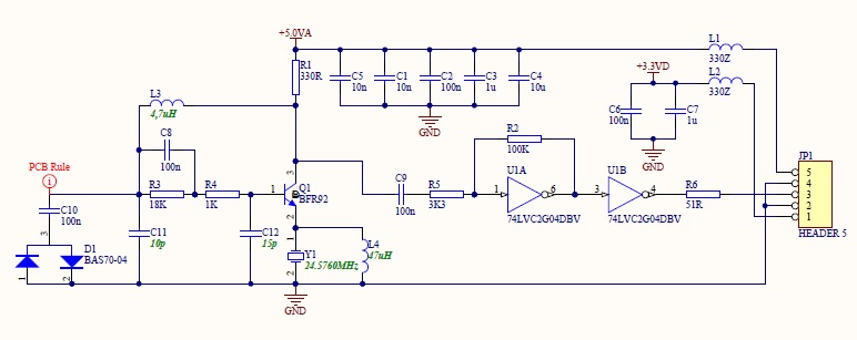

Hi Andrea,
congratulation, very nice job, The Clapp oscillator seems to be very attractive.
What about other topologies? Have you ever played with them?
Did you try emitter coupled oscillators like in the attached schematic?
Not yet, next step are the Butler 2 emitters and Driscoll oscillators.
But if I will find the time ...
