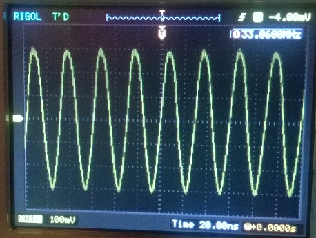

45.1584 MHz and 49.152 MHz 3rd overtone
Good news about higher frequency oscillator.
The attached schematic was modified to run a 3rd overtone crystal at 33.8688 MHz.
The tank circuit L4C2 is selected to be resonant at a frequency below the desired crystal harmonic (33.8688) but above the crystal`s next lower odd harmonic (11.2896), in this case the fundamental. Capacitor C9 acts as dc blocking.
For a 33.8688 MHz 3rd overtone crystal, C1 and C2 should be around 33pF and L4 1.2/1.5 uH.
The attached oscilloscope plot shows the sinewave signal. The Clapp oscillator runs at 33.8688 Mhz and the fundamental is suppressed.
It should run also at 5th overtone frequency, but I have no crystal to try.
Looking at the circuit I think the 20K bias resistor for the JFET will limit the noise. The noise of the transistor modulates the oscillator, which is why you want low noise transistors for this function. The 20K resistor at 18 nV/rtHz will be much higher than the transistor. The transistor is listed as 6 nV/rtHz. There is no other low Z impedance in parallel so the 20K will define the noise. You really want that to be low. I suspect using an inductor + resistor of around 100 Ohms + 10 uH may be enough and will drop the close in phase noise a lot. It might work with just an inductor.
You mean R1? If so, it is 220K. It acts as the AGC (leakage current).
To replace it with an inductor, we need high reactance, for example around 3mH at 11.2896 MHz and about 700 uH to 49,152 MHz.
In addition, it remains to check what happens in DC.
