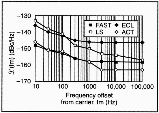

Second use a 74AC logic gate for the lowest phase noise. It can be problematic since those can radiate with their very fast edges but they have the lowest phase noise of the TTL logic families (except perhaps the Potato stuff). Buffering and isolation is important. Modulating the load even a little will alter the frequency of the oscillator producing phase noise. i suspect a pretty simple inexpensive packaged oscillator with good isolation would make a big difference and be better than an over the top effort with poor isolation. There is a spec for reverse isolation on distribution amps for precision oscillators because of this issue. Usually way better than 100 dB for good ones. And not an easy one to meet. http://www.ko4bb.com/Manuals/05)_GP...ide_to_Isolation_Amplifier_Selection_NIST.pdf
I specified the 74LVCU04 in the parts list document for 3V3 output, but the board can accommodate a PO74G04A or a PO74GU04A. I own some Potato inverters, so I can try them to compare in listening session. Unfortunately I don't own the gear to measure the phase noise. I can access a Agilent E5052A only a few time, so I'm planning to go to university lab only when all 3 oscillators will be ready.
As you can see in the plot, the logic gate make a great difference in phase noise compared to a comparator. I know someone has reached excellent result with a simple unbuffered '04 Pierce oscillator and cheap crystal, but since I don't own a suitable measurement system like him, I prefered to start with a circuit that was already tested and a crystal with repeatable specs. Modifying the oscillator means unpredictable result, if one cannot measure the result every time.

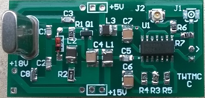

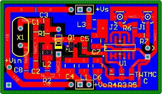

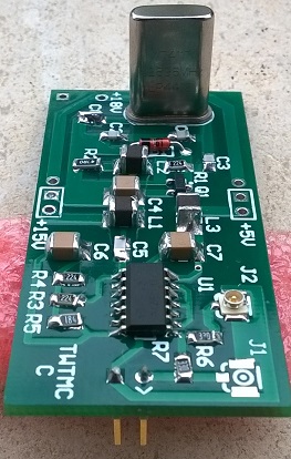

The new PCB layout, 1.75" x 1", Ni/Au surface finish.
The PCB provides 2 outputs, pin strip and/or u.fl. connectors.
The oscillator needs 2 separate PS, the PCB provides footprints for simple 3 terminal regulators, but low noise external regulators are strongly recommended.
The Vs rail (5V or 3V3) provides 2 pads to place a voltage drop resistor, if you want use a main external supply to feed the two regulators.
Later, I'll post a simple construction manual.
