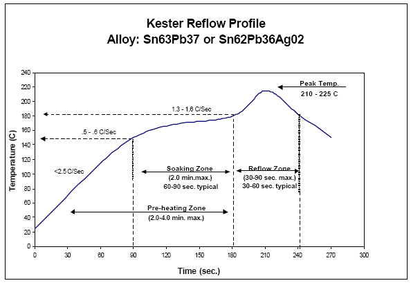

It has crossed my mind that I tempted you out of happily listening to a good set up to days of frustration with the oven. Sorry for that🙂
Just reminding myself of the heating profile for smt solder reflow, I think you can safely take the entire board up to 85C for several minutes without expectation of damage. The parts are expected to heat soak for 2-4mins at up to 180C, so presumably under 100 should be fine for a couple of minutes. I have followed this profile using a toaster oven for larger builds without damage to parts. Sounds like your failure mode is constantly at around 1min. If you view hot air station how to video, you see a process of kind of waving the hot air back and forth without heating one spot. Perhaps the same technique with a hair blower could allow you to heat the entire pcb up to around 80c for a couple minutes. Practice with a junk pcb before hitting the WTMC.
It will also allow you to hear impact of the oscillator around it's happy temp.

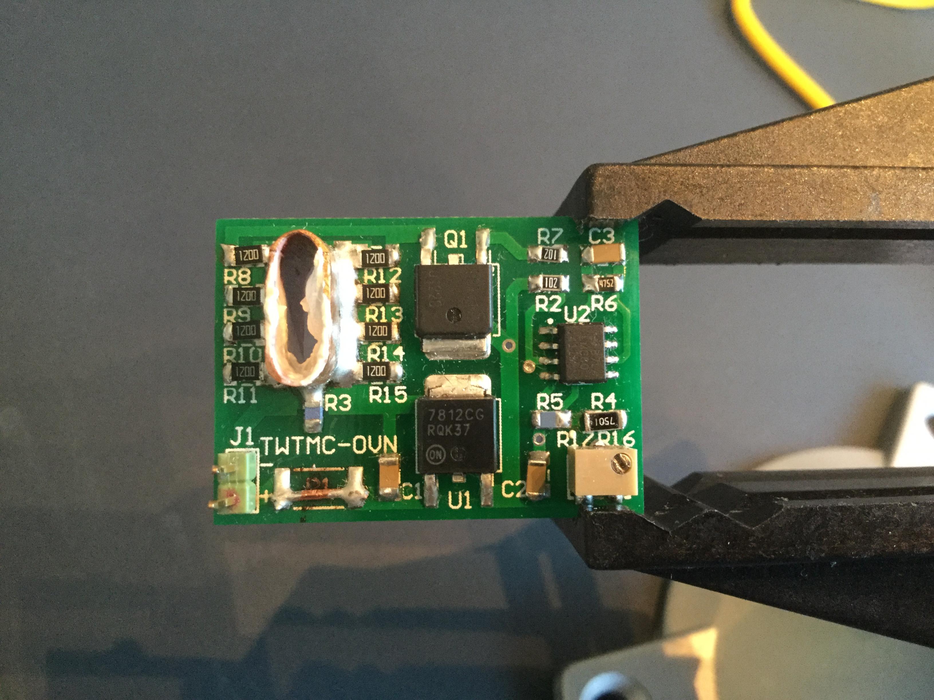

Hi wealas,
The small plastic is inserted below the crystal. I do not know it’s purpose; electrical or heat isolation to the board?

The first thing to do is to check if the regulator of the oven oscillates using an oscilloscope.
If you cannot use an oscilloscope you can try using a DMM. Power up the oven only then apply a DMM between the output of U1 and ground. Set the DMM to AC mode and check if there is any voltage.

Hi Andrea,
I measured the ac on 7812 output; the Fluke DMM only displays a stable 0,002VAC. To me this seems not an indication for oscillation but I can be mistaken.
the AC on the transistor output is fluctuating between 0,002-0,024VAC. I do not know if this is ok, maybe just regulating the temp. This is measured after heating for +15min.
Maybe nothing to do with the current issue I have but I did notice a possible problem at starting up: the inrush current is so high at startup that the input voltage sags to below 12v after the 10r resistor and the 7812 output is on 9V, this goes up after a while and stabilises to 16,41v before 10r, 14,4v before 7812 and 11,95v after 7812. Total current draw after stabilising is 200mA
Whith the high inrush current the solderings of the 10r resistor melt!
This cools down after a minute but I expect this will raise problems with bad soldering connection after a while. Is this resistor mandatory? I use a stabilised ps with LT1083.
Do you have any other thoughts on the issue?

Hi Andrea,
From the AC measurement it looks like that the regulator is not oscillating. 200 mA is the ordinary current consumption as soon as the oven reaches the working temperture. Also, the 10R resistor works correctly, since the voltage drops around 2 volt, from 16.41V before the resistor to 14.4V after the resistor (200 mA * 10R = 2 volt).
What is abnormal is that the solderings of the 10R resistor getting melted, I have never observed this situation. Obvously the 10R resistors runs hot at startup because of the inrush current when the oven is cold, but I have never seen the solderings melt.
The 10R resistor acts as a low pass filter with the 0.33 uF capacitor, you can remove it but you need to decrease the input voltage from 16 to 13-14 volts, absolutely not more than 14 volts, otherwise you burn the regulator and/or the transistor.
But before removing the 10R resistor I would try the update I have suggested in post #1843 (replacing C1, C2 and evenctually C3).
IMHO, since there is no oscillation in the oven I think there is a ground loop issue.

Hi Andrea,
Thanks for the suggestions. I have first added the caps to C1 and C2, this made no difference, also adding a 0,47uf film cap to C3 did not help.
The clock still drops out after a few minutes warming up the oven.
I have not removed the r10 resistor yet, I will do this just to be safe but I do not think it will solve the drop-out problems.

On the test bench the oven, when switched on, runs up to 160degC, than the 7812 drops from 12v down to 4v out; too much current. I also noticed that R1 becomes way too hot (hotter than on my other oven) so I removed it.
What can be the problem? Is Q1 or U2 defective?
Shooting in the dark... I wonder if it is somehow seeing a short and 7812 is going into thermal shutdown. Seems improbable that two sets of parts would both be defective. But in my case I could easily repeat the same assembly error on 2 boards. Suggest you post a pic of your finished oven in case a fresh set of eyes can spot something amiss. I know its a long shot...I do not seem to have much luck.

Hi Wlowes, Jesper,
I bougth 2 oven pcb’s and the components for 4 oven boards in order to have some spares.
Only some resistors were not available in the exact article number at mouser but they are the same value, size and type though.
The current sensing resistor could be defective, I will replace this one for a new one.
Maybe you can spot a defect on the attached picture.
