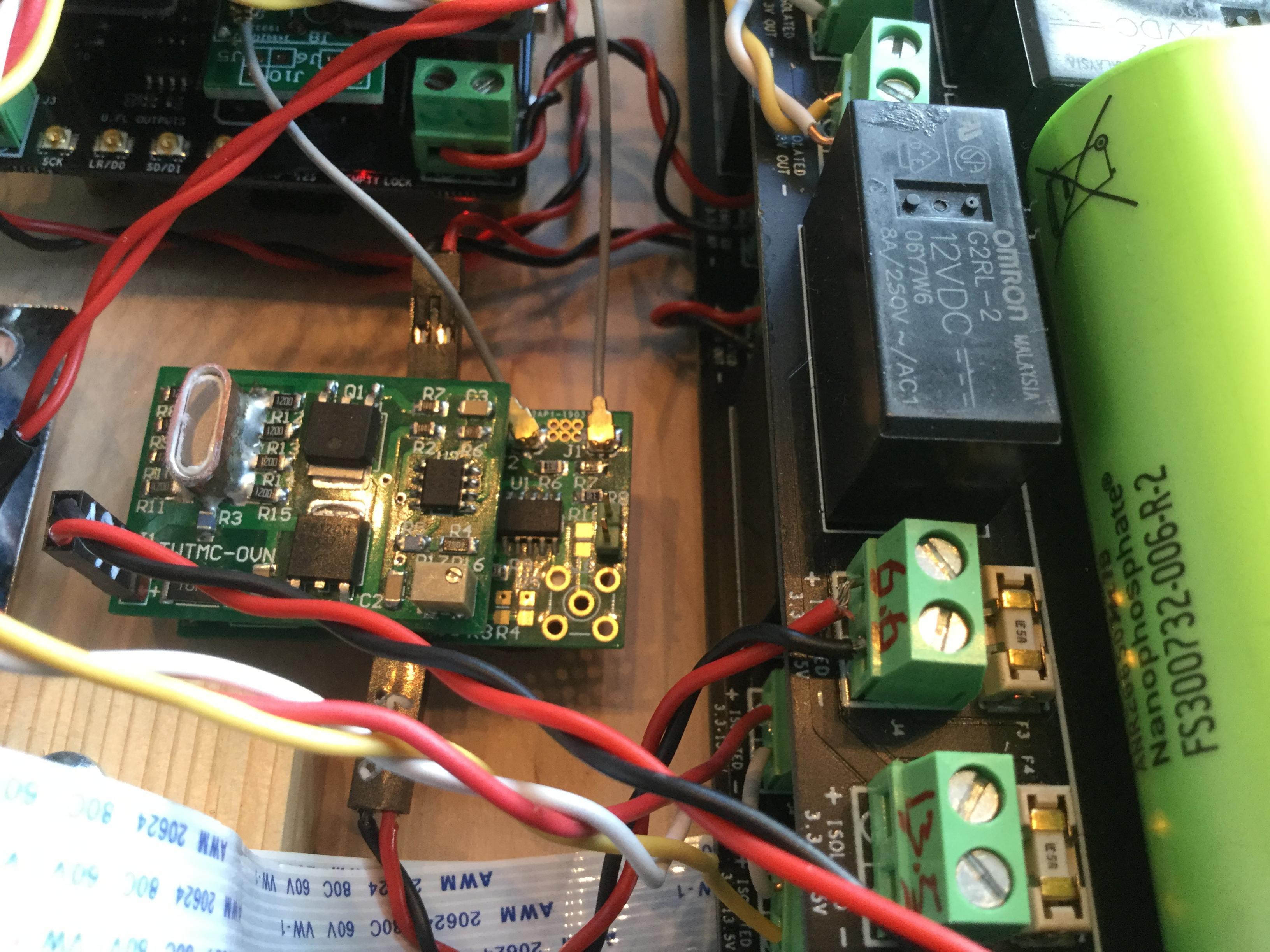

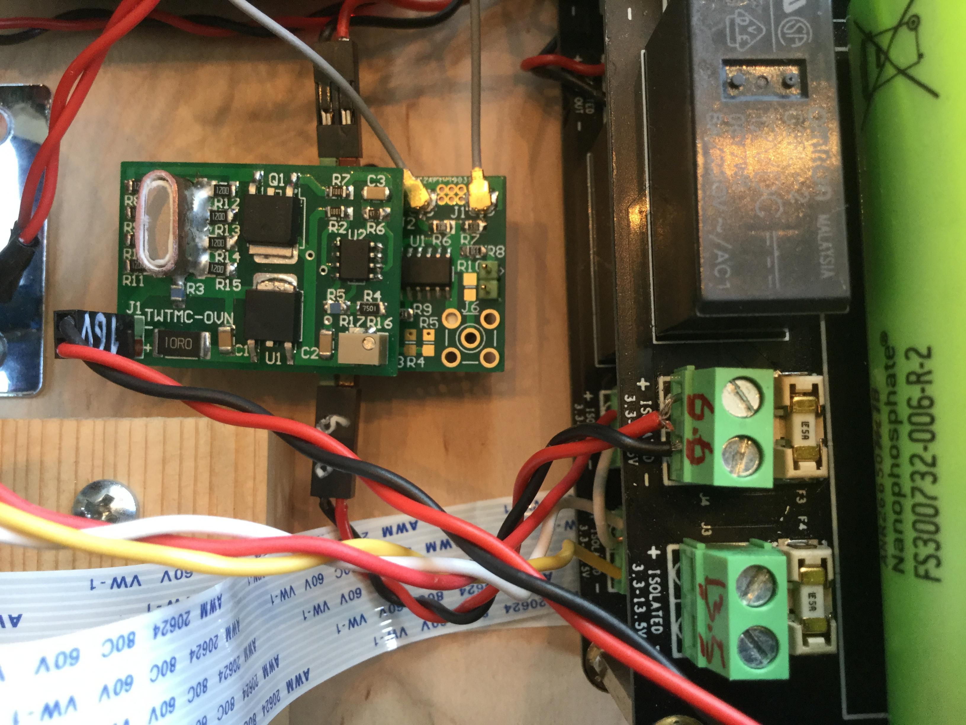

Hi Andrea,
I have finally build the oven for my sc-cut crystal!
The problem is that I cannot get it adjusted.
I use the same laser thermometer as recommended in the manual, the temperatures vary when moving from middle to the edge of the crystal. Getting to 82degreesC is difficult.
Also the transistor is getting really hot (around 80degreesC) is this normal?
There is a lot noise after a minute or so warming up; measuring around 65degreesC in the middle of the crystal. This seems to be frequency drift.
The noise disappears when I switch of the oven, but also when I touch the crystal or oven copper heater tube with a metal screw driver (grounding?).
What am I doing wrong?

The transistor of the oven runs very hot, it's not a problem. Also a little frequency drift is not an issue in digital to analog conversion.
It seems you have a ground loop problem, or maybe the oscillator is catching something from the environment. It could be a power supply ground loop, how did you connect the oven ground?

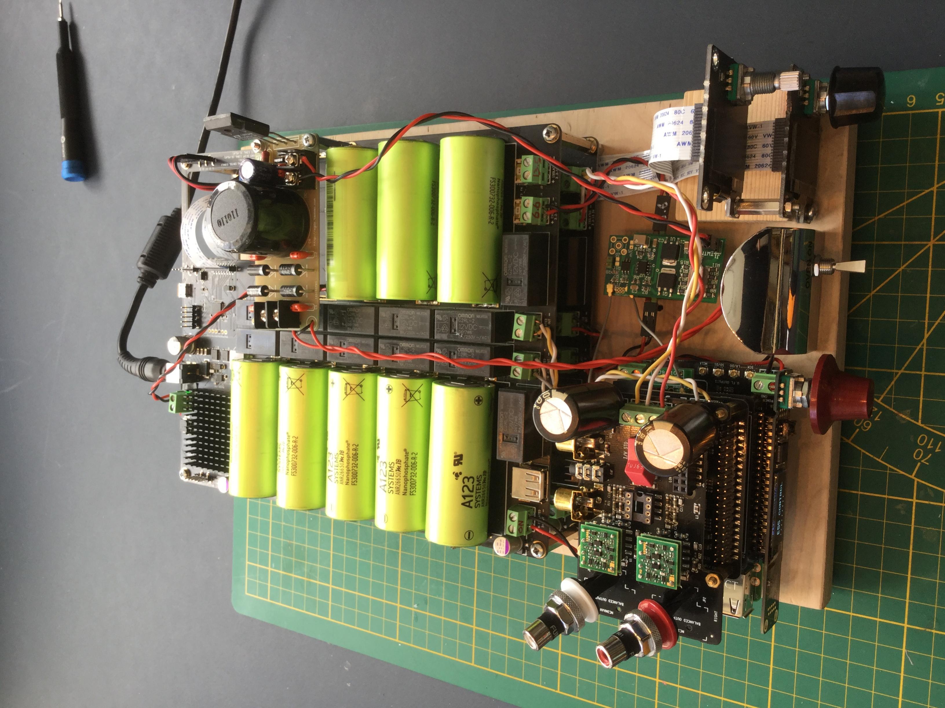

The oven is powered by a separate power supply (the one on top of the batteries) that gets dc power from a connected smps that is feeding the battery supply (charging the battery pack while the dac is off, and feeding the raspberry pi, battery control logic and the oven ps when it is on)
The clock unit and dac is battery powered and not grounded. The oven is also not grounded.
The noise was apparent while testing the streamer with a headphone and wifi connection so only the smps was grounded to the power socket, no ground loops.
The strange thing is that the noise comes up after about one minute when the oven is switched on, when I cut the power to the oven the noise disappears in about 30sec.
I can try grounding the oven ps, but to what component? I want to prevent ps noise getting to the clock or streamer via the connected ground.

I have checked the battery circuit and noticed the - pin from the oven ps is connected to the - pin of the raspberry pi, so they are grounded.
I also did a test with a separate linear ps with toroid for the oven power and this also introduces the same noise, both in floating and grounded to raspberry pi power.
Grounding the dac (via rca output connector) or putting oven and connected raspberry pi - pin to ground of the wall connector does make some difference; the noise level is a bit lower but not gone.
I do not know how to proceed with this 🙁
@Supersurfer:
Hi ... A couple of comments - the first of which is that you don't happen to have a bad soldering/bad connection somewhere on the oven / oscillator PCBs? The timing 60s / 30s might suggest heating and cooling phenomena associated with a bad solder joint ...
And then, if not a bad solder joint, my guess would be that you have some kind of HF or RF oscillation that causes the noise. Looking at your pictures I notice that the oven copper heating plate seems to be very close to the crystal. I reckon that if it actually shorts to the crystal the crystal's noise pick-up area would increase significantly (maybe Andrea can comment here?).
Also, even if you use twisted pair wiring it looks as if you lead them quite close to the crystal/oven assembly. Might I suggest that you try to separate the cables and make them cross at 90 degrees ...
Thirdly, depending on how your detailed schematic and practical build is I wouldn't place an overall grounding near a digital part. As you may know digital signals often are very high frequencies which causes inductive impedances in the traces leading these signals - thus potentially leading to significant voltage potentials between ground points. Personally, I likely would ground the oven onto the oscillator PCB's ground so as to keep the ground loops associated with the oven/oscillator as short as possible - and then connect the oscillator output + ground to the DAC's ground.
Additionally, I might try to increase the input/output capacitance on the 7812 regulator that feeds the oven circuitry (e.g. 1000uF). Not that it may make this circuitry work better - I don't think it will - but it may change the relative "influencing" frequencies that this circuitry has.
Well, a couple of ideas ;-)
