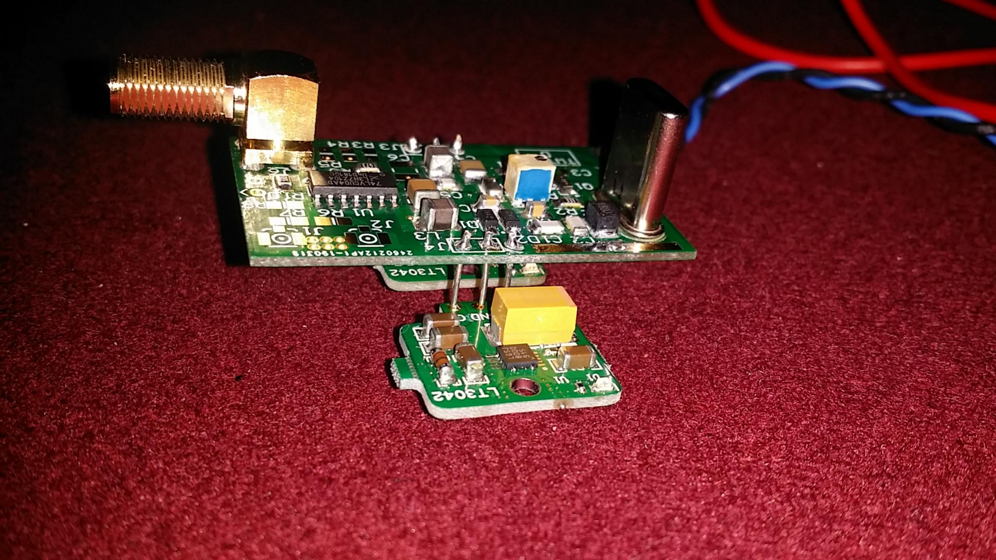

High praise for WTMC impact on sound
Well, we may not have the jitter spec nailed down, but I confirm that the impact on sound is fantastic. I have had the 45mHz clock running now for a few days. Certainly takes the DAC to the next level. Thanks again Andrea for sharing this innovation. I'll comment more fully in a few weeks when all finished and burned in.
Thanks for sharing your impression, I'm very glad you got a sound improvement.
