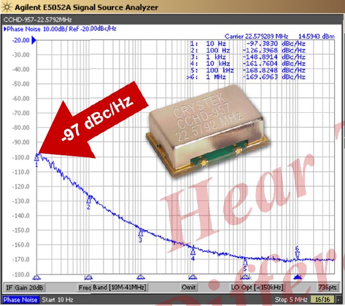

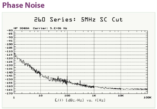

Just for comparison, please take a look at the pictures below. They are the phase noise plot of two oscillators, the Crystek CCHD-957 at 22.5792MHz and the MTI OCXO 260 at 5MHz.
As you can see the phase noise measured at 10Hz from the carrier is a bit different: -97dBc for the Crystek and -140dBc for the MTI. Also if you add -6dBc to the plot of the Crystek (dividing down to the same frequency of the MTI - 5MHz), the performance of the two oscillators are very different.
This means that the Crystek seems to be a poor oscillator while the MTI is a SOTA oscillator.
This also means that the 5MHz is the ideal frequency to get the best phase noise performance.
