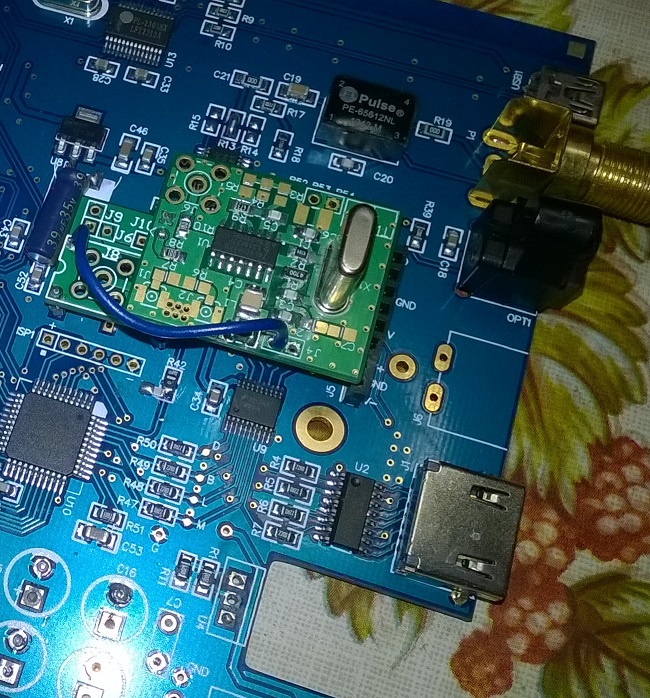

I have just done one more test with another oscillator that confirm the previous session.
- TWTMC-P Pierce with budget HC-49/U AT-Cut crystal from TFC powered by the on-board Aune regulator
2) Score: 6+. Comparing the result with the TWTMC-P cold welded HC-43/U AT-Cut crystal from Laptech and isolated power supply, the difference is clearly audible. Bass are less dumped, vocals have lower thickness, upper octaves are less smooth. The soundstage is not so wide and deep as the big Pierce, unplugged music is less realistic. BTW it remains detailed and never harsh and confused like the Cristek. You can listen without getting tired after a few minutes how happens with the Cristek. Obviously, the differences are not shades, but it never becames harsh and aggressive and keeps a decent level of detail, while the Cristek sounds always confused, with lack of detail and harsh character. All in all the result is appreciable, since it uses a cheap crystal and a questionable power supply.
Again the crystal makes the difference. The budget HC-49/U TFC crystal has anyway a Q around 90k and ESR less than 5 ohm, that's a remarkable result for a cheap resistance welded crystal. I wonder what is the Q of tiny crystal used in the Cristek oscillator, I suspect very low, and I suspect that explains the sonic results.

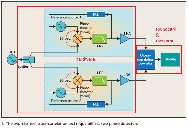

Gerhard,
can you develop the hardware and design the PCB?

Gerhard:
The Agilent analyzer is a pretty powerful box. No wonder it took you quite a while to figure out controlling its feature set.
For audio I'm not convinced that noise above 100 KHz is all that important. it is for other applications. The importance of close in noise is what is being explored here so response to 10 Hz or less is important. In this context a soundcard would be adequate.
I would think that adding the extra components to Andrea's dual Driscoll to implement the block diagram should not be too difficult, especially if the noise floor of around 1 nV/rtHz of an LME49990/AD797/LT1024 would be low enough.
remaining questions on this-
1) reference noise source- couldn't a voltage modulated oscillator provide a suitable reference if all the details are worked out? A sinusoidal modulation with peak voltage matching the frequency offset from a known voltage could be translated into a known phase noise level? Getting some reference is important. I think there is something in the Wenzel lit on that issue as well. They also have a procedure for manual calibration that is not real easy to follow on paper.
2) Could we start with 24.568/22.5792 MHz and a multiplier/divider for all the variations? or do we need discrete oscillators for each frequency?
3) Do we need an input signal conditioning stage? A limiting amplifier to get the necessary level and remove amplitude noise?
Are you setup to plot the Jtest output of a DAC with the different oscillators? I think it would be really interesting to see if it shows anything meaningful.
