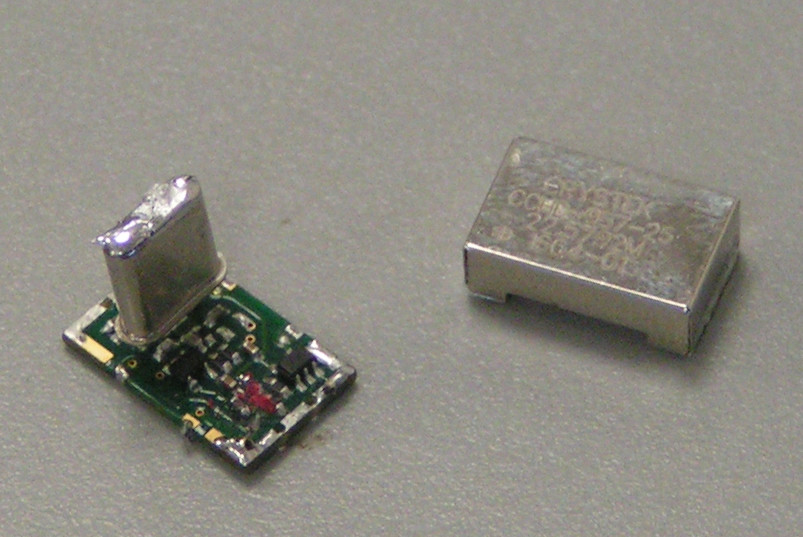

We could improve the clock buffer. Look for the low noise CMOS oscillator on this website
Low Phase Noise Design: Crystal Oscillators
The low noise CMOS oscillator has a single 74AC14 on the output. These have specified jitter of 0.99ps that is an improvement over 2.2ps of a 74HC04. But this will limit output power.
Even better would be removing the clock buffer alltogether. In this case we need something that can provide a low output impedance with sufficient drive capability like a transformer for example. We use it in tube amplifiers where we have a similar problem, driving a low ohmic speaker with a high ohmic output stage.

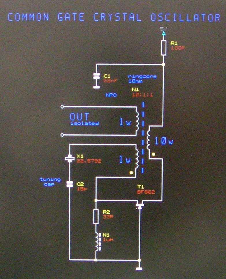

I attached a schematic of a grounded gate crystal oscillator circuit based on a 10:1 RF trafo. I measured approx. 10 Ohms output impedance without any clock buffer.

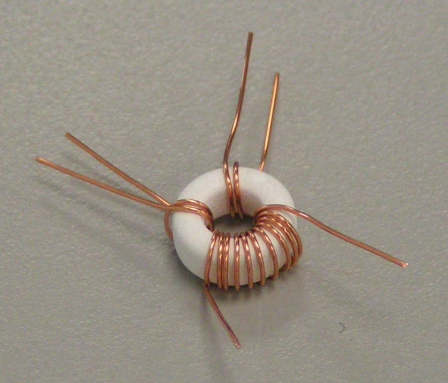

The next picture shows the transformer, two windings with one turn each and one winding with 10 turns.
So what do we have, a common gate circuit based on a BF862 (low noise RF JFET designed for car radio reciever front ends), low input impedance (source) and high output impedance (drain). Miller is not bothering us as we use a common gate circuit, bandwidth is maximum.
The drain (high Ohmic) drives the primary, don’t attempt to measure a signal here, it will stop oscillation. So keep this signal path as short as possible with lowest possible stray capacitance to GND.
The ac voltage across the primary will be around 20… 25Vpp depending on the VDS of the JFET. The circuit will protect itself (high Ohmic).
The 100 Ohm resistor is used to bias the JFET for linear operation and you may have to play with its value to find the right bias current as JFETs have tolerances. The 1uH choke in the source is necessary for oscillation (phase shift). You have to change its value depending on desired crystal frequency (lower frequency, higher value). This schematic is designed to operate around 23 MHz.
The crystal and feedback choke are connected between source and GND, the signal is attenuated and injected through the feedback winding (observe polarity or the circuit won’t oscillate).
The feedback winding offers low output impedance (transformation ratio) required for operating the crystal at series resonance for lowest phase noise.
The output signal is taken from the third winding, with this circuit you can expect around 2 … 2V5pp, sufficient to directly drive 3V3 circuits using a decoupled 1V65 voltage divider as reference. The secondary winding connects to this voltage reference and to the clock input. The clock input is held at 1V65 for optimal detection.
Over-driving an input will result in increased ground bounce and more unwanted harmonics, driving 3V3 logic with slightly lower 2 ... 2V5 signal avoids these unwanted issues.
The oscillator draws approx. 6mA @ 5V. It works at lower voltages too, but you may have to lower the value of the 100 Ohm resistor. This means battery powered operation is also possible.

I think the oscillator using a transformer is pretty neat. You would probably need a tuning network to get it to oscillate on the right harmonic etc. You are still at the mercy of the noise of the amplifier but you can optimize the coils for the best impedances for low noise. I would think a low noise wide band CFA (LME 49713?) might be very good in this implementation. However logic is not a nice linear load. It will draw a burst of current when the device switches. You also want a very fast slew at the input of the logic to minimize the impact of any noise in the system. Possibly a limited/clamped output swing.

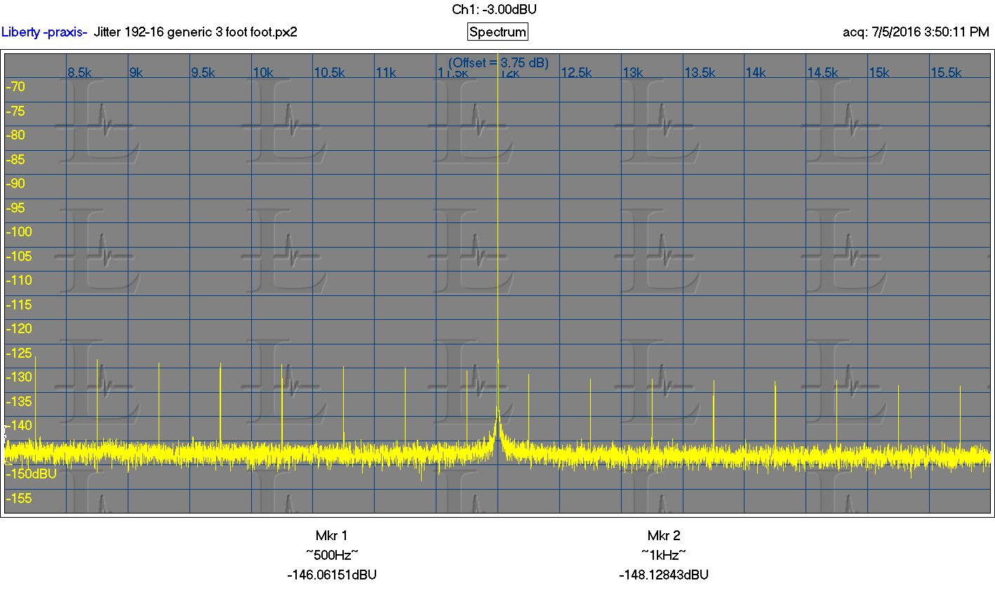

Just as a reference here is the jitter measurement I made recently of a modest USB DAC (Xmos U8 AK4490 Audio HiFi Asynchronous USB Decoder DAC with Headphone Out PSU | eBay)
Its formatted as closely to the Stereophile measurements as I can with different hardware. Essentially free of jitter/phase noise artifacts. The unit has two small crystal oscillators of unknown origin. It also has very low distortion if you swap the original socketed opamp. I used an LME49720. If this is the baseline, it will be hard to improve upon.
I have measured some older premium DACs that were not as good but technology marches on and they aren't relevant any more.

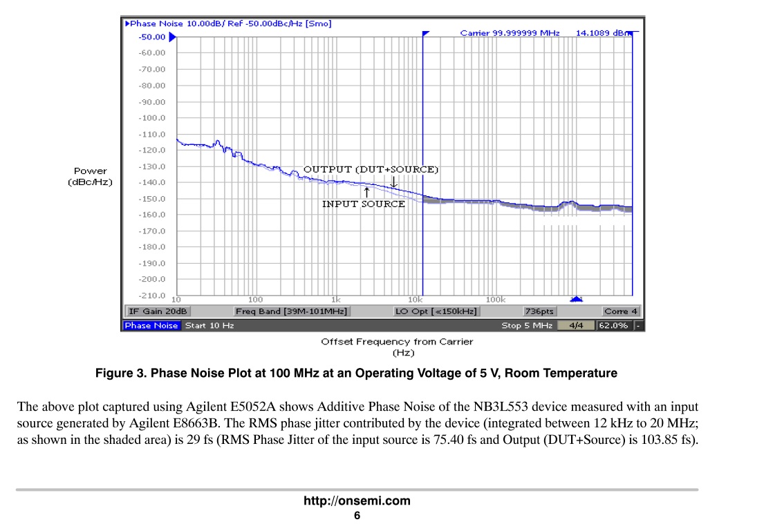

It would be great to see phase noise measurements for this oscillator,
otherwise we don't really know, it certainly looks like a cool idea but I think measurements are needed to know.

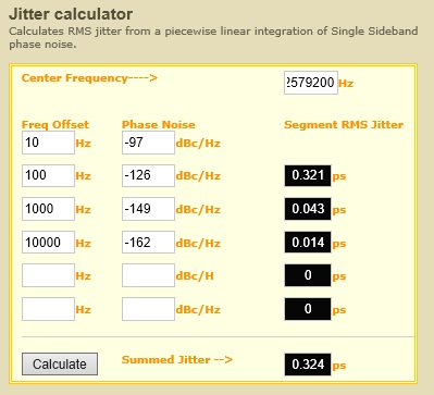

Jitter is really a difficult parameter to use because of its "unbounded" nature. Phase noise vs. frequency is much more useful.
That's the reason to talk about phase noise rather than jitter.
The bounds of the integration bandwidth affect heavily the result.
For example, if we calculate the jitter of the Crystek CCHD-957 at 22.5792 MHz from the phase noise plot included in the specs we get 324 femtoSec, because the lower limit of the integration bandwidth is 10 Hz.
If we calculate again the jitter adding a lower point, closer to the carrier such as 1 Hz, assuming 30dB worst than the point at 10 Hz (optimistic), we get 3.15 pS, that's an order of magnitude higher than the previous.
The higher the lower bandwidth limit, the lower the jitter. Increasing the lower bound any oscillator is similar to each other.
Phase noise vs frequency is an absolute value anyway comparable: the above Crystek shows a phase noise of -97dBc at 10 Hz from the carrier, there is no bounds issue.

the picture shows a 2T:10T design. is it a 4C65 core ?
coupling is not perfect, maybe split the 10T winding in two 5T with the 2T's in between ?
N30
B64290L44X830 - EPCOS - Transformer Cores, Toroid, Toroid, N30, 30.09 mm, 12.23 mm² | Farnell element14
I also thested these smaller versions (6.3mm) and no problems with these either, except it gets more difficult to locate all windings on such small former while maintaining minimum coupling capacitance.
B64290P37X830 - EPCOS - Transformer Cores, Toroid, Toroid, 6.3mm x 3.8mm x 2.5mm, N30, B64290P0037, 15.21 mm, 3.06 mm² | Farnell element14
This is N30 material too.
I use this oscillator for driving circuits on both sides of a galvanic insulation barrier (synchronous reclocking before and after magnetic pulse couplers).
So I need minimum capacitive coupling between the windings here. This configuration is used to eliminate ground loops between USB audio receiver and DAC.
I could not get the circuit to oscillate in ltspice. only at 2T:10T and by cascoding the jfet with a bipolar or same jfet . w/o the cascode, only at lower ratios. 1:2-1:3
Simulations are only as good as the parameters you enter, and you always forget some.
I built 3 of these oscillators and all oscillated without any problems. I did add a series resistor to the output for impedance matching and current limiting. When too high current is drawn (short-circuiting the outputs), oscillation could stop.
When higher output voltage is desired one can use two turns for the output winding.
Cascoding would limit voltage swing at the primary JFET drain, might offer some advantages, I will try that.
However, in audio circuits the cascoding of transistors would introduce a racing condition between two FETs or transistors that attempt to maintain equilibrium. One FET transistor equilibrium is disturbed by the other and vice versa.
This does not work out very well for audio circuits where it causes a gritty, overbright fatiguing sound.
I am not sure how this racing condition would translate to oscillator phase noise spectrum.
Up till now I had best results with oscillators based on a single JFET or transistor where such racing condition can’t occur because there is only a single servo.
I tested Crystek CCHD-957 and the performance was simply lousy.
I opened one up to figure out what was causing it (picture).
Inside is a plain Pierce oscillator based on a NC7SZ00 logic gate and a NC7SZ126 buffer. That explains a lot, it’s hardly better than an integrated oscillator in a CPU.
I had much better results with cheap NDK or Epson oscillators (2.5 x 2mm SMD version).
The oscillators were tested in the same circuit running on the same clean power supply.
It was connected to a discrete Mosaic multibit DAC that directly drives high ohmic Beyer Dynamics studio headphones (DC-coupled passive pure resistive output, no semiconductors) . This combination reveals much more that audio sets that add coloration and noise. So if there is anything "wrong" with the master clock, this setup will reveal it immediately.
strange, the N30 material hardly extends beyond 1Mhz, so the transformer is far from ideal and it's properties enter the equation. what could happen is that the active element is only active a very short percentage of the time, resulting in a low noise behaviour. the signal is then away from sinusoidial and symmetry..
