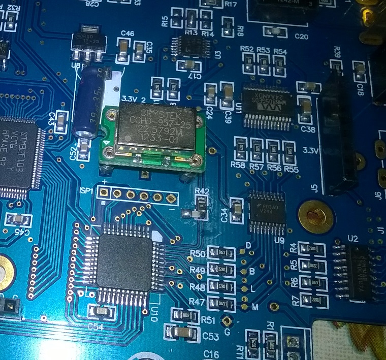

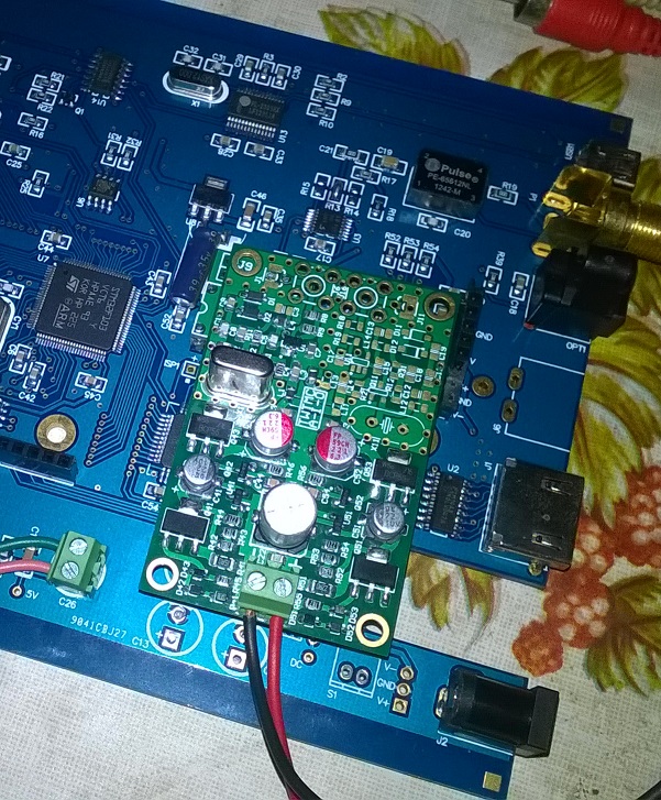

I tested Crystek CCHD-957 and the performance was simply lousy.
I opened one up to figure out what was causing it (picture).
Inside is a plain Pierce oscillator based on a NC7SZ00 logic gate and a NC7SZ126 buffer. That explains a lot, it’s hardly better than an integrated oscillator in a CPU.
The phase noise plot just tells the story.
But the simple Pierce itself could be the best oscillator at this frequency, so what's wrong?
Used gates aside I believe the crystal makes the difference. Someone very known in the diy audio circle got -122dBc at 10 Hz from the carrier with a simple unbuffered '04 Pierce oscillator. He got this result using a 0.35 USD crystal strongly selected from a bag of them. Most of them were discarded because they performed very bad.
A good crystal (cold welded package, polish finish, harmonic rather than fundamental, high Q and so on) makes the difference regardless of the oscillator type.
That's the reason why Croven, Nofech and so on are still in business. Obviously their business is telecommunication, but their crystals (or similar from other brands) are a good starting point to get oscillators performing the highest short term stability.

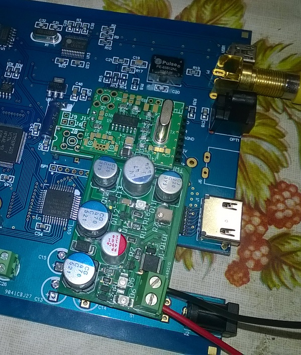

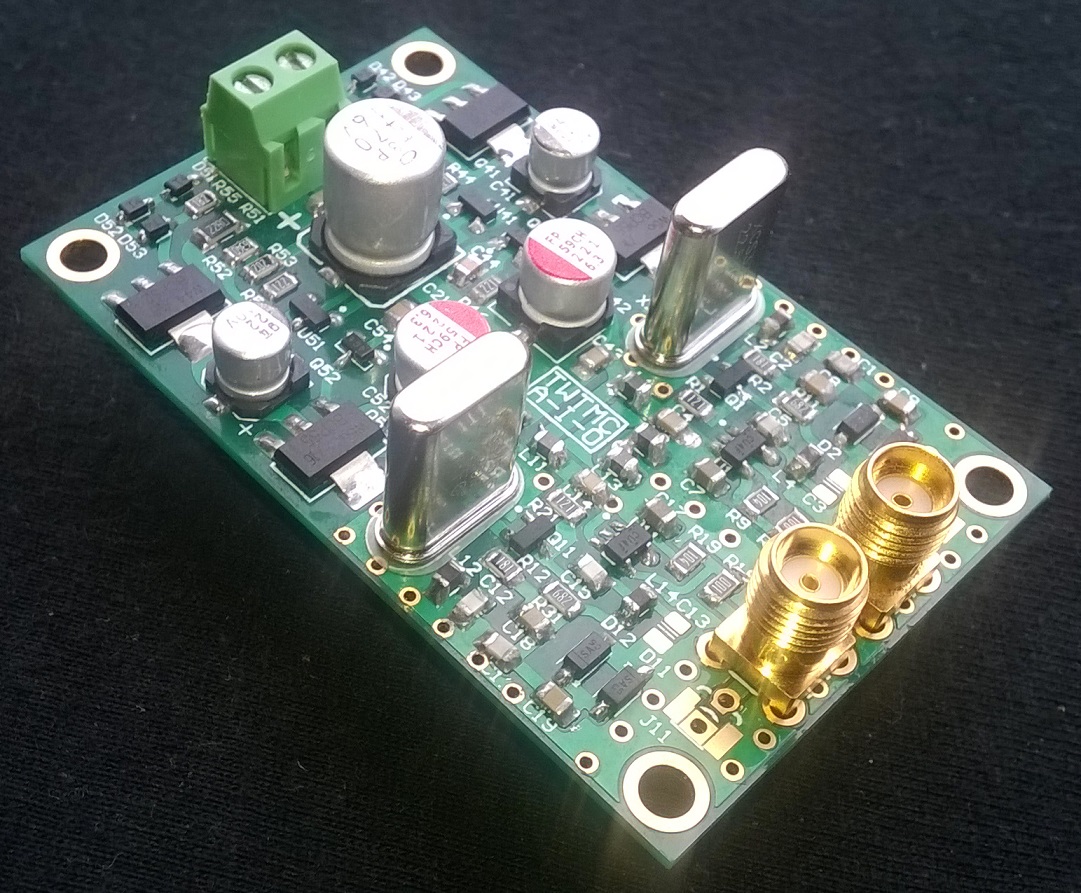

TWTMC All in one
This is the TWTMC-AIO All in one combo oscillators.
There are 2 Driscoll oscillators at 22.5792 MHz and 24.576 MHz and 2 shunt regulators at 6V and 3V3.
It needs only a 9 to 12VDC unregulated or pre-regulated power supply.
Crystals are HC-49/U fundamental from TFC (Laptech's sister). Their specs are very good for a budget crystal in resistance welded package.
The board can be upgraded with Laptech HC-43/U crystals without any changing of the other parts.

I had much better results with cheap NDK or Epson oscillators (2.5 x 2mm SMD version).
The oscillators were tested in the same circuit running on the same clean power supply.
It was connected to a discrete Mosaic multibit DAC that directly drives high ohmic Beyer Dynamics studio headphones (DC-coupled passive pure resistive output, no semiconductors) . This combination reveals much more that audio sets that add coloration and noise. So if there is anything "wrong" with the master clock, this setup will reveal it immediately.
Did you make any measurements of the Crystek? Was listening your only means of determining performance?
At this level implementation will hugely affect the performance. Things like ground bounce will seriously degrade the clocking after its left the oscillator. Making broad claims really requires evidence.
A well executed inverter based oscillator could be a fine solution. Wenzel suggests it. The Tinylogic inverter may be a good choice depending on whats inside it. The measured performance is on a par with the NDK oscillators. Have you opened an NDK? The NDK is so small its crystal will be tiny and that may affect it.
Oscillators integrated into the chip have major issues with interactions with other functions inside the chip so claiming an oscillator based on an IC won't perform is a little short sighted. Its all about context.
Your right in that a multibit dac will be much more sensitive to jitter. Which is a good argument to move past multibit DAC's.

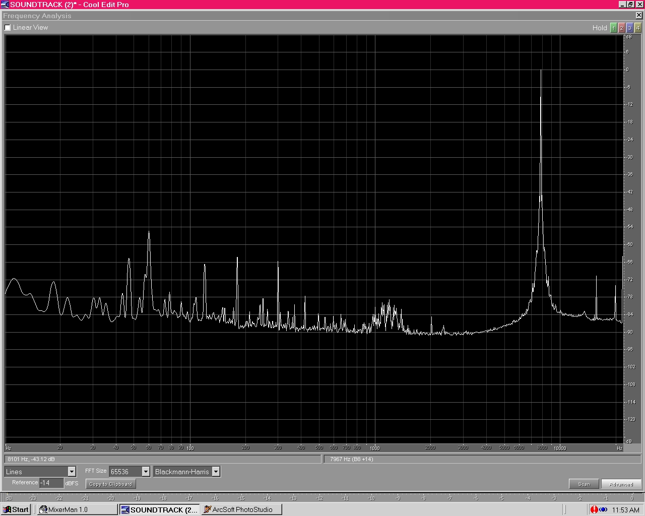

Flutter
Wow and flutter is a term I thought I never hear after I bought my firs CD player around 1983.
Old tape recorders comes in mind. Fortunately I'am a junk collector and in my basement is a Studer B67 and a bunch of test tapes. So I was running a test to see differences tape vs. CDP. Since the human sound recorded heritage fom the late 40's to ca. the late 80's was created on reel to reel machines ,and I don't hear complains about flutter in the piano recordings and I personally satisfied with those old records, I take it as a reference for audible flutter threshold. Since the last tree years I measured ca, 50 CDP's and DAC's with my QA400, I take the worst of them the Sony CDP-350 and the Wakibaki's Jitter3 track to compare to the tape recorder.

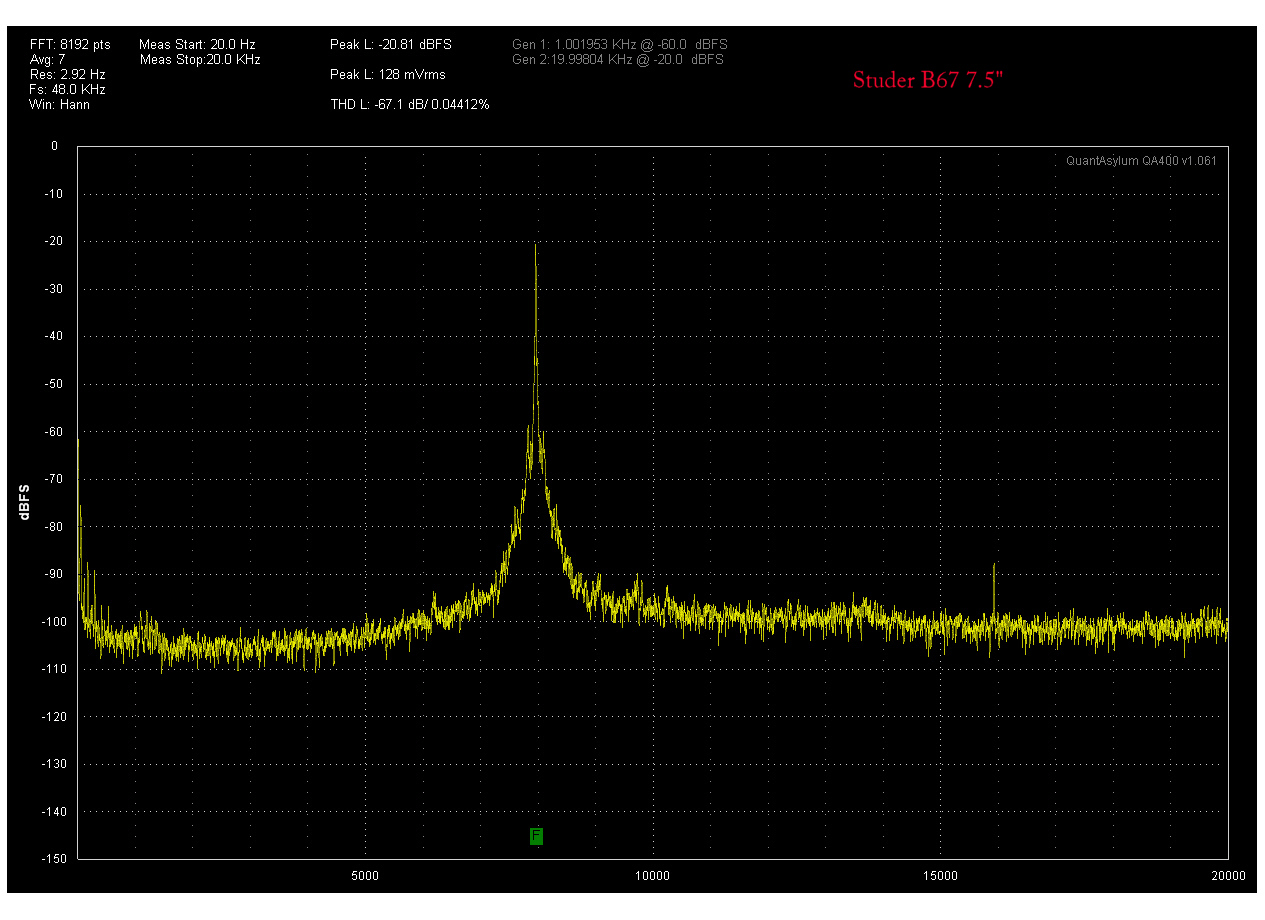

Those measurements do highlight some of the important questions about sensitivity. As poor at the CDP looks in the plot the B67 is just much greater. It would take some sophisticated signal processing to get the 250 Hz component out of the noise if its there.
A higher resolution plot of the B67 would show the power line modulation (50 Hz?) plus once around for the capstan motor and the reel motors. Scrape flutter will not have as clear a noise spike since its somewhat broadband but will contribute, possibly in spreading out the peaks. Still those were considered not audible and now we are chasing artifact 20 dB lower. The artifacts that will really matter are the deterministic (clear single frequency) that show up.
The problem is that the QA400 has a long settling time in high resolution , and the test tape tracks are to short for that (maybe my computer is to slow). I made a recording in the computer and used the Cool Edit to analyze the file. The test made in Toronto, so it's 60Hz and it's harmonics. The Studer has Papst type outer rotor motors, which are generating less of the disturbing fields. The program not allowing to zoom in close to skirt so it's difficult to see details of the modulation noise.
I bought two of Andrea's boards and I now have two Laptech crystals, I can start to populate the boards and with time I can run a test with the help of Wakibaki's test track. I measured much better CD players than the above Sony one, also tried to swap crystals in them and saw differences in the jitter tracks skirt. So that would give a hint of the performance of the oscillator.
Your computer is fast enough. High resolution measurements need lots of samples, and averaging still more. You are getting good data. In the CD players if the crystal is tied directly to a processor chip the chip will jhave a lot of influence on the system. Most likely any logic action will modulate the oscillator. What works well for me is to leave the stock crystal in place and injection lock the on board oscillator from a more stable external clock. Typically 10 pF to the input side of the internal gate is enough to lock to the external oscillator. Usually it doesn't disturb the local oscillator when disconnected either.

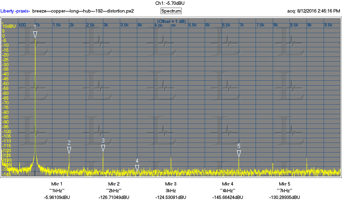

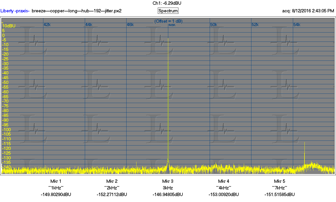

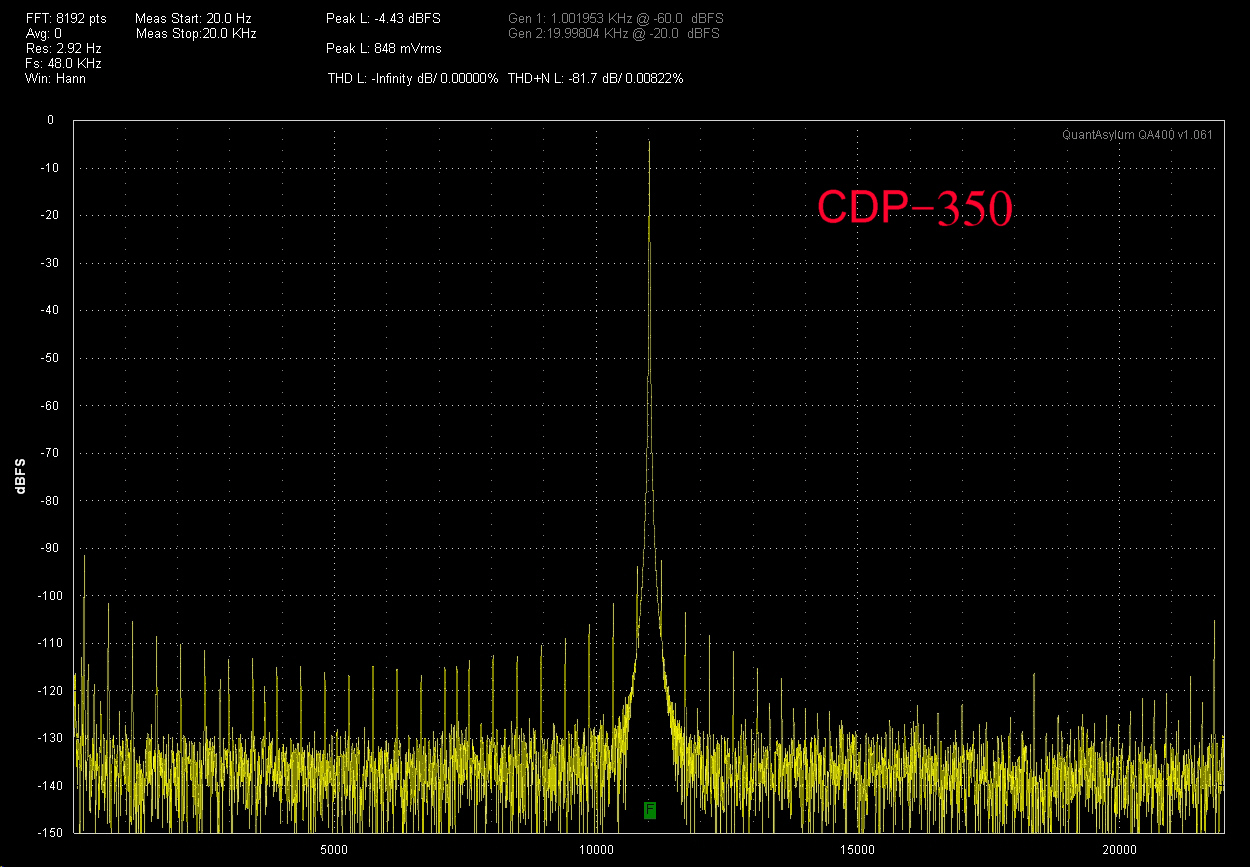

Just as a reference here is the jitter measurement I made recently of a modest USB DAC (Xmos U8 AK4490 Audio HiFi Asynchronous USB Decoder DAC with Headphone Out PSU | eBay)
Its formatted as closely to the Stereophile measurements as I can with different hardware. Essentially free of jitter/phase noise artifacts. The unit has two small crystal oscillators of unknown origin. It also has very low distortion if you swap the original socketed opamp. I used an LME49720. If this is the baseline, it will be hard to improve upon.
I have measured some older premium DACs that were not as good but technology marches on and they aren't relevant any more.

Below is a distortion plot from the Breeze (modified with a LME49720 opamp) and a jitter plot of 48 KHz at a 192 KHz sample rate similar to the usual jitter plots except no 1 bit modulation. Its completely clean of jitter artifacts. One tip, the power supply must be 12V or more or you get distortion. I don't think the one they supplied was. These were made with a generic switching supply. I tried a linear supply and got a lot of 60 Hz modulation on the clock for some reason.

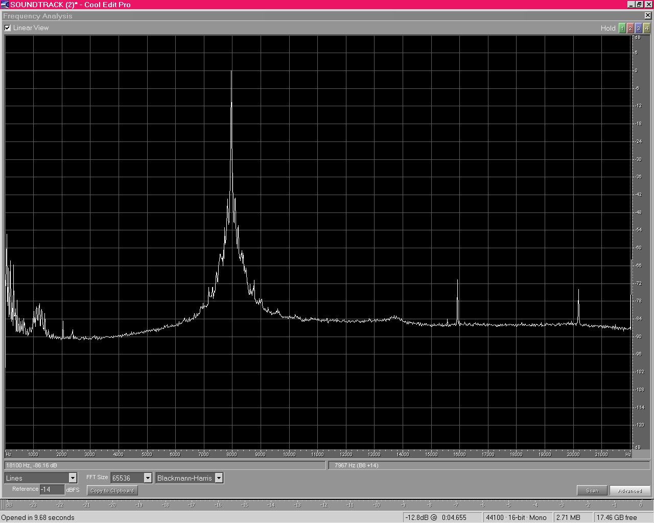

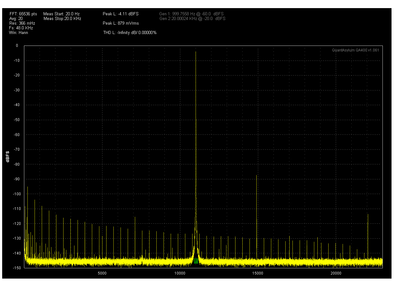

Your measurements are very impressive, here's the jitter spectrum as the QA400 sees it, the source is Wakibaki's Jitter3 file running on a laptop computer, on the unmodified Breeze Audio USB DAC. I don't know the source of the 15kHz signal. The rest of the results will go to the QA400 thread, since this is Andrea's oscillator thread.

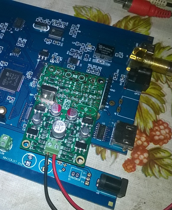

First, use a 12V or more DC supply. There are no rectifiers in the unit. At less that 12V the audio starts clipping at FS.
Second, jitter shows up as symmetrical tones around the dominant carrier. In your case 12KHz. The two strong tones are jitter I think and may be an artifact of the power supply or the USB packet rate. Another jitter frequency common in USB comes from the USB signalling- its either at 1 KHz or 4 KHz, the packet rate for USB. That may get in through grounding in some way. Fiddling with power supplies, grounding, wire layout etc. may help isolate the source of the jitter. The QA400 is not ground isolated so you may get something from the two separate USB devices have grounds connected together. if you can use separate computers and isolate that way it may go away.

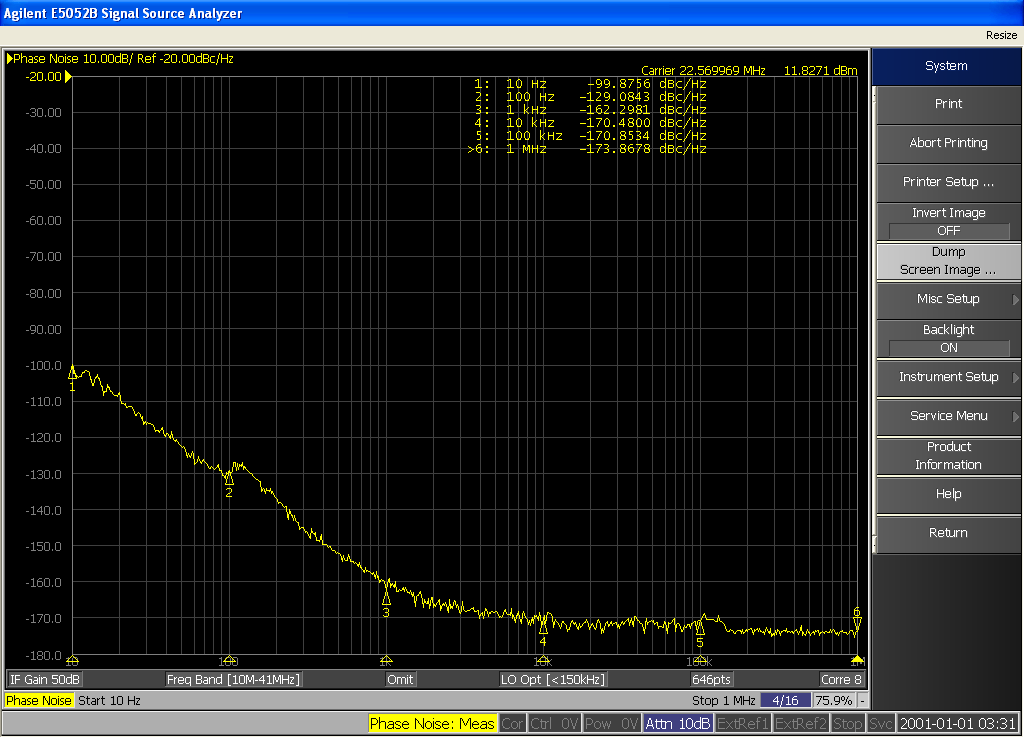

Attached the measured phase noise of the Driscoll All in One oscillator board. The crystal is a budget resistance welded HC-49/U AT-Cut from TFC.
The plot shows that the phase noise close to the carrier is better than the Crystek at the same frequency, and much better than the Crystek one at 1 Khz from the carrier and above.
Keep in mind that I have randomly picked a crystal from the bag of samples I received from TFC, no selection was done. While, probably, the phase noise plot in the Crystek datasheet shows the best performer they have measured.
