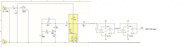

@Andrea .. Just a quick question with respect to the Pierce oscillator: Building the Pierce oscillator and supplying it from 6.7 volts - would that be ok? And can I use the components specified in your TWTMC-P for the 6.144 MHz version?

You have to use an unbuffered '04 7V tolerant.
The parts value in the BOM are OK for 6.7V, power dissipated in the crystal is around 100uW.

Alexiss .. I read what you are writing and I have no doubt that you have both experience and knowledge in this field ... But personally I have this feeling of being the rabbit tempted with a carrot that it cannot reach ... Any chance you can be specific about which alternatives you would suggest?
BTW I am concluding laying out a Pierce oscillator today (according to Andrea's design) and so if you have suggestions for changes I'd appreciate if you can share them in due time.

My recommendations on the Pierce is a discrete design, with a disrete buffer - yes, a buffer, not an inverter used as such.
I think I saw one in a book recently. Just google it & if u dont find anything, let me know.
The Inverter-based Pierce is ok for u-processors, but not for high performance design that people crave on this thread.
Pierce has, in my opinion, the best performance <20 MHz with normal transistors. It is an deceptively simple circuit, but dont be fooled.
Colpitts and Driscoll are very good but not as good as Pierce at low f.
I know Herbert does not agree, and i'm willing to listen to him, he is very knowledgable in osc design.
Hi Alexiss ... Thanks for your prompt response and suggestion.
Hmmm ... as it is I will admit to not having the discernment in this field that will (quickly) allow me to sort between the circuits I find when googling. Also, as it is the Pierce circuitry Andrea has suggested won't feed a very long path - it goes into a divider which I reckon also has quite a say in the final quality of the oscillator.
Here I use a FF - but am a bit unsure of which FF to choose - but guessing that one of the reasons why Herbert's oscillator achieves these fine phase noise figures may be due to the high voltages I most likely will use the same series FF (i.e. an HC74 version) and feed it a high voltage.
However, if you or one of the other "oscillator insighters" here has a better suggestion I'm all ears (although - as I wrote - I'm wrapping up this layout today).
Jesper
Hi Alexiss ... Thanks for asking ...
What is your oscillator frequency?
The crystal is a 6.144 MHz AT cut from Laptech (courtesy Andrea) which I then divide by /2/2 (i.e. 4) to arrive at 1.536 MHz.
I basically use the circuitry that Andrea has outlined in his TWTMC- D&D (link here:
http://www.diyaudio.com/forums/digi...itter-crystal-oscillator-123.html#post4759763 - top part of schematic on P. 2)
i.e one dual FF IC (74LVC74 or 74HC74) to make the division. The Pierce circuitry also is similar to Andrea's although with some layout changes. I don't use any resistors between the 74HC(U)04 and the FF input - the track length is about 34 mms. Following the FF there are resistors to the ADC inputs. Supply voltages are 6.7 - 6.8 VDC.
I hope this gives an idea about the setup I intend ... Might you have any ideas/suggestions?

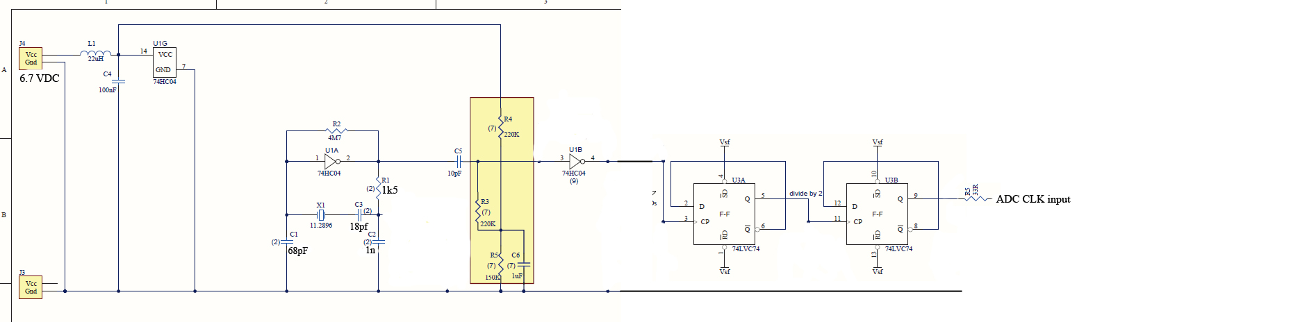

Hi again ... I have taken the liberty of cutting & pasting from Andrea's schematics. It basically looks like this ...
