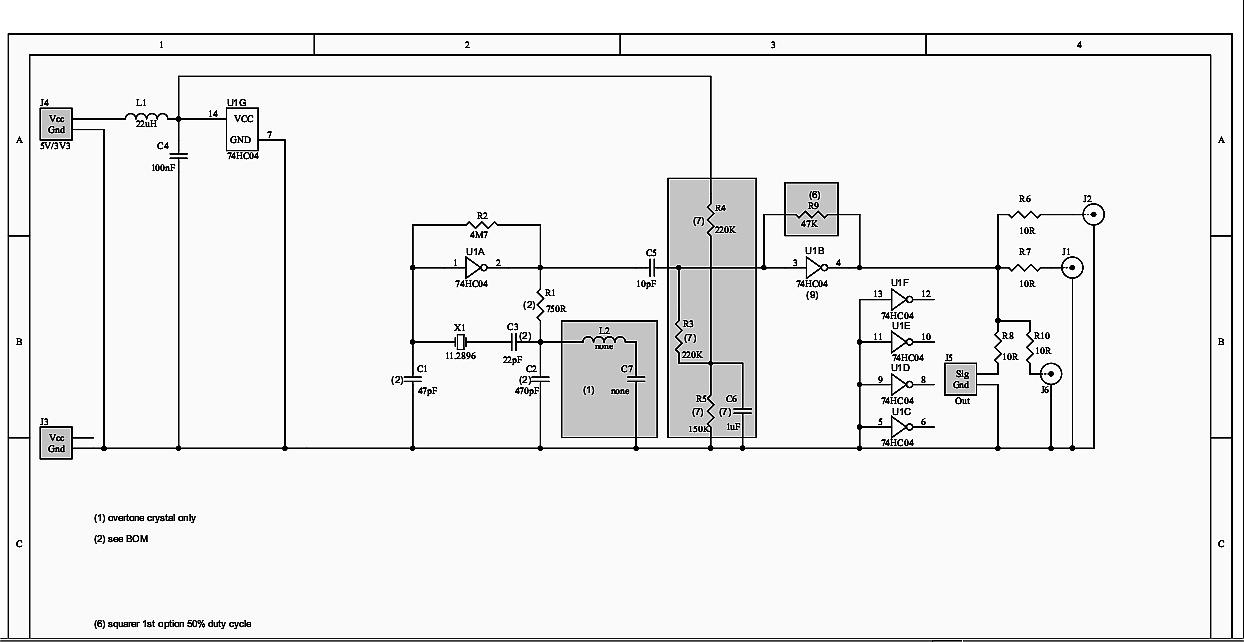

However, I'm curious here and found this Pierce-style-oscillator example on the internet (attached). I've drawn up the circuitry in LTSpice (a .asc file) so maybe I can ask you to "fill in the blanks" in terms of values and add possible improvements? Please remember the 6.8 VDC limitation.

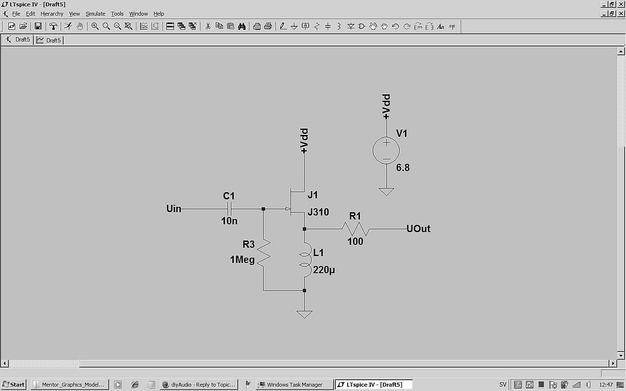

We aim to please...
2 resistors, 1 inductor, 1 cap, 6.1 MHz, Vdd = 6.8 Vdc. (R1 may be eliminated to: 1 resistor, 1 inductor, 1 cap).
If you really want to go at it, you can eliminate c1, R1, R3 and the circuit would still function but
the output DC voltage of the previous stage should be known
and you may need to add an appropriately sized resistor in the Source-path of the active jFET.
The circuit would then become: 1 jFET + 1 inductor
...I found this Pierce-style-oscillator example on the internet (attached).
Can I ask you to "fill in the blanks" in terms of values and add possible improvements? Please remember the 6.8 VDC limitation.

This version will not be that different from an inverter-based Pierce. The Pierce designed by Andrea is actually very good.
I keep forgetting that many fellow diy:ers want SIMPLE circuits with excellent performance. Sorry.

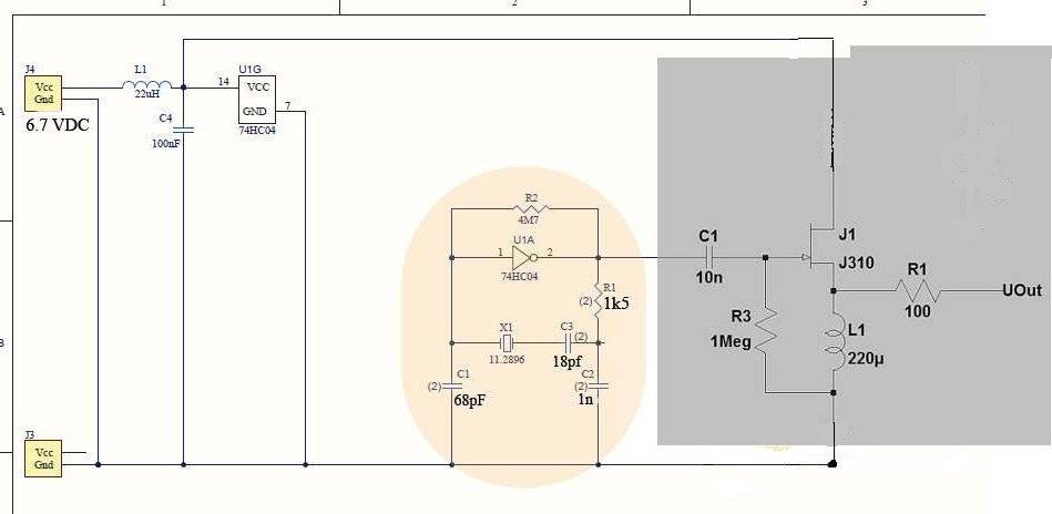

Thanks Alexiss for the feedback & "simplifying" the buffer ... It looks interesting to me - will consider it 😉 .... I may have missed something though which is what you will put in front of the buffer?
Would it look like the attachment (orange area the pierce like Andrea has outlined)?
Jesper
Something like this:

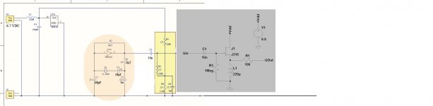

@Alexiss: I think what I'll do is to make one each of the Driscoll, Pierce (Andrea's version) and then your version with the discrete buffer. And then I'll compare them. Layout-wise I've made the Driscoll and Andrea's Pierce version already so it should be accessible to do a discrete buffer version as well. In practice it will take a little while though as I have a vacation coming up.
However, I've also come to think of a potential "challenge" to this setup this morning. As it is the oscillator (i.e. the FF after the oscillator ) will feed into 6 converter gates. With e.g. a 5 ns effective rise time and a 60 ohm resistor on each converter "leg" the peak load on the FF output (or a buffer) will be just about 38 mAs (taking into account trace inductances and capacitances). Which may not be a challenge in theory (looks as if the peak currents are acceptable to CMOS ICs) but have you any experience with how this may affect jitter/phase noise figures in practice? And in case I consider placing a J310 buffer after the FF its IDSS of 24 mA (typ.) will be too low unless it is significantly increased ...
Another option may be to reverse the sequence of the FF and the buffer/inverter so that the oscillator itself feeds into the FF and then - subsequently - into an inverter/suitable buffer ... This would remove the load from the FF to an inverter/buffer (here assuming that FFs and inverters have similar characteristics) which I reckon could be beneficial ... ?
Any chance you have experiences/suggestions with this that you can share?

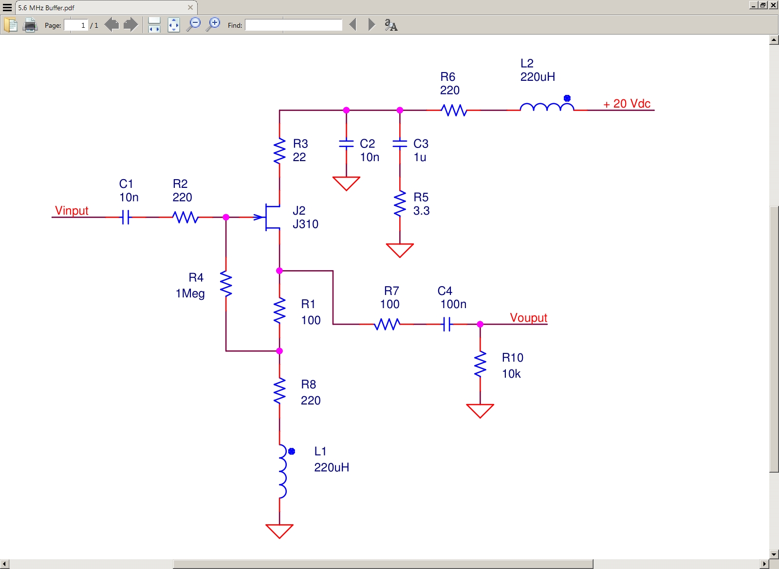

Well, I am a little uncertain of your design goals.
I have to remind you that the simplified buffer (the last schematics) has some compromises built into it.
This is because you needed simplicity. The best one would be the first buffer.
...the FF after the oscillator [/B]) will feed into 6 converter gates. With e.g. a 5 ns effective rise time and a 60 ohm resistor on each converter "leg"
...but have you any experience with how this may affect jitter/phase noise figures in practice?
That depends (among other things) on the Input Referred Noise Density of whatever stage(s) you're using the FF to feed.
But generally you will increase the potential for higher jitter generation with such a load.

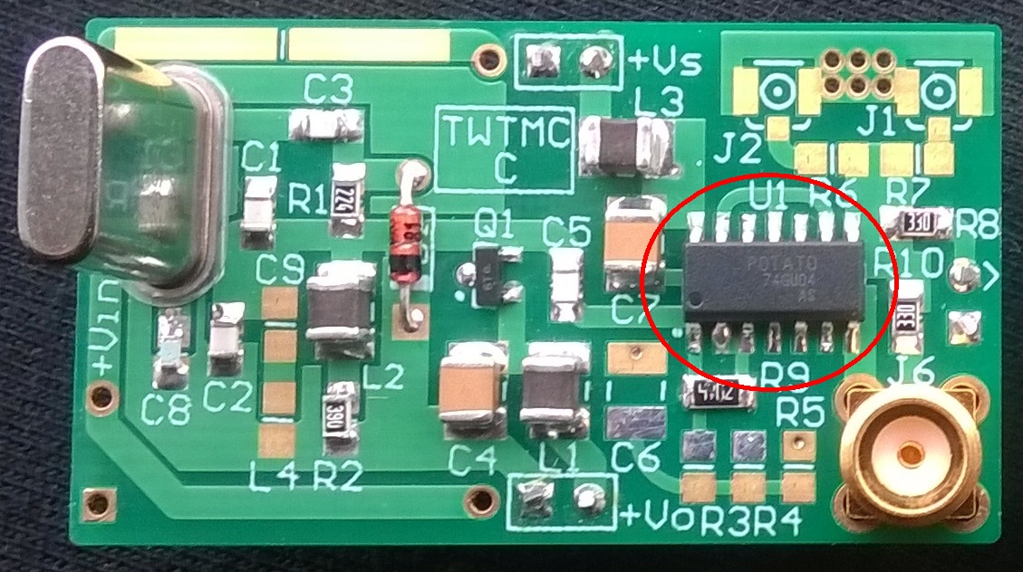

I just saw the picture of the recent TWTMC-C pcb and it features a Potato 74GU04? but maybe it's a triple cascaded inverter.
I have not listened to this oscillators because I have not yet found the time to build it at 22 Mhz. I will do the test in the next weeks, as soon as I will find the time.
I'll be looking forward to this test. I think yu will find this setup (RutgerS + Laptech + 74HCU04) as sonically the best alternative so far, maybe even better than the Driscoll.
