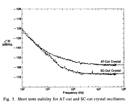

Absolutely correct, theoretically.
But there are more parameters affecting the close-in PN.
What Im saying is that the optimal close-in PN might be easier to achieve with an AT-cut.

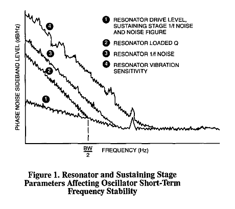

Close-in PN is affected by many parameters.
These can be optimized to achieve a comparable result to the really expensive SC-cut ocxo's (as done in the RutgerS).
cheers

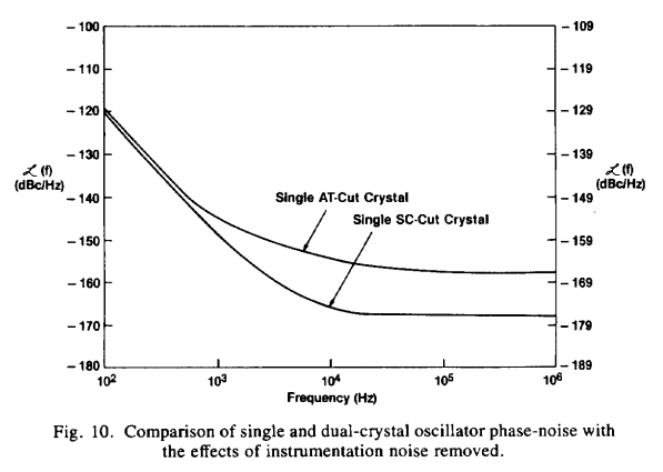

The diagram says all! Close in noise is at ditances from the carrier below ~50 Hz....
Herbert.
What I'm saying is that in theory (for ex Leeson equation) it would be possible to achieve
lower close-in PN figures with SC cut crystals.
That is, any generated noise in the output signal being more
effectively surpressed by the higher Q of the xtal (clearly visible by lower floor for SC) - all other parameters being normalized and equal.
But they might not necessarily be the case in practice.
With good equipment + knowledge + and lots of time, I am positive it is possible to achieve
lower close-in PN with SC-cut xtals, but not by as much as we think.
Herbert.
?? The plots stop at 100 Hz. its not clear what happens below 100 Hz from the plots even though they seem to converge.
