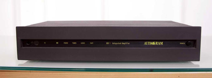

This is not the right thread to talk about THD, but I like to listen to music with this chinese ampli at 1% or more THD. After I replaced the original 845 with a pair of Psvane WE845 it sounds very balanced and smooth.
In the early 90's I designed an integrated amplifier with mosfets. THD was something like 0.00....%, also with limited negative feedback. It got a "Best Buy" from (if I remember correctly) Hi-Fi Choice.
It sounds enough good, but I prefer the DHT chinese amp with much higher THD.
At the end of the listening session with my friend (we designed together the mostet ampli) we did switch to the solid state ampli to repeat the test for a pair of oscillators: the Crystek and the Pierce with the AT-Cut HC-43/U crystal.
We agreed that the results was worse than the tube amp, but the differences between the two oscillators were practically the same, the Pierce detailed and smooth while the Cristek confused and harsh.
Obviously, I look forward to measure the phase noise of all the oscillators to confirm the listening impressions, but at this moment I can't afford an Agilent E5052, so I have to wait until I will access the University Lab to do the measurement. In the meantime I will try to get the suitable stuff to do the JTest.
About ampli and THD, surely Demian can say much more than me.
