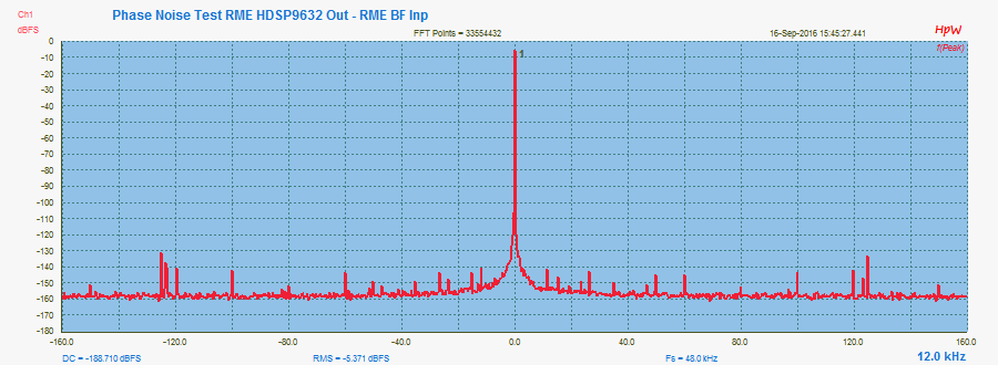

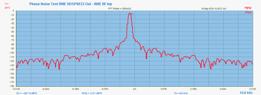

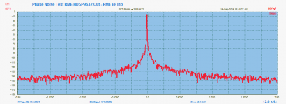

The pointed analysis pushed me to do some similar things as I did with a loop back test using the RME BabyFace using 33 mio FFT .
For the new setup I used the RME HDSP as a DAC source and the RME BabyFace as the ADC using 12kHz Sine signal & 48kHz & 24 bit & 33 mio FFT points to have a Bin resolution of 1.43 milli Herz. The sample time is very long about 12 minutes!
Here the results indicates some symmetric side peaks and the bell closed to 12 kHz with the used 10 Term FFT Window...
Keep in mind that the jitter behavior is a combination of both sound cards...

This is clearly not the spectrum around 24.5 MHz but a tone of unknown frequency
that can be represented with a 44 KHz sample rate, as is displayed in the top right
of the FFT display. probably the output of a DAC.
That also means downsampling / frequency division by 25.4M / 44k = something
around 500.
Division by 10 brings 20 dB, by 1000 brings 60 dB, 500 is 6 dB less or 54 dB gain
by filtering / downsampling. which is probably more reasonable.
There is no spectrum analyzer on the market that could provide > 150 dB dyn.range at
24.5 MHz. And if there was one, its own clock would have to be even much better.
I cannot take that seriously, to formulate it extremely friendly.

First on MSB Phase:
The given FFT minimal bin resolution is fs/FFT size what is about 0.183 Hz. There are some needles what indicate compressed spectrum pins to one pixel. Just drawing somewhere an 1Hz range is bocus.
Second about the MSB measurement idle spectrum noise about -200dB:
May the missed to resale to dBFS using the external amplifiers.
Now as Gerhard mentioned there is some attenuation going on, what could be multiplied back (freq. scale). But requires the required factor what is may implementation dependent PCM or DSD and also oversampling.
One simple test would be to alter the oscillator master freq. by 10ppm and measure the resulting playing signal frequency shift on the used signal as for instance by a signal as fs/4.
