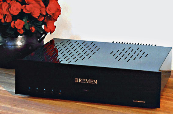

With all that being said, I would like to name a DAC made in the 90's by a smart swedish engineer - using the CS4328 BITSTREAM dac.
Although it required a very good transport (for obvious reasons), its sound quality was nothing short of breathtaking.
Nothing I have heard in my life has been able to induce the same addictive sensation as when I listened to this one, not even the

I used the CS4329 dac chip in my car in the latest 90's, it sounded surprisingly fine, but the TDA1541A is another story.
With its many psu pins, many clock inputs, and not to mention 19 decoupling caps, TDA1541 provides endless tweaking possibilities.
As 1audio correctly pointed out CS4328 was limited to 48 kHz, and featured a fixed OP on the output that could not be by-passed.
Nevertheless, sonically it was a legendary chip - the best Crystal ever did imho (thanx 1audio for the unside info, interesting read).
I talked to Peter (the engineer behind the Bremen Dac) when I was in Stockholm many years ago.
He found the chip the best one on the msrket then.
He was also the engineer behind Forsell Air Reference dac.
The only problem in his dac was that it featured no provisions against jitter.
The whole da was clocked by the extracted MCK from Rx chip.
He mentioned that at the time technology did not offer transparent solutions to reclocking as the best ones sounded similar to no reclocking - at best.
He did something similar to Lampizator to fight jitter:
Took a cdm9 based cd player, massively cleaned up the psus, and upgraded the chips to the fastest ones at the time, and installed a 3000 USD (early 90s!!) Vectron 11.2896 clock as the reference generator.
Needless to say that the combo is still my reference to this date...
