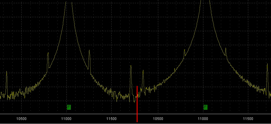

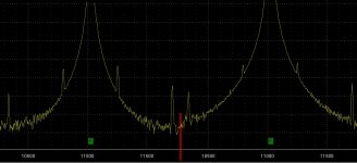

J test
Here's two crystals in a cheap Sony CD-490, side by side.
The J test measurement could be better, but the difference is still clearly visible.
I just made the player crystal connection plug-able and exchanged them.
No name low profile crystal to the left, a KDS one on the right.
The picture shows the bottom spread of the 11kHz jitter test signal.
