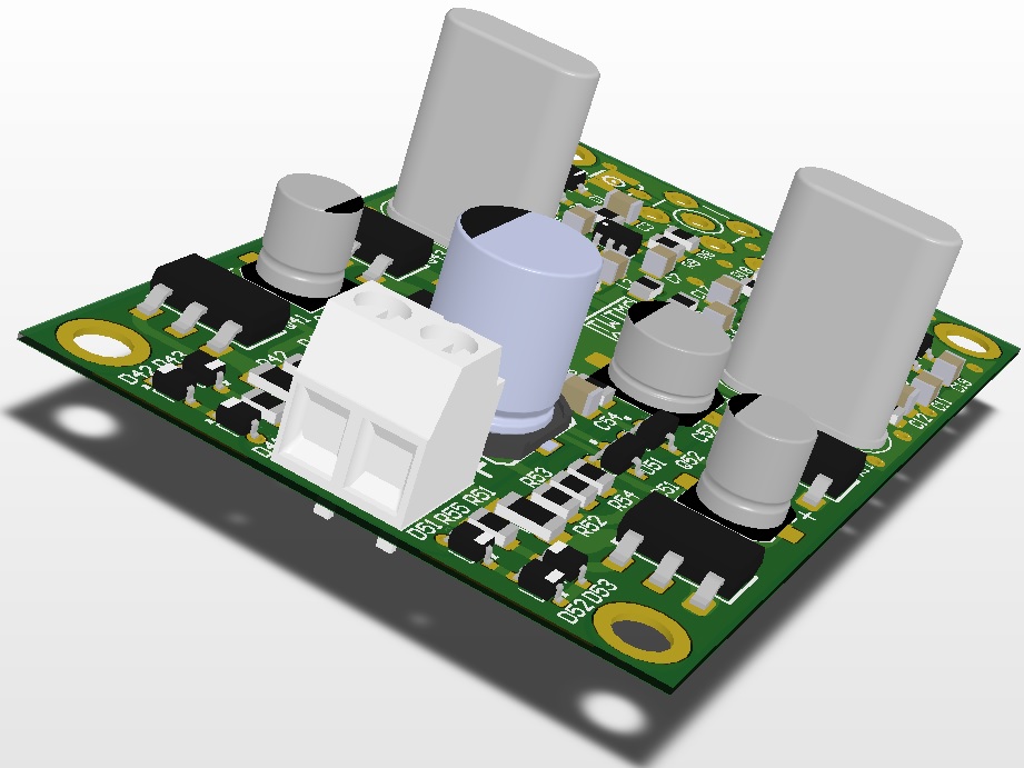

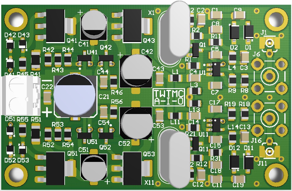

TWTMC All-in-One
I have received many requests to supply finished boards, but as I said several times I have just a little free time, so I cannot find the time to do the manual assembly of the boards.
The only chance is to design a standardized board with standardized parts in order to get a competitive price for external automated assembly.
If there will be enough interest, at least 100 boards, I could supply a finished board at a budget price, not much more then a pair of Crystek CCHD-957. I believe the price could be around EUR 60.
The board includes a dual Driscoll oscillator at 22/24 MHz. These are the only frequencies provided. It use a little cheaper but good enough crystals in HC-49/U package instead of HC-43/U. There are two shunt regulators on board to feed both oscillators and squarers. Output is fixed at 3V3. So one needs only unregulated or pre-regulated 10 to 12 VDC.
As soon as I will start the new GB I'll provide the final price to see if there is enough interest to launch a batch of 100 pcs.

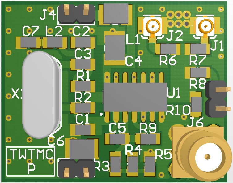

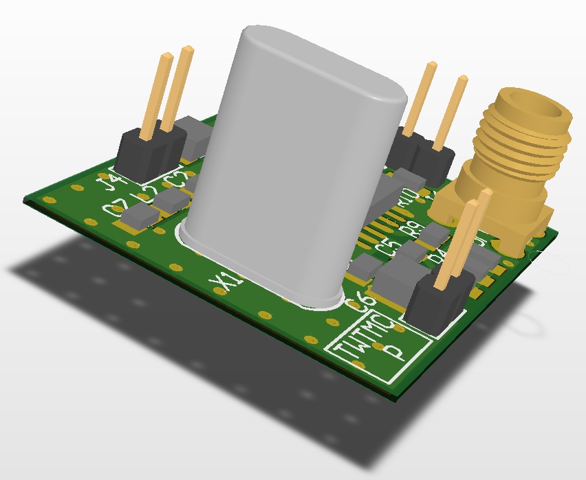

Coming soon...
Next step: the picogate Pierce oscillator TWTMC-P....
... after vacation.
