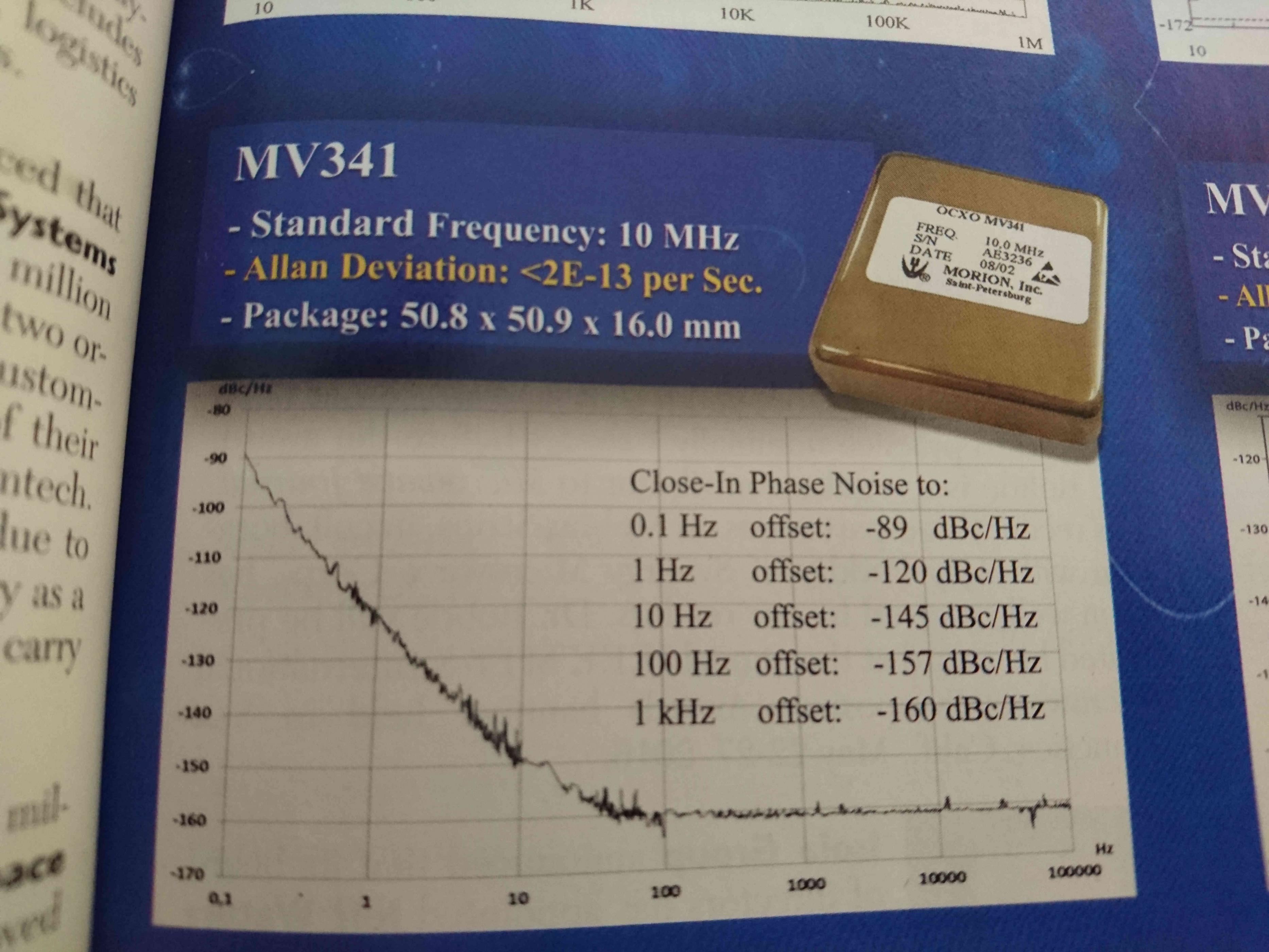

For a reality check, the attachment is one oscillator my customers use. Not exactly cheap, but mass production.
However, I will place my bet on the Driscoll as number 1, with the Pierce coming to a very close second.

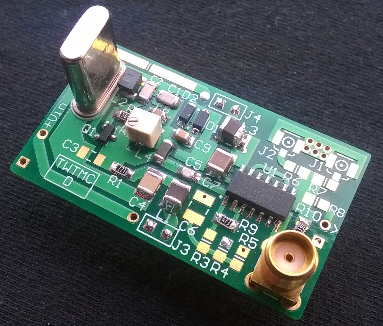

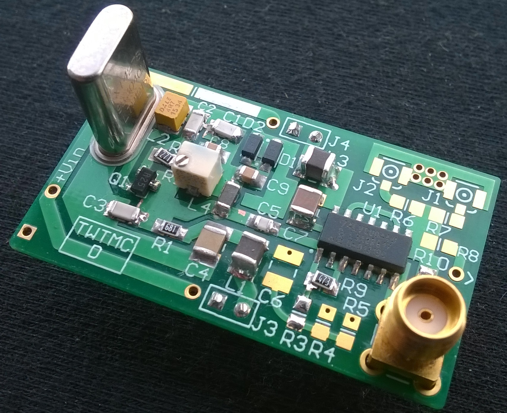

Yes, the squarer is the same of the TWTMC-C Clapp oscillator.
This is the Driscoll with AT-Cut crystal at 98.304 MHz.

Its very hard to beat the performance of a Wenzel. My reference is an Arbiter GPSDO that has a big 5 MHz Wenzel internally. I figure improving on it would be a very low return on effort task.
The Morion's are very good values. I'm surprised no one has ordered up a batch of audio frequency oscillators from them and made them available to the audionut marketplace. Of course dealing with Russia brings some hurdles.
