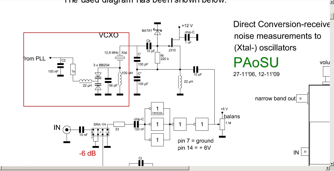

These are all great, but specifically regarding the DC-receiver with an interest in measuring phase noise in my home workshop, if I am reading this correctly: can I build two of the same oscillator circuit and use these to measure the phase noise with respect to eachother? That's to say: this can be done without a 'known good' oscillator? I need to bootstrap the measuring device.
You absolutely can measure the phase noise if you have two. However for the close in stuff you need to phase lock the "reference" to the test oscillator. This will move the carrier to DC. At 90 degrees an balanced mixer will be the most sensitive. (Herberts oscillator won't lend itself since it has no active frequency trim). The actual noise of the oscillator would be -3 dB from the measured noise presuming they are essentially identical.
The other option is called the three corner hat. Take a third oscillator and measure the noise of each pairing. This allow you to derive a noise number for each oscillator by subtracting the numbers each pairing.
The third option is uses correlation with three oscillators and comparing two pairings, and removing the noise that not common to the two pairings. Need specific software. I think Hpworks can do this. (and two good balanced mixers and some other stuff).
.... (Herberts oscillator won't lend itself since it has no active frequency trim). ....
I am not sure....I think you can use this feature (the PLL input) in Herberts Reciever to lock-in.

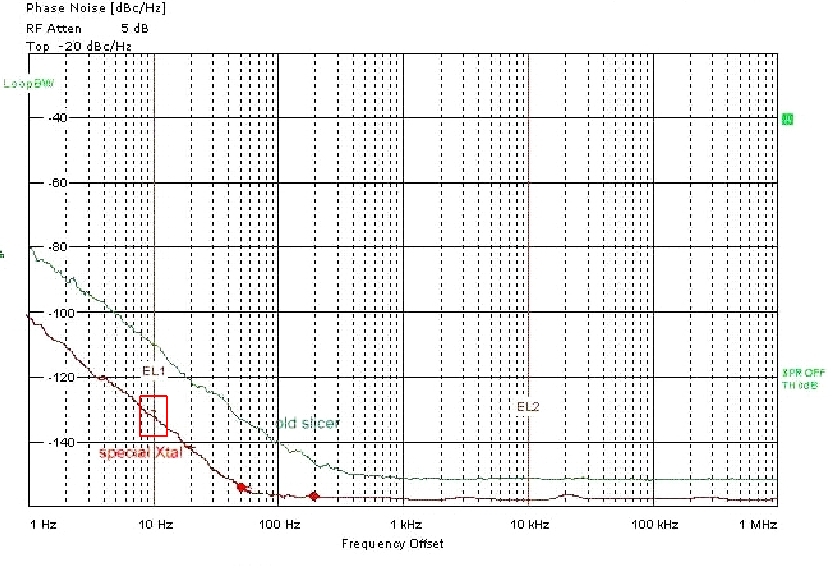

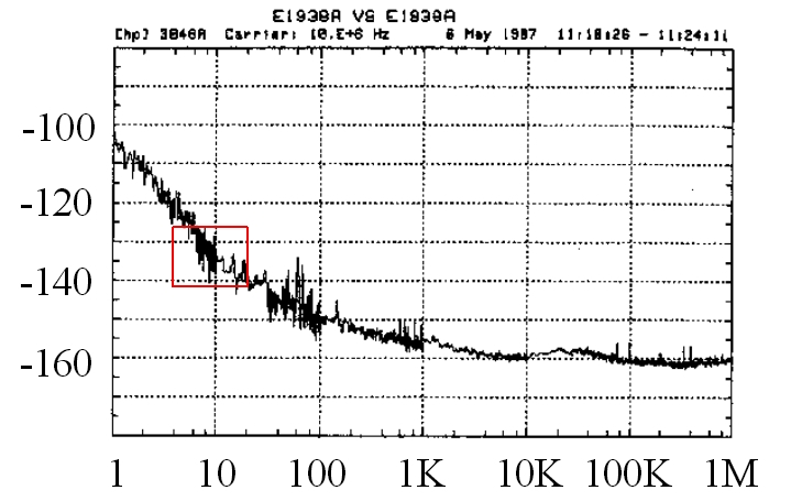

Phase Noise Measurements
Guys guys guys ...
Depending on what equipment you use, you'll get slightly different PN measurements.
I have attached PN measurements on HP's all time reference oscillator HP10811, and HP's BEST oscillator EVER made HPE1938A.
Please look at the attached graphs and read the PN data, at 10 Hz offset from the carrier:
HPE1938A......... appr -135 (dB)
HP10811........... appr -121 (dB)
RutgerS............ appr -132 (dB)
If you have a cravin for low PN figures @ close offset from the carrier big time - then look no further
than this one right here.
RutgerS performs almost as good as HPE1938A ! ! (at close offset from carrier). I find this absolutely astonishing.
I know many radio-enthusiasts build their own recievers to measure SSB PN, but the oscillators they
work with are most often LC-based oscillators.
Xtal-based oscillators - specially the good ones - like the Laptech - would seriously challenge the
performance of many hyper-expensive PN measurement equipment.
Guys... Measuring PN - at these low levels we're talkin about here, is really not a trivial
task....specially interpreting the gathered data...
cheers

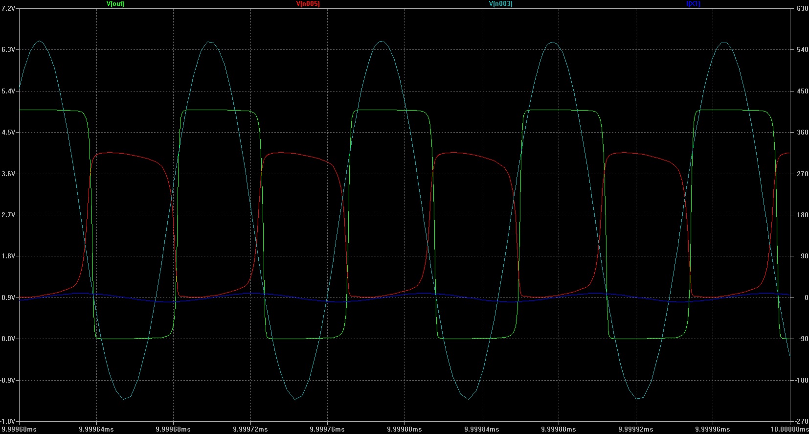

The attached picture shows the simulation of the Pierce oscillator at 11.2896 MHz using a pair of unbuffered '04. The first is used as the active device for the oscillator, the second as the squarer.
The circuit was simulated at 5V with the spice model of the 74HCU04, but could be used also at 3V3, with the 74LVCU04 or the Potato logic unbuffered inverter.
Green plot is the output of the squarer, red plot is the output of the oscillator, light blue plot is the input of the first gate, blue plot is the current flows in the crystal. The crystal dissipates around 350uW. The drive level can be decreased simply changing the value of a resistor.
The crystal load is around 17pF, as for the Laptech specs (16.5pF).

Very nice results Andrea.
These are exactly what that can be seen on an oscilloscope in a real circuit.
Keep up the good work, Gentlemen
