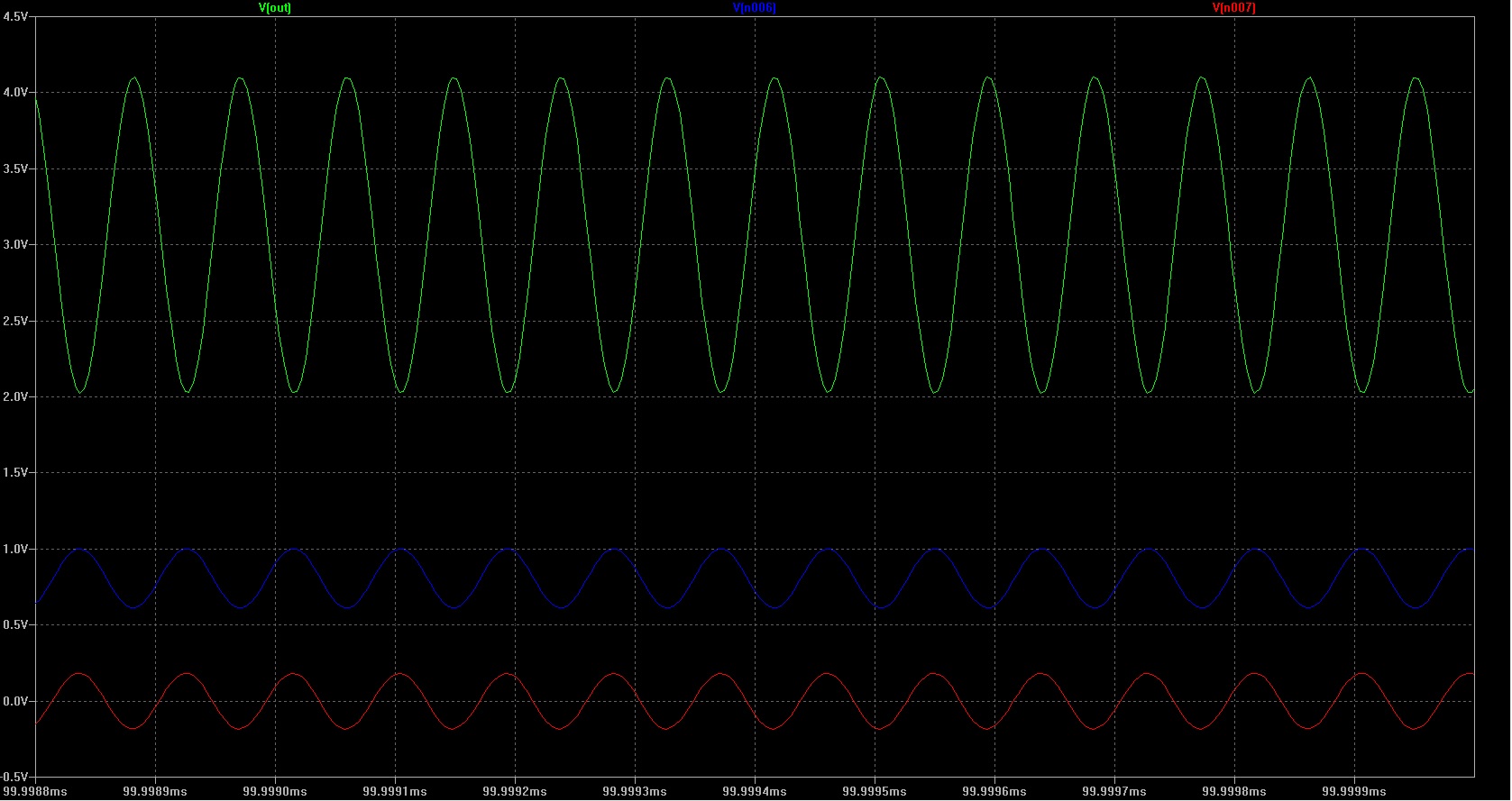

The Driscoll oscillator was built and measured (using a Nofech SC-Cut crystal), see page 103.
Waiting for the crystals, the following plot is the simulation of the Driscoll oscillator with the Laptech SC-Cut at 11.2896 MHz.
Green curve is the output from the collector of the bjt, the red curve is the voltage at the base of the bjt, the blue curve is the voltage across the crystal.
The loaded Q of the circuit should be better than 90% of the crystal Q, at least 720k with the Laptech crystal specified at a Q > 800k (usually the real crystals are better than the specs).
Emitter impedance is around 12 ohm, crystal ESR is around 110 ohm, that gives 90.2% of loaded Q.
The current in the crystal is around 0.85 mA, that gives a drive level around 79uW.

One more time I have to punctualize the spirit of this thread.
As I stated in the first post, the first line, "I did start this thread to investigate the opportunity for a diyer to build a real low jitter oscillator".
This is not a commercial project. I'm doing this for the community, I have no commercial interest. The first batch I lost money.
In my honest opinion, this just means "diy audio".
Otherwise, there are tons of clock devices one can buy on the market (Crystek, Tentlabs, NDK, Pulsar, and so on).
Herbert's clock is just the TWTMC-C oscillator board. I have arranged the group buy from Laptech to get suitable crystals, that usually one cannot find on the shelf. The Laptech's crystals specs are known, I have published the measurement of each crystal of the first batch provided from Laptech. IMHO, they are very good AT-Cut crystals (high Q, cold welded package, polish finish).
Then, there was enough interest to get SC-Cut crystals, that usually have superior specs (higher Q). Again, I have arranged the group buy from Laptech, spending a lot of my little free time. Maybe I will loose money again.
The Clapp oscillator cannot work with SC-Cut crystals, since they have much higher ESR. So the jfet has not enough transconductance to overcome the losses due to the crystal resistance. Moreover, for the same reason, the Clapp oscillator does not work with 90/98 MHz 5th overtone AT-Cut crystals, just because they have around 40 ohm ESR.
The Driscoll oscillator seems to be more suitable for high ESR crystals, such SC-Cut type or 5th overtone AT-Cut type. In the first post I mentioned 3 oscillator circuits to investigate: the Clapp, the Driscoll and the Butler two emitters.
Now is the time of the Driscoll. I have already tested this oscillator with 90/98 MHz overtone Crystals, it starts correctly at the right frequency.
As soon as the SC-Cut crystals will arrive, I will test them with the Driscoll oscillator. If one would use them at high constant temp (82°C) the oven board is ready.
As I said several times I don't own the suitable gear to measure the phase noise. I can't afford a 100000 USD phase noise measurement system such as the Agilent E5052. This is an hobby for me, and I'm pleased to share my experience with diy audio community.
I have limited access to the above gear in a university lab. As I said in the first post, as soon as the 3 oscillators are ready, I will go to the lab to measure the phase noise.
Sincerely, I cannot do more than this.
