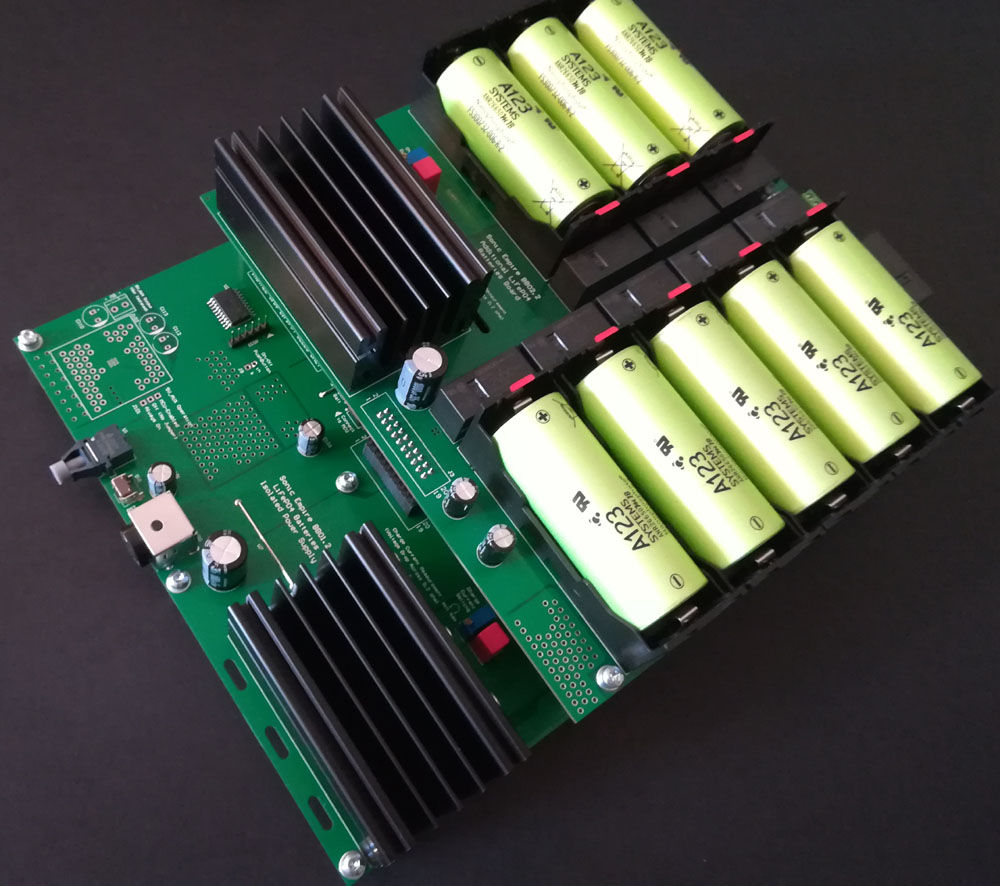

TWRPS-LBS-M LiFePo4 batteries power supply main board
Output rails:
- 3V3 to 16V5, typically for oscillators
- 2 x 3V3 to 6V6, typically for DAC
- 3V3, auxiliary devices (for example the clock section of the FIFO)
5V/500 mA linear regulator to supply other devices like USB to I2S and so on
Remote power off
No switching devices or active oscillators during listening
No RF at all (no mulltiplexed display and microcontroller in stad-by mode)
Board size: 260mm x 195mm
Board options: finished and semi-finished
Note: without batteries and battery holders

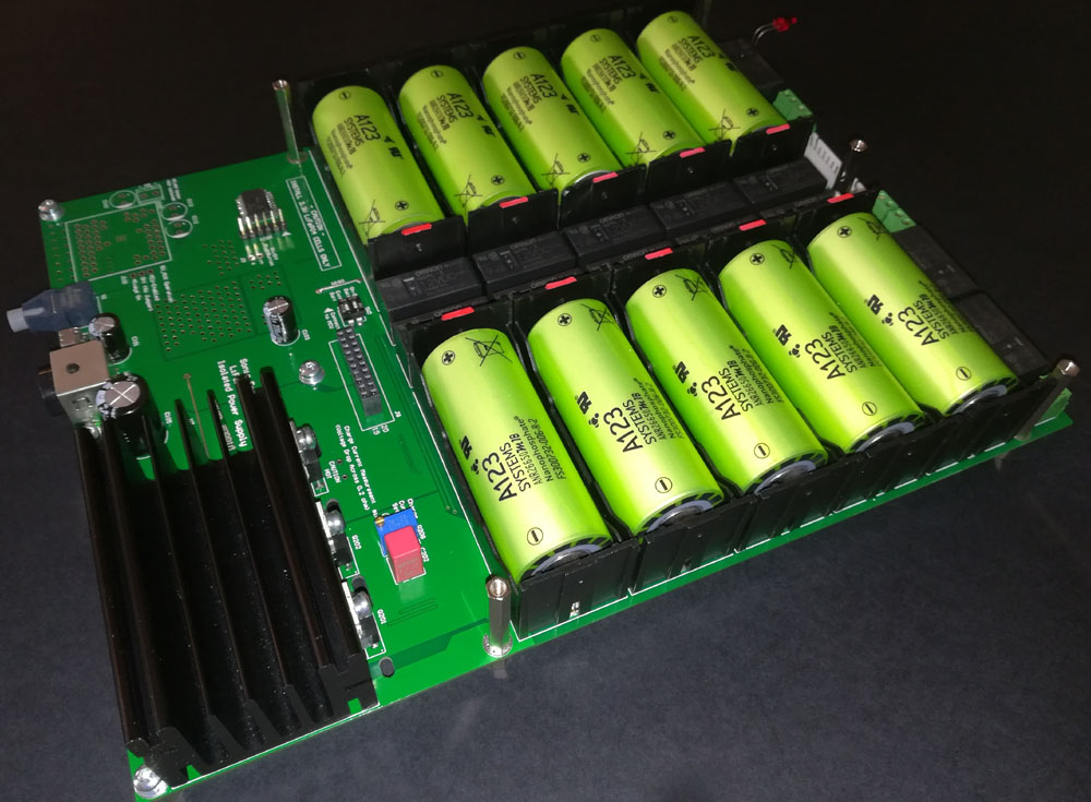

TWRPS-LBS-D LiFePo4 batteries power supply daughter board
Output rails:
- 2 x 3V3 to 13V2, typically for DAC output stage
Fit the main board with a single connector
Controlled by the main board
Board size: 184mm x 195mm
Note: without batteries, battery holders and connectors to stack onto the main board

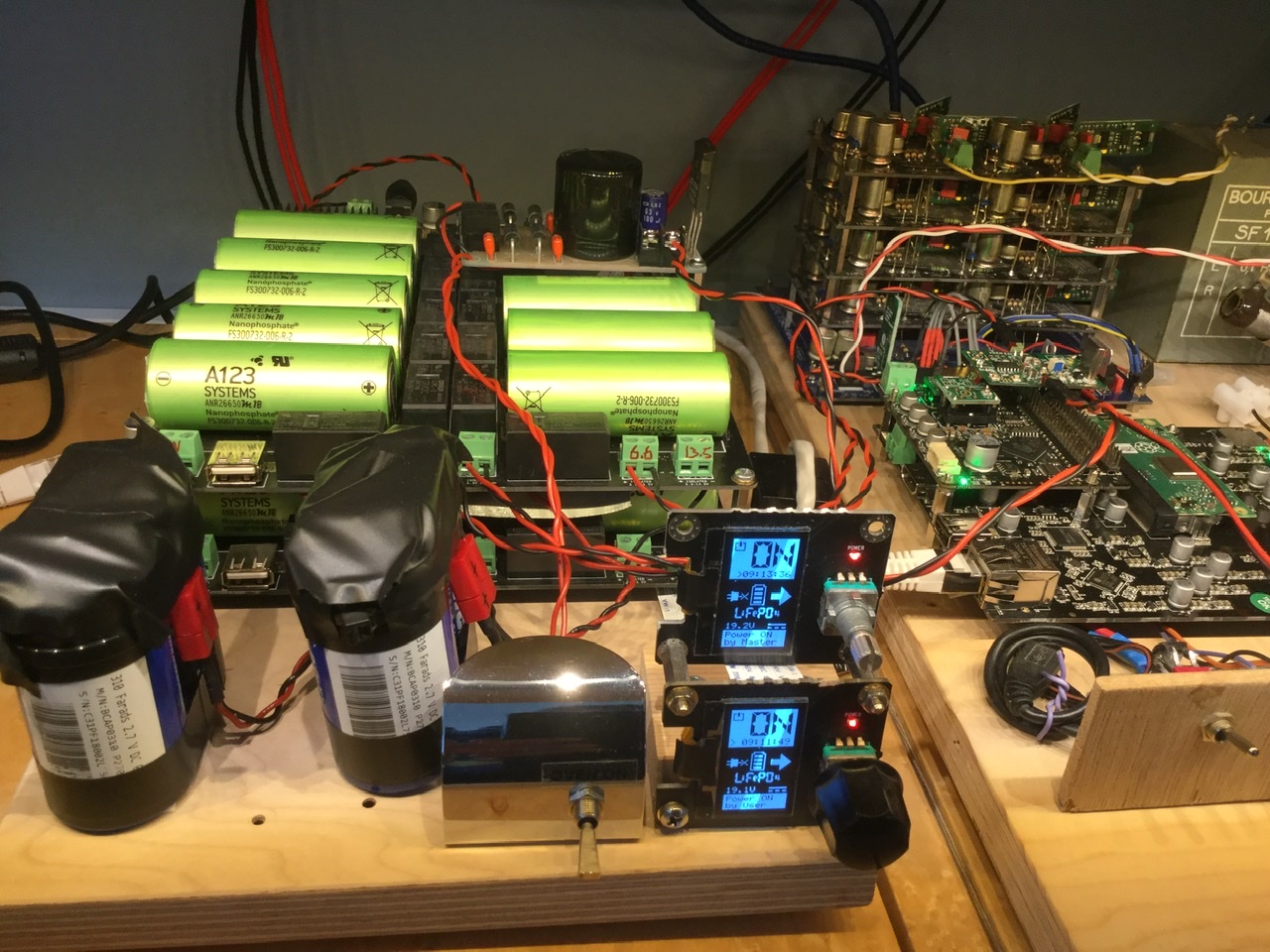

Hi Andrea,
I have been using a lifepo4 battery supply powering your previous clock unit and the fifopi. After I added supercaps in parallel to the batteries I could hear the noise floor dropping very clearly. I think the noise comes from the chemical battery process.
So I would surely advise using supercaps in the power supply of your new clock units, otherwise the benefits of the new design against your previous driscoll design will deminish in the higher noise floor.
Is your battery supply an always on system? I remember you wrote somewhere that it would be best to keep the clocks always on and switch from mains power to battery when listening to music. Is this the way your battery supply is now working?
Yes, during the listening the oscillators are powered by batteries, while when the system is off they are powered by a linear regulator placed in the PSU of the LiFePo4 battery supply system (TWRPS-LBS-P), so the oscillators are never switched off.
