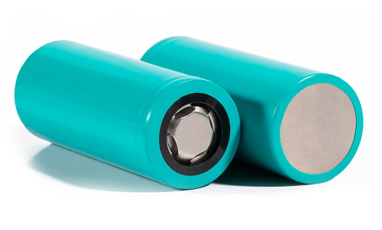

I am finding LiFePo4 batteries not the best sounding sources in the analog section. It would be great to be able to stick any other elements in there: for example, Lithium-titanate (2.5V) or ultracapacitors (2.7, 3, 3.3V). As far as I understand, this is only a matter of firmware of the power controller. Am I wrong?
We are upgrading the firmware in order to support Lithium Titanate batteries.
The daughter board TWRPS-LBS-D will accept 26650 or 18650 LTO batteries.
There will be a jumper to select the proper configuration according to the installed batteries (LiFePo4 or LTO).
The result will be a mixed setup with LiFePo4 batteries on the main board (for oscillators and digital devices) and LTO batteries on the daughter board (analog devices like the DAC reference).
I have just ordered a few LTO battery samples.

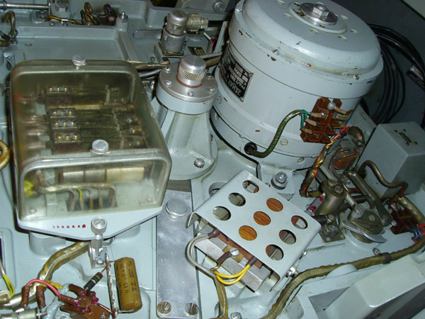

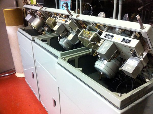

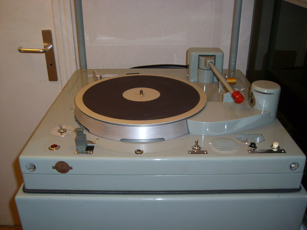

Hello,
I am happy to see Supersurfer is still using my old Bourdereau.
Take a look at their turntables.
Greetings, Eduard
P.s recently Doede the DDDAC designer also has done some test with supercaps. In the eighties the French used dry lead batteries, combined with normal BIG caps and NEC supercaps ( just new on the market then)
They said they needed the caps for noise from the batteries.
So it could be like Supersurfer said a mix of lifepo4 and supercaps can be beneficial.
IF the Italian boards will allow gradually charfing at start up like the Canadian board t6hat would be perfect.

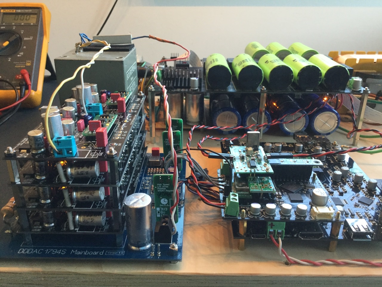

Ultracapacitors make the chemical battery noise disappear
Hi Andrea,
I have experimented a lot with ultracapacitors, from 5F up to 3000F in size. It is not the capacity that has a positive influence on the power supply, it is the accompanying very low ESR.
5F esr=35mohm
325F esr=1,7mohm
3000F esr=0,29mohm
0,1uf Ceramic esr=100mohm
Using the 325F does deliver a clearly audible lower noise floor when used in parallel to the battery power supply when it is feeding a fifopi and your clock units (while the rest of the streamer and dac use wall power.
So my analysis is that it certainly lowers the already low battery power noise.
I reccomended you to experiment with these caps!

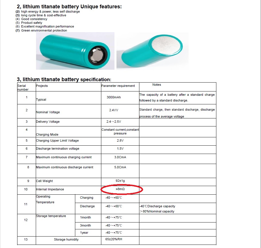

Hi Stephan,
maybe we will give a try in the future, now we are busy (GB aside) with the development of the FIFOs and the DACs.
However LTO batteries has very low ESR as you can see in the attached sheet.
