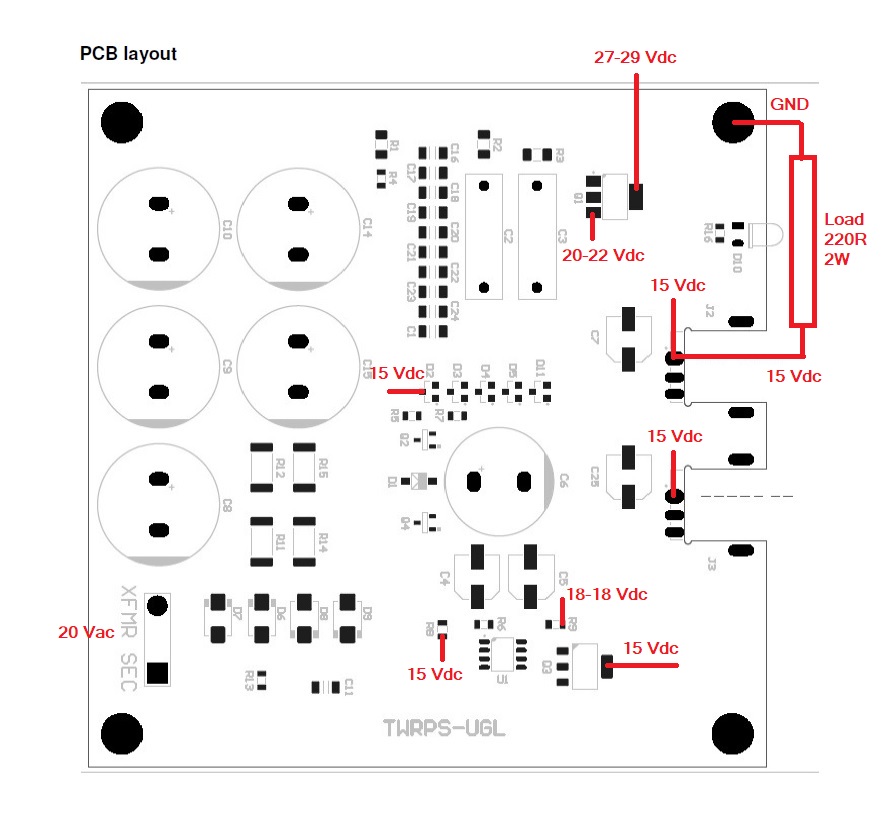

I was able to power up the twrps-ugl using the specified transformer and im getting output of about 26vdc.. measured secondary of the power trans and it read 24vac.. measured my wall outlet and it was at 125vac.. im going to power the drixo clocks with this.. is 26vdc too high?
Can i use the center tap of 12v for the twrps-ugl? The manual states input of 18-20vac.
Very strange because I have tested all the finished boards before shipping and they did work correctly.
I attach a picture with some test points to check if the regulator works.
Please use a load at the output of the regulator, such 220R 2W or similar.
