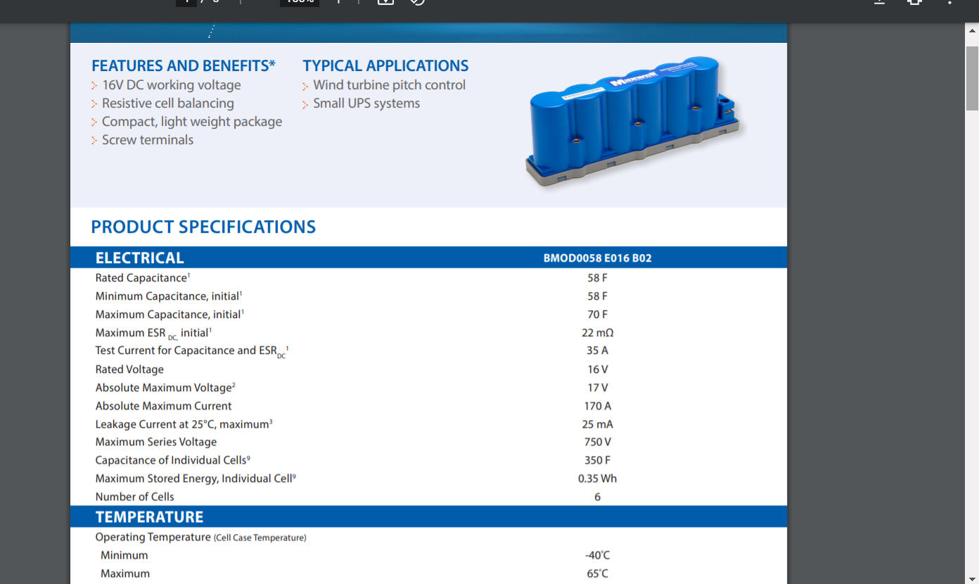

From the blog of Doede ( the DDDAC priest) there is some info to be found about the use of supercaps.
I also got some info from him by private mail that he will share later after doing more test.
You can read in this thread two ideas why the supercaps perform so well.
One is the low ESR.
The other is related to the idea the French had when they first used the 5 volt supercap designed by NEC in the eighties. Back THEN they wrote the supercaps cannot replace the standard caps because their esr was just to high. THEN they were just use because they had one F in such a small package. Not sure if this is the 100% right explanation but it was not used as a bucket of energy but more like an elements that would stabilize the voltage.
Doede told me he took measurements and what surprised him was the low impedance figures all the way down to lower frequencies ( much better than usual caps) and because this will result in a much better filtering of lower frequency noise.
Andrea explained his ideas about local decoupling being the key element in some of his circuits. It seems that finding a configuration , with maybe one extra circuit costing less than 100 euro is easier than having a broad collection of circuit that all need a lot of attention to work perfectly.
It seems both Roon nucleus and etherregen need a state of the art supply too.
The 16 volt package could work well for the Roon BUT you will have to decide where you have the space to use big solution like this.
Greetings, eduard

You mentioned supercaps are no good as the oscillator supply, I assume you meant in the usual way - like a capacitor in front of an active supply, not like a battery.
I would have thought supercaps electrical performance would be better than batteries in some ways (noise probably being the primary one) and still like the idea of trying to use them as a battery-like power source.
Of course the application has to be able to tolerate some droop over time in the supply for super caps to be used like a battery. The more it can tolerate, the better.
One idea that was discussed by another member in the past:
You have 2 banks of supercaps, 1 charging while the other powers, which are switched when voltage falls to a certain threshold.
For a suitable application the switching frequency would probably be at least a few minutes with those 300F monster caps, too low to effect musical enjoyment.
The only obstacle is designing a soft-switching circuit that also fully isolated the charging circuit.
Alternatively, you can simply have a single super cap bank that after the initial full charge is regularly switched into the charging circuit for a top up once a voltage threshold is reached.
For supercaps an ultra fast charger could be used to keep this top up cycle very short.
Unlike batteries the charging circuit is quite simple/flexible, any good quality good linear supply could be used to keep charger influence to minimum.
The lighter the load, the lower the ratio of charge time to powering time.
The inconsistent nature of this kind of this supply will probably bother some (it bothers me) but it is a very simple to do.
I have tested this kind before with just a manual switch for the charger and smaller 30F super caps on a simple SE headphone amp and the sound quality of purely supercap power was promising.
Aside from performance I much prefer the perpetual nature of these kinds of supplies.
Having battery based supply run out and cut a listening session short or require you to wait to begin is much more frustrating to me. The need to plan ahead is added stress.

I didn't mean supercaps weren't suitable, I meant that theoretically they are waste of money to supply oscillators and frequency doublers since they are a constant load.
As I said we have measured the phase noise of the oscillators powered by batteries and linear regulators and practically there is no difference.
This means that no noise comes from the power supply, or at least we are not able to measure any noise with our tool.
The advantage of the batteries is that they are decoupled from the main AC so the oscillators are less prone to pick up external interferences.
BTW, if someone will give it a try I'm curious to know if there are audible difference.
